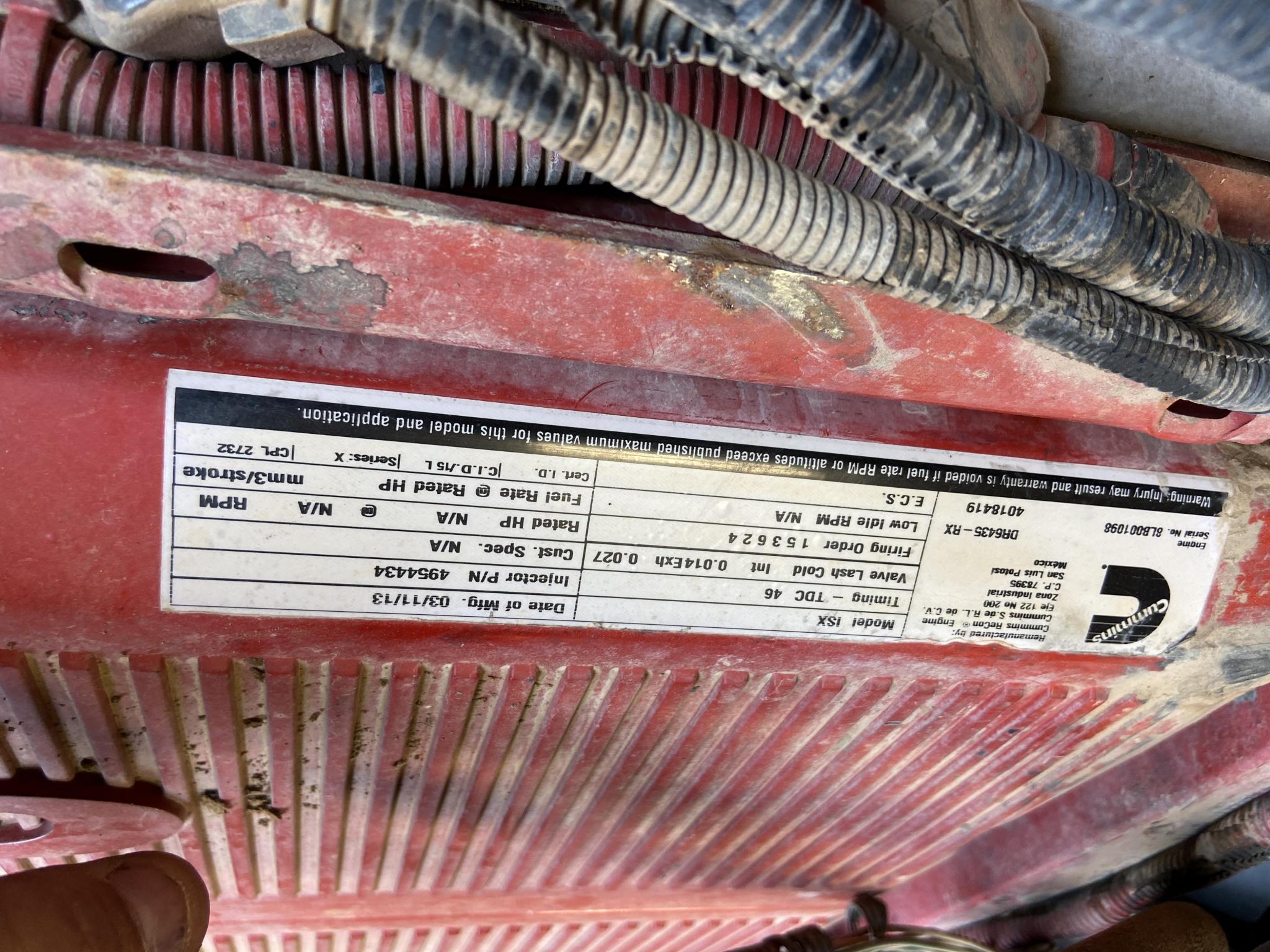

RE: Cm871 hammering, poor thing Well light scoring seems to be the norm. I think all my rollers and lobes have a line or two in them. And they've had them for a few hundred thousand miles. | |||
10-24-2020, (Subject: Cm871 hammering, poor thing ) Post: #14 | |||
RE: Cm871 hammering, poor thing If it can't be felt with a fingernail it should be good | |||

RE: Cm871 hammering, poor thing UPDATE. Sorry it’s been awhile guys. We have it fixed. The dampener fixed 100% of the rattle and hammering issues. Truck is SO much smoother. Mr Price from PA that Rawze recommended did my tuning. Like a new truck, thanks for everyone’s help! | |||
