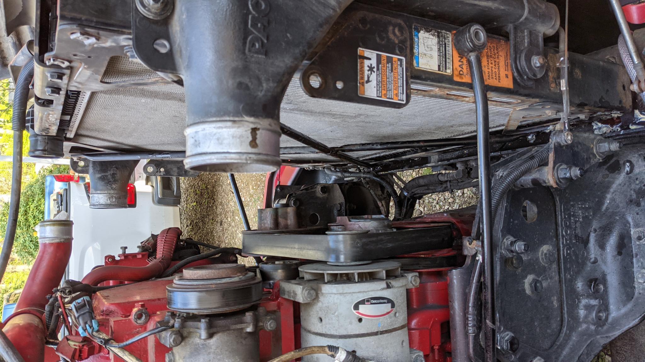

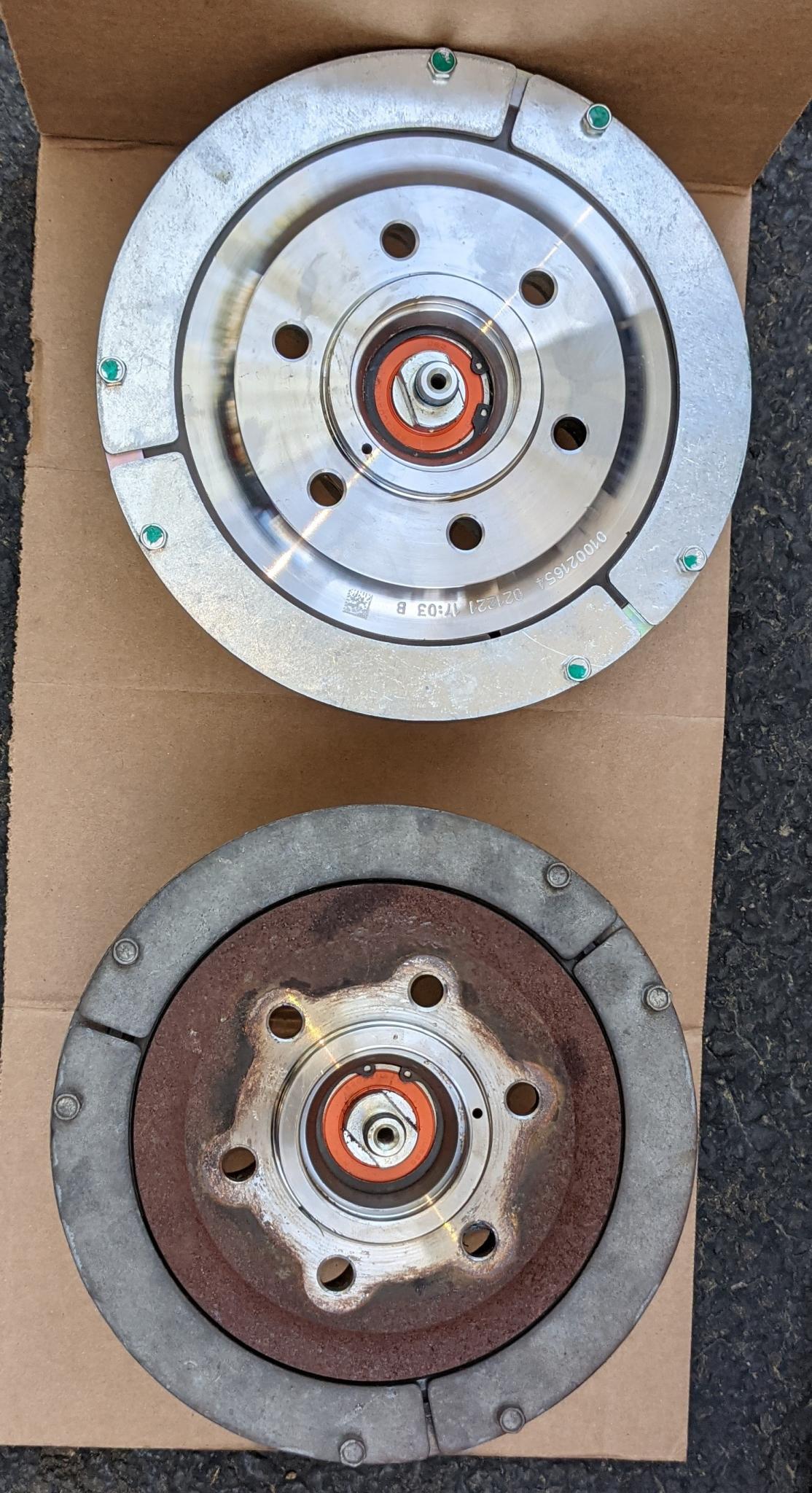

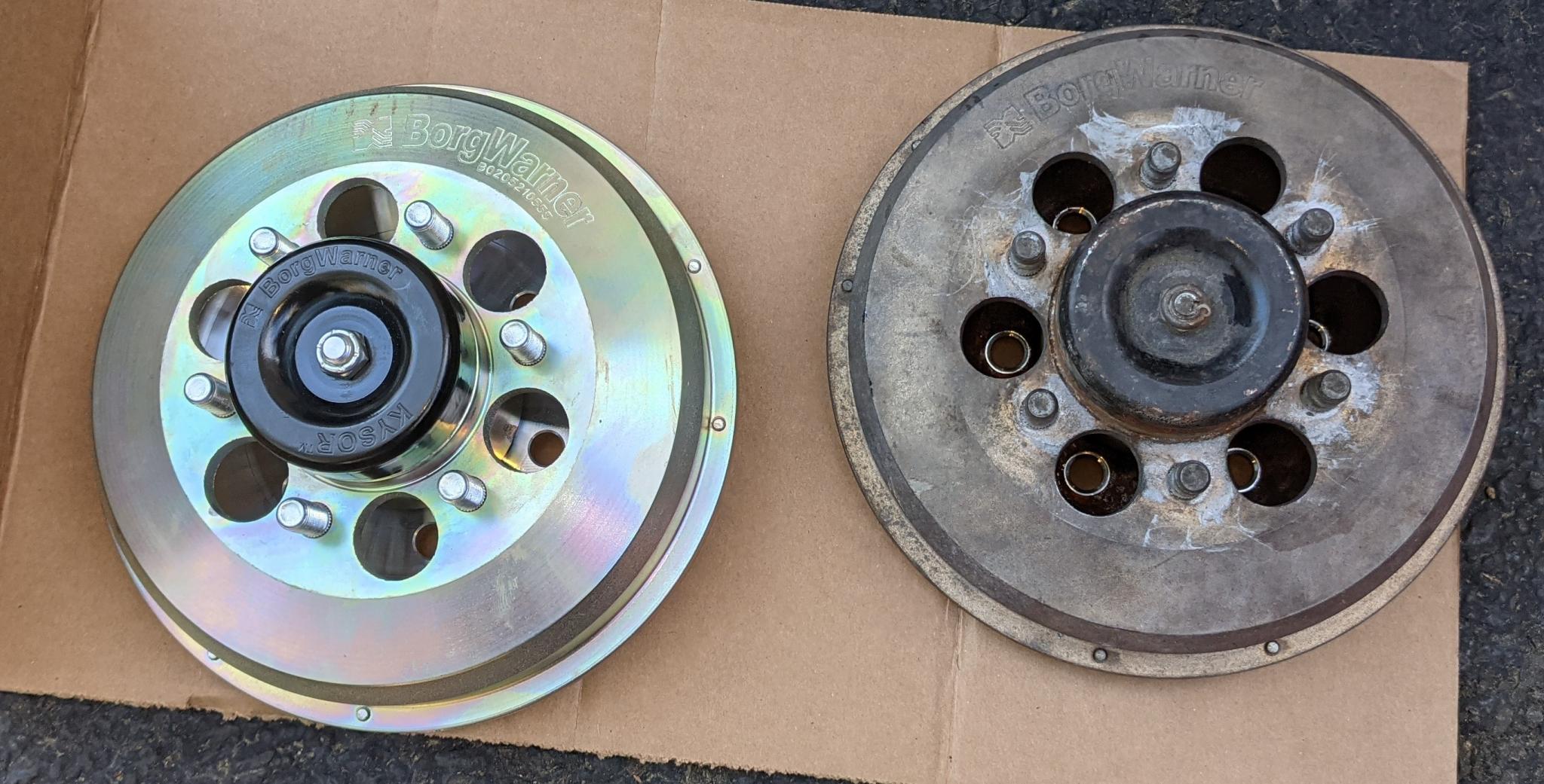

| RE: Fan Clutch So I thought I'd have to replace the entire assembly based on the pictures I pulled up. Turns out the part they gave me is just the new clutch (and bolts with blue loctite), so the pulley and mount will not need to be removed from the engine. Much lighter that way. So the question is moot. Will remove fan then clutch and replace with new parts. Might not even need to remove anything radiator-wise except for the hose on the very top (and the CAC hoses). Hoses to the A/C condenser appear to have enough slack top and bottom that I can lean the rad forward enough to do the job. Was gonna replace the solenoid too but turns out that part is back ordered and no one has any. No biggie, it's working fine and is easily located on the firewall if I need to do it in the future. Right now the fan will freely spin even with no air going to it, with only a slight drag. Glad I didn't ignore it, getting too hot out to be without a fully working fan. Now just need to wait for the 40-50mph winds to die down before I work near that open hood. Probably take the entire week off to tackle other odds and ends that I've been putting off. Guess I'll miss Road Check again this year. Darn User's Signature: "...And as we wind on down the road, Our Shadows taller than our Soul..." | |||

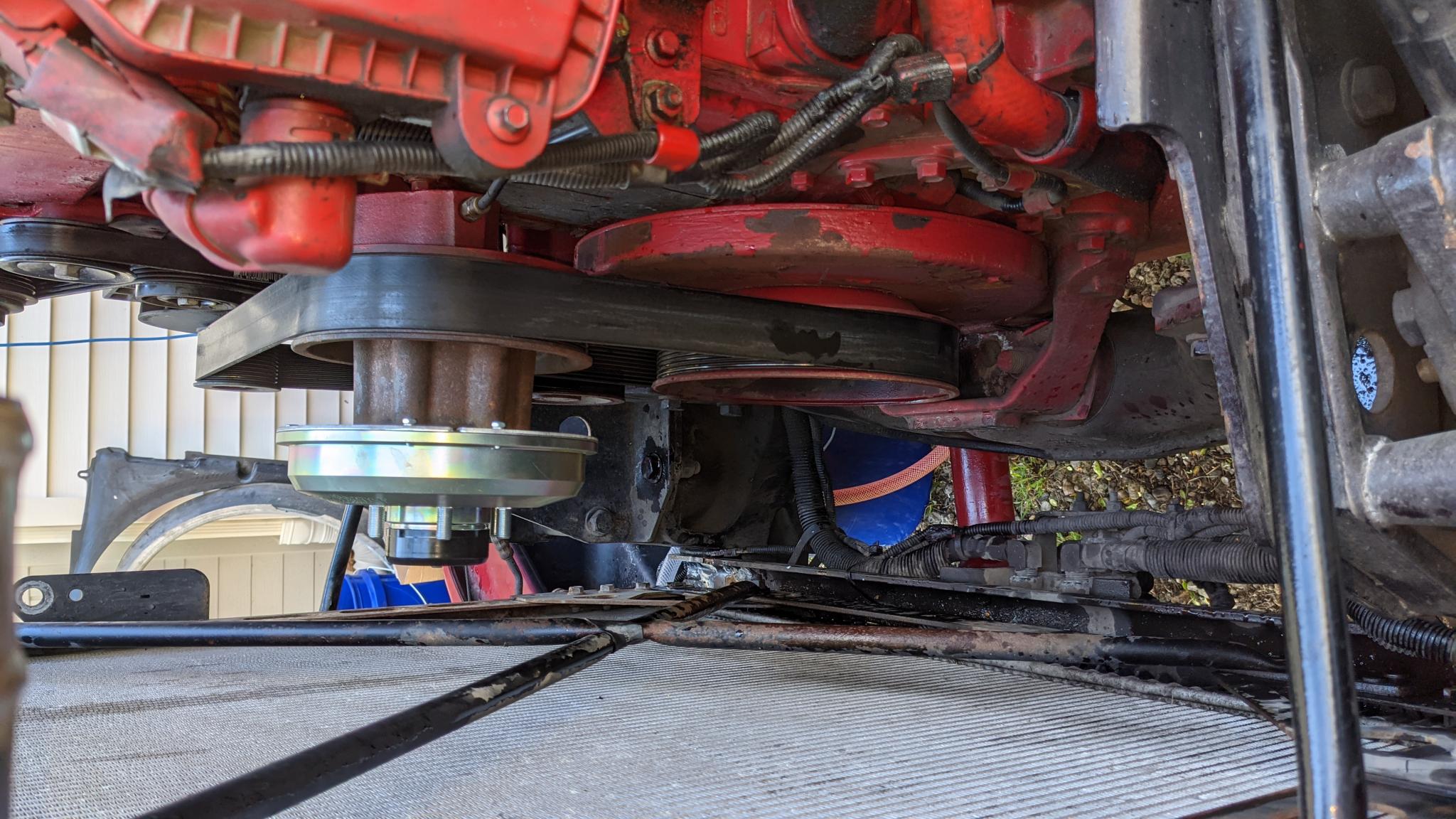

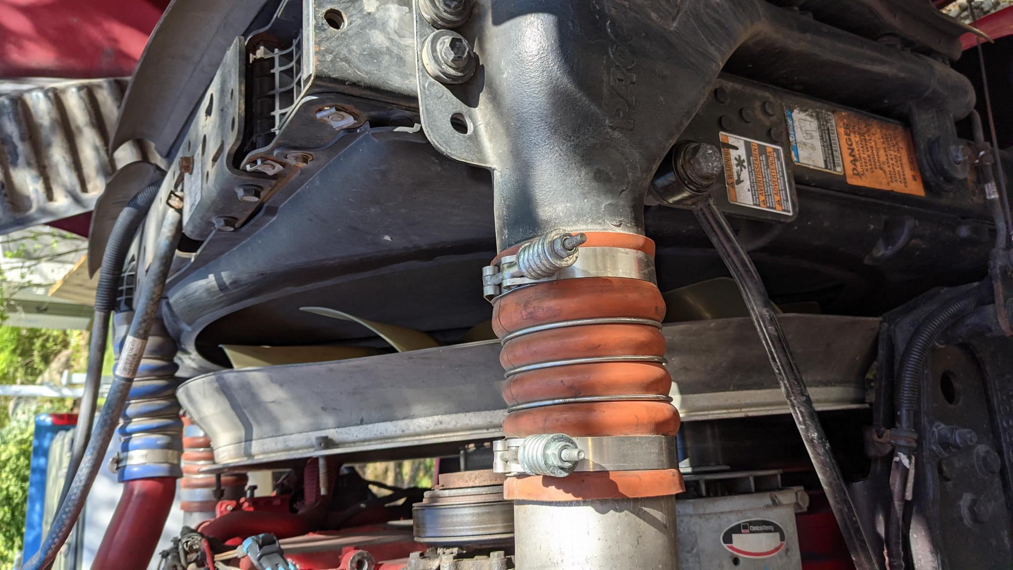

| RE: Fan Clutch All done. Overall pretty easy. Worst part was getting the fan shroud off. A few of those bolts were really hard to get to. If only my arms bent in 2 or 3 more places... So I drained a few gallons of coolant, disconnected the radiator hoses and CAC hoses. Didn't need to touch the AC at all. Also didn't need to loosen the lower radiator bolts as the rubber bushings allowed for enough movement. Once I got the fan out I removed the shroud. The renegade that I am, I didn't use any cardboard over the radiator. Wasn't an issue, with everything out there was plenty of room to work. Never came in contact with it. User's Signature: "...And as we wind on down the road, Our Shadows taller than our Soul..." | |||

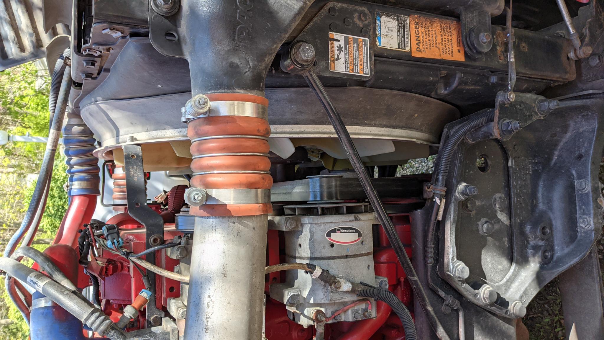

| RE: Fan Clutch More pictures User's Signature: "...And as we wind on down the road, Our Shadows taller than our Soul..." | |||

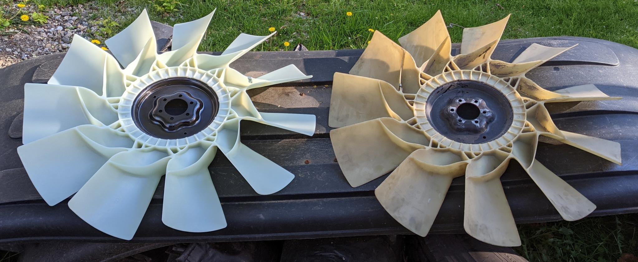

| RE: Fan Clutch I like the fact that new fan blades come pre balanced. That metal piece that's clipped on the one blade is I believe the balance weight. Both my 06 international and my 2010 kw blades came upgraded design and balanced for I think $125 from OEM. For the price and peace of mind it was well worth replacing on both trucks after being 10+ years old. | |||
