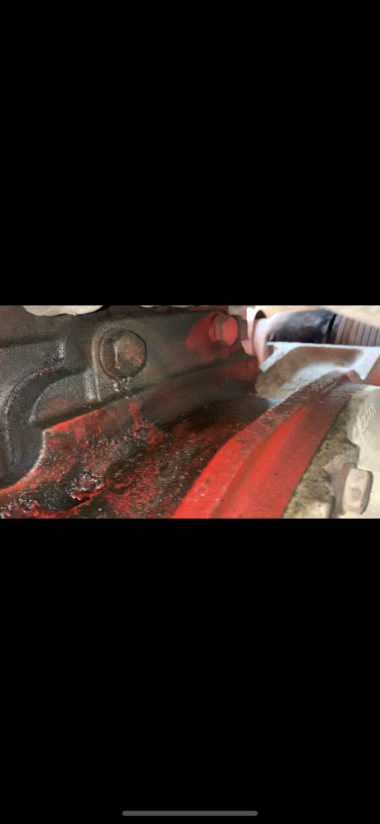

| RE: Oil leak on backside of motor The dipstick and fuel actuator wiring are not secure because someone has removed the bracket from the IFSM. Some people do this to improve access to the fuel filter. | |||

| RE: Oil leak on backside of motor The bolt on the left was loose enough to turn by hand. | |||

| RE: Oil leak on backside of motor You may get lucky and it seals up or at very least slows the leak down. But the thin rubber on the metal gasket my also be brittle at this point from exposure to heat and movement from that bolt being loose. What I would absolutely be terrified of is that the other bolts behind the flywheel have shaken loose too. It would be best to find a very logical explanation of how that bolt got loose. Is the other 1 loose too? Was there brackets on them that someone may have taken off at some point and they never retightened the bolt? Look for scarring in the paint to maybe justify this explanation. If not, I would seriously be worried if all those other flywheel housing bolts are loose too. you run the risk of completely loosing all your oil in the engine very rapidly and very randomly if the gasket and the rear main seal fail do to movement of the rear structure. Maybe the ISX gods will speak up and say my concern is invalid because those bolts do happen to shake loose every now and again but I'm not holding my breath on that one. | |||

RE: Oil leak on backside of motor (09-21-2021 )Chamberpains Wrote: You may get lucky and it seals up or at very least slows the leak down. But the thin rubber on the metal gasket my also be brittle at this point from exposure to heat and movement from that bolt being loose. What I would absolutely be terrified of is that the other bolts behind the flywheel have shaken loose too. It would be best to find a very logical explanation of how that bolt got loose. Is the other 1 loose too? Was there brackets on them that someone may have taken off at some point and they never retightened the bolt? Look for scarring in the paint to maybe justify this explanation. If not, I would seriously be worried if all those other flywheel housing bolts are loose too. you run the risk of completely loosing all your oil in the engine very rapidly and very randomly if the gasket and the rear main seal fail do to movement of the rear structure. I’m going to check them and see if they are loose just to know.And then I’m going to hit each one with the impact. | |||
| 09-22-2021, (Subject: Oil leak on backside of motor ) Post: #17 | |||
| RE: Oil leak on backside of motor Impact? WTF!?!? That's an aluminum housing. It costs $2800 at the dealership. I just bought one. Are you sure you want to be that stupid and risk that? Plus the labor to replace it? Quickserve.cummins.com has actual torque specs. It's a 2 step torque process. My flywheel housing broke after I started to tighten the transmission to it. It was weak from a previous accident. So I got to do a flywheel housing gasket twice in 1 day. Trust me when I say you don't want to have to do this job twice because something got screwed up. | |||
