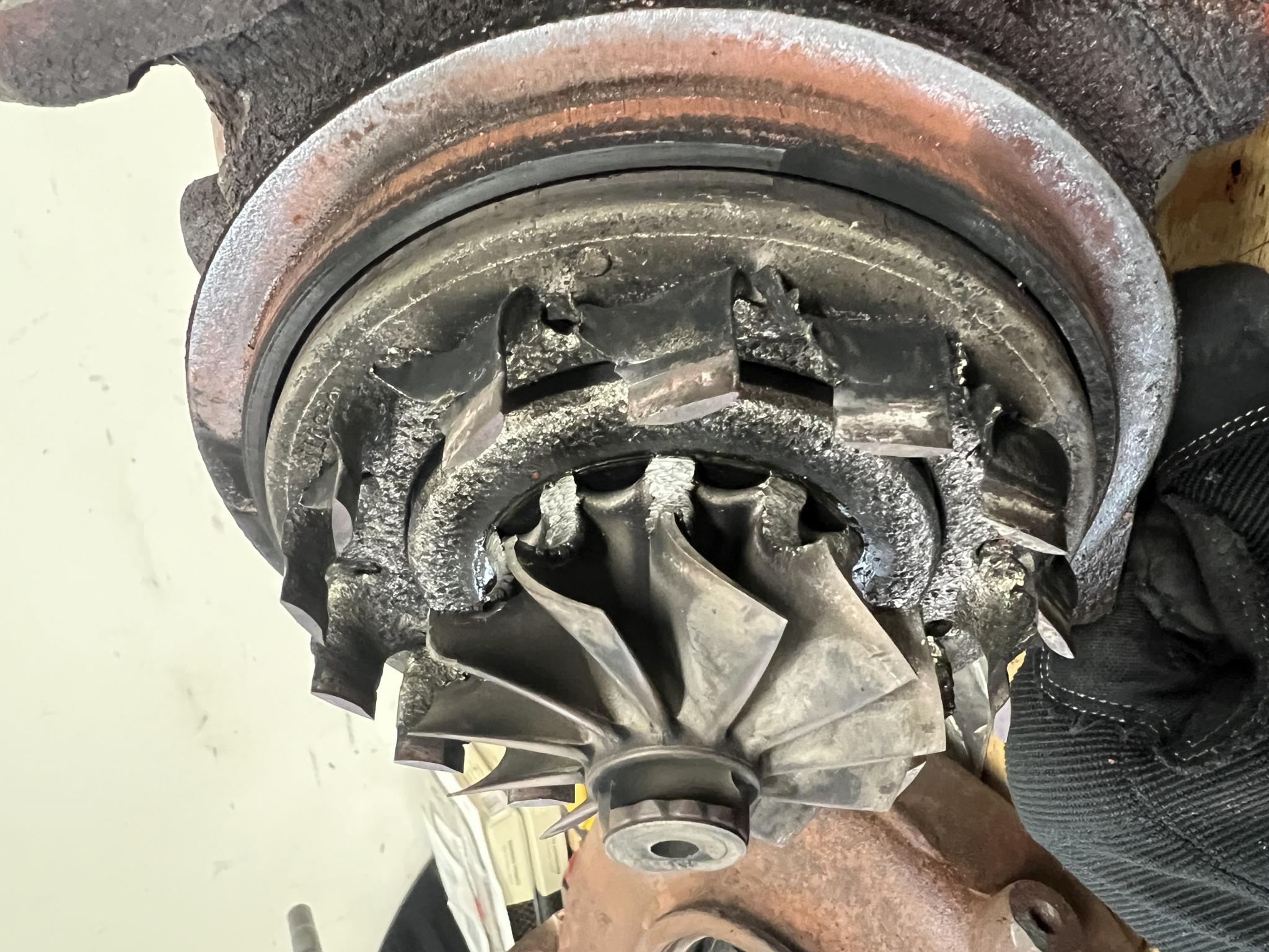

 RE: High fuel rail pressure.  (02-19-2025 )Rawze Wrote:(02-19-2025 )Rcac842 Wrote: ... So I finally had to pull the manifold and #6 smokes… how true is it that a messed up turbo messes up the engine? No wonder the place where I got the truck kept saying no warranty.  |  |||

|  RE: High fuel rail pressure.    Wow..... your CAC will need replaced because it's going to have a lot of aluminum debris in it, make sure you replace it with original OEM parts not aftermarket.    It's possible some of that debris got into cylinder 6 and wreaked some havoc causing it to smoke. You could pull #6 injector and look in the bore with a scope. I would also loosen all the valve train up and pressurize the entire engine with 35 psi to see if there's valve damage.  |  |||
|    02-24-2025, (Subject: High fuel rail pressure. )   Post: #12   |  |||
|  RE: High fuel rail pressure.    That turbine side is toast! CAC maybe spared unless the compressor wheel looks equally toast. Definitely check for valve damage.     |  |||
|    02-24-2025, (Subject: High fuel rail pressure. )   Post: #13   |  |||
|  RE: High fuel rail pressure.    At a quick glance I thought it was the compressor side. Yea your CAC is probably fine as he said.     |  |||

|  RE: High fuel rail pressure.    something went thru that turbo. That is not damage from wear. You need to remove the manifold, and everything upstream of that turbo to ensure there is no metal anywhere.   User's Signature: ->: What I post is just my own thoughts and Opinions! --- I AM Full Of S__T!.  |  |||
|    02-24-2025, (Subject: High fuel rail pressure. )   Post: #17   |  |||
|  RE: High fuel rail pressure.    They are going to remove the head ☹️ but better to be safe than sorry. It’s already looking like a rebuild     |  |||
|    02-24-2025, (Subject: High fuel rail pressure. )   Post: #18   |  |||
 RE: High fuel rail pressure.  (02-24-2025 )Rcac842 Wrote: They are going to remove the head ☹️ but better to be safe than sorry. It’s already looking like a rebuild WHY????... WHAT MORONS!!!... PULL THE GODD$AMN INJECTORS AND BOROSCOPE IT FIRST !!!!... A boroscope and bottom end inspection will reveal anything wrong internally. Take it apart just to look and it might be a HUGE waste of moneys. Sure, there is a chance that it may need to be rebuilt due to internal damage,. ... but never make blind-man assumptions like that. and if the head has to come off it.. then it will need a full inframe simply due to disturbing everything. Here is how it should be done.. no less... and good luck finding someone willing to do it 100% right.. because most mechanics are nothing but speed-gun happy hacks!. ref: http://rawze.com/forums/showthread.php?t...6#pid70606 User's Signature: ->: What I post is just my own thoughts and Opinions! --- I AM Full Of S__T!.  |  |||
