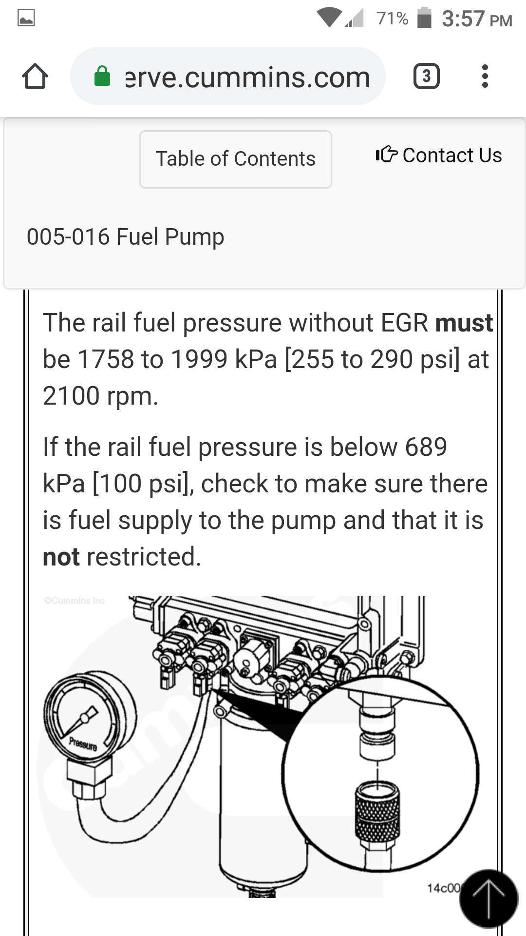

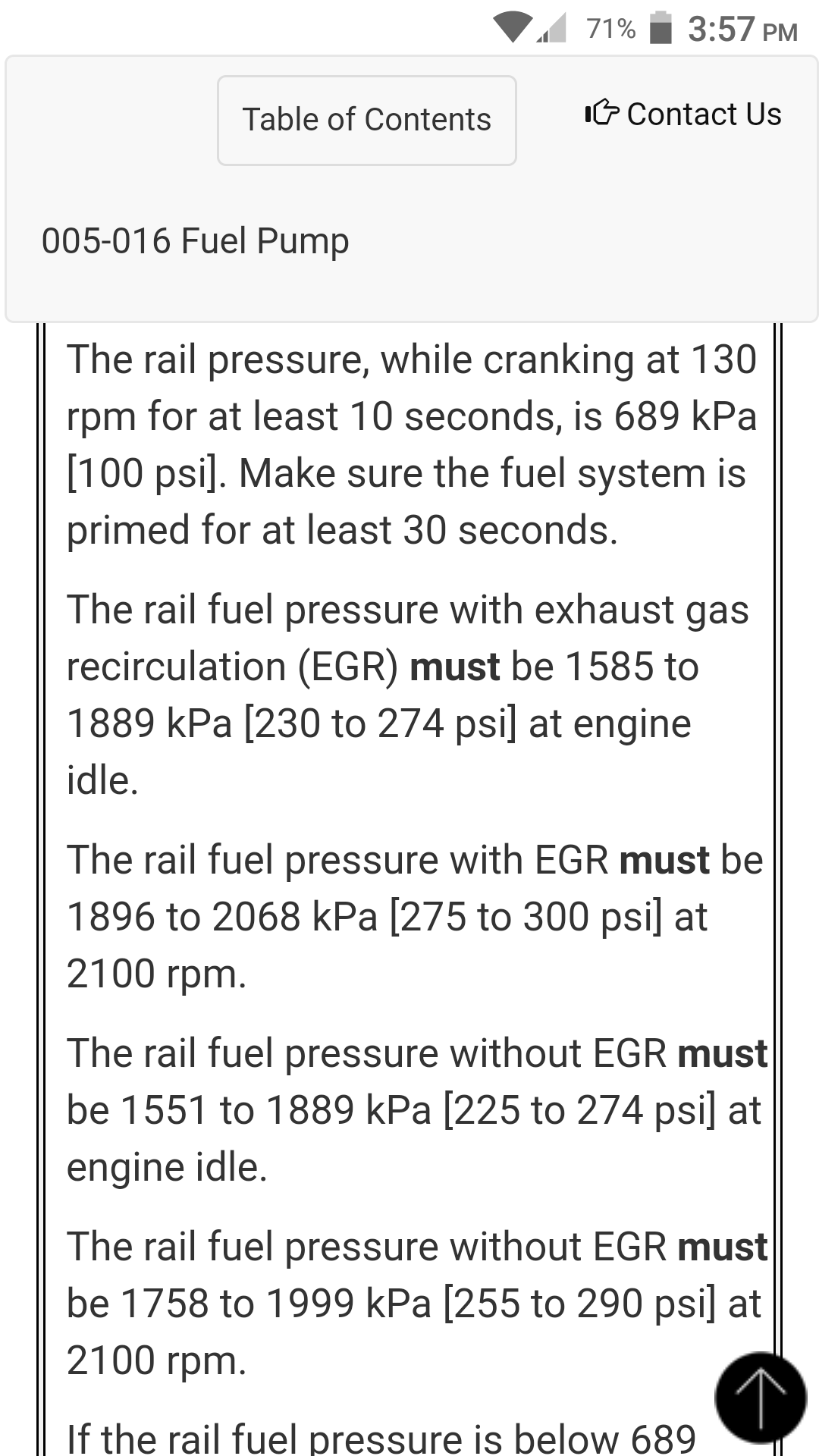

RE: 870 2006 fuel lift pump ![]() ![]() I own a 2006 CM870 https://quickserve.cummins.com/info/index.html is your friend!! I pulled the screen shots directly from Cummins quickserve. It's free!! | |||

| RE: 870 2006 fuel lift pump Well , I can say this , I tested the pressure at the pump cranking it went to 200psi . I got the gauge out like shown . I stopped there . I spent some time at the dealer, discussion ... things started to point towards the turbo being stuck, possible actuator valve . So I came home with the actuator valve and the air operated unit that supplies/ tells it to open close .Thats not the problem either . Actuator moves as well as the arm on the turbo. Its not stuck . I am dreaming .. could it be the ecm ? | |||
| 07-11-2019, (Subject: 870 2006 fuel lift pump ) Post: #25 | |||
RE: 870 2006 fuel lift pump (07-11-2019 )akwman Wrote: Well , I can say this , I tested the pressure at the pump cranking it went to 200psi . I got the gauge out like shown . I stopped there . I spent some time at the dealer, discussion ... things started to point towards the turbo being stuck, possible actuator valve . So I came home with the actuator valve and the air operated unit that supplies/ tells it to open close .Thats not the problem either . Actuator moves as well as the arm on the turbo. Its not stuck . I am dreaming .. could it be the ecm ? maybe disconnect the exhaust behind the turbo and ensure there is not an exhaust blockage. make sure there is no intake blockage too. User's Signature: ->: What I post is just my own thoughts and Opinions! --- I AM Full Of S__T!. | |||
