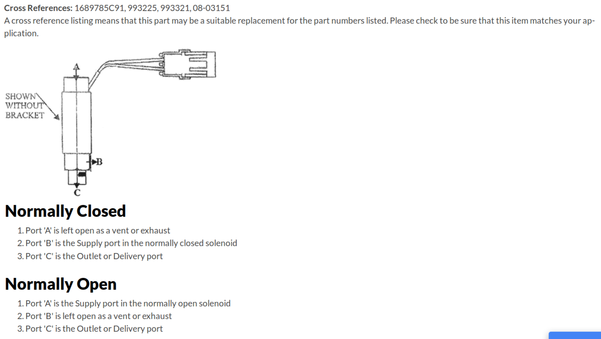

RE: Compressor Inlet Temp sensor (05-10-2020 )rapidisimo Wrote: The old and new solenoid had plugs i just plugged in didn't have to splice any wires. I don't let anyone touch my trk, I do all the work myself. I've never had any issues i couldn't correct myself until now with this fan issue. When I had insite in the past I did update the ecm when insite directed me to do so. I guess it could be a bad solenoid, I just thought because I replaced it not long ago, it couldn't be that. the solenoid for the prostars looks like a piece of brass pipe. It has 3 fittings/ports on it. -- Inlet, normally open, and normally closed. ... if you plumbed it to the wrong fittings, or got inlet and normally closed backwards, or got it any other way around besides the way it goes, etc ... then it will not operate correctly. this came up on a search. I think it is correct, but not 100% sure, as my truck is not around to see how mine is hooked up... ---- It should be connected "Normally Closed". User's Signature: ->: What I post is just my own thoughts and Opinions! --- I AM Full Of S__T!. | |||

| RE: Compressor Inlet Temp sensor On the normally closed it says "A" should be left open. Mine has a blocking nut, stud thing on it, should that be there? If I take it off air leaks completely out when I shut the engine off. With the engine running it leaks while building air, fan on but once it reaches about 90 psi it stops leaking. Is that how its supposed to be? | |||

| RE: Compressor Inlet Temp sensor thats how it suppose to be above 90 PSI your fan should turn off unless its commanded on. below 90PSI it just always has fan on. User's Signature: 2010 Lonestar - CM871 - 13sp - 3.70s, 2016 T680 - cm2350 - 13sp - 3.36s - skateboarder | |||
| 05-10-2020, (Subject: Compressor Inlet Temp sensor ) Post: #26 | |||
| RE: Compressor Inlet Temp sensor Ok, but when i turn off the engine air begins to leak out of part A in the pic above that Rawze posted. | |||
