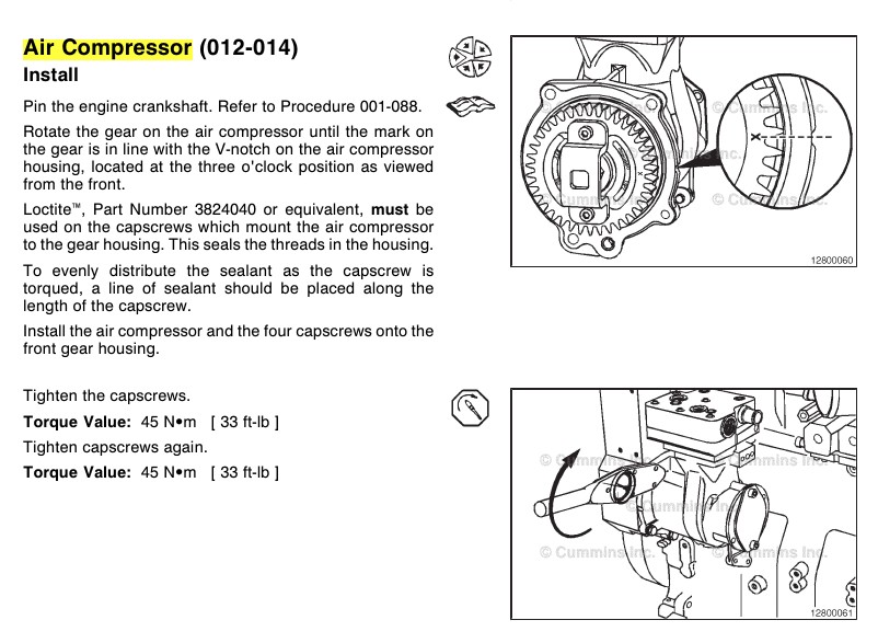

The fuel system adjusted? This ain't an old CAT... Like Rawze said, you are being taken to the cleaners. And do not be offended, hell, many of us have been there, I know I have, and the reason I am here. You are going to have to invest in the tools and learn if you are going to own one of these EPA trucks, there is no way around it if you want to stay in business, or have very deep pockets and like taking it up the rear end at every turn. Don't be that guy.
And that engine knock, you said they put a new compressor on, I wonder if they lined up the timing marks, or like most shops, totally skipped that step and threw the compressor on?
The ISX is notorious for its compressor knock, when it is building air. When it reaches full pressure, the knock goes away. You said the knock is at or near the compressor, I wonder if it was installed correctly? And it seems a bit odd that a compressor would fail with less than 400,000 miles on it... They normally make it to around the 800,000 mark, at least that is when mine bit the dust, of course it was the middle of winter and I froze my rear end off installing it in the driveway.

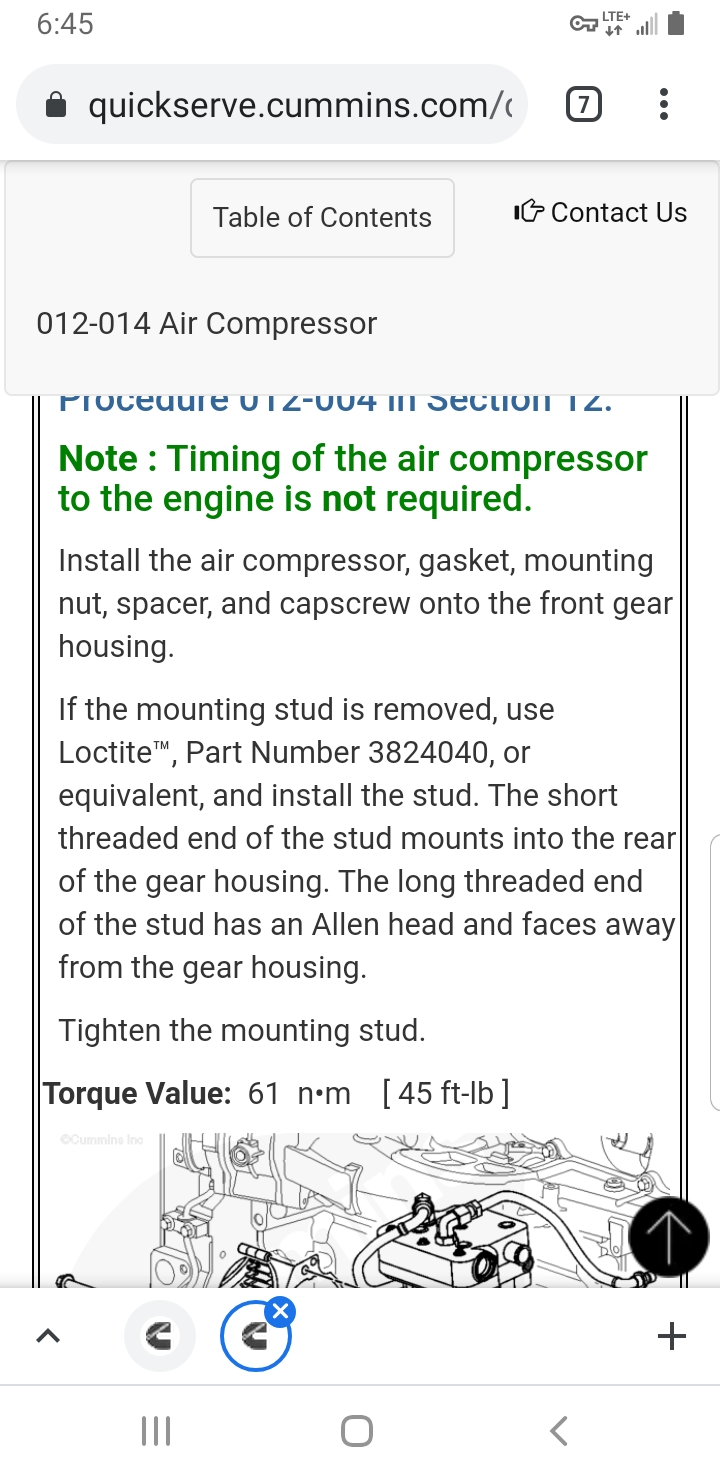

It's very expensive to repair at a dealer and as I see now, it's useless :)) Unfortunately, this understanding comes gradually, simultaneously with money being sucked out of pockets.
I buy every wrench and tool I need for repair the truck. Read lots of info. Prefer to fix everything by myself. But here I stuck with this loud knocking and cap. Need help. Asked Haggai Shop now.
Yes, on 2350 compressor is really loud when pumping. Does not need timing on this engine.

(03-05-2021 )tree98 Wrote:  Why don't you send an oil sample to the lab to see if your oil is getting contaminated with coolant.
I sent old oil. Lab didn't find contamination.

(03-05-2021 )SupVit Wrote:  ... Does not need timing on this engine.
I would have timed it properly any ways... all the old manuals required you to time the compressor to reduce knocking and prevent imbalance to the engine.
./uploads/202103/post_2_1614957234_b00218b226c40071d734a42054e8614b.jpg
My video here describes exactly what the old manuals used to say...
I have seen my share of them in the past that sounded like crap, simply because they were clocked wrong onto the engine.
the fuel pump has the same issues. it need to be clocked correctly too. it gets real noisy if it is not.
Not saying that is your issue... but you should always strive for the best practices when replacing components. - Sometimes they sound like crap though no matter what. The reman compressors are usually the loudest for some reason or another.

(03-05-2021 )Rawze Wrote:  I would have timed it properly any ways... all the old manuals required you to time the compressor to reduce knocking and prevent imbalance to the engine...
I know it, sir. I watched ALL your videos (except programming). I like to start repair work having info about every bolt and nut. That is why I asked him to check for manual again.
