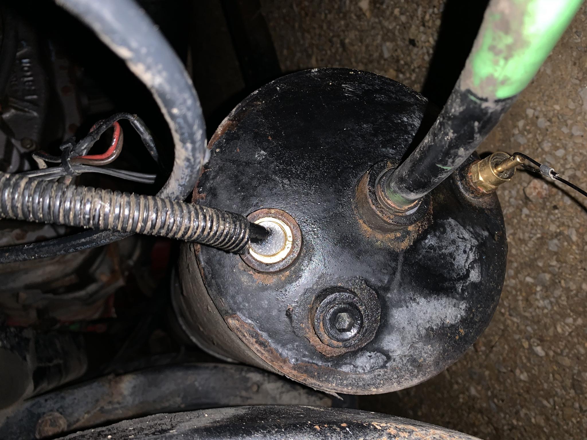

11-03-2021, (Subject: 04’ cm870 air compressor keeps breaking ) Post: #25 | |||
RE: 04’ cm870 air compressor keeps breaking So what I have found is small leaks similar to this one.The check valve where the hose is connected is a day old.How do I stop a leak like this one? | |||

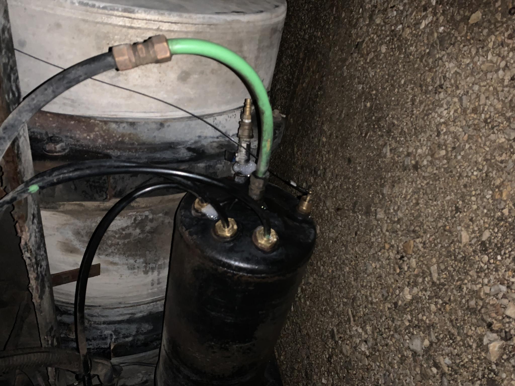

11-03-2021, (Subject: 04’ cm870 air compressor keeps breaking ) Post: #26 | |||
RE: 04’ cm870 air compressor keeps breaking This is the other tank.All fittings on that tank are less than a month old.The valve is an easy fix but what about the other ones? | |||
11-03-2021, (Subject: 04’ cm870 air compressor keeps breaking ) Post: #27 | |||
RE: 04’ cm870 air compressor keeps breaking I bought a brand new pete 567 3 years ago, all the fittings have leaked just like those since the day I got it. Crappy fittings from our friends in Asia. | |||
