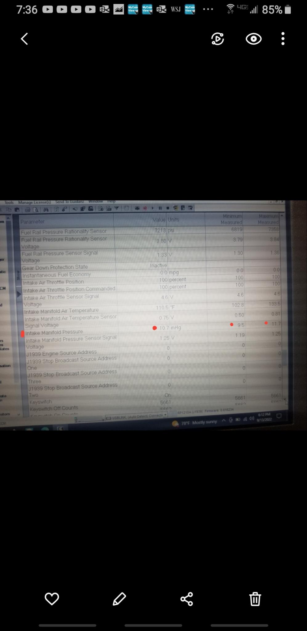

| RE: 2016 KW T-680 ISX15 CM2350 -Code 125- At Wit's End... Don't know y it's not letting me upload my screenshot. Intake Manifold Pressure is 10.7 inHg Minimum measured 9.5 inHg Maximum measured 11.7 inHg | |||
| 09-15-2022, (Subject: 2016 KW T-680 ISX15 CM2350 -Code 125- At Wit's End... ) Post: #24 | |||
| RE: 2016 KW T-680 ISX15 CM2350 -Code 125- At Wit's End... Screenshot of Parameter(s) | |||
