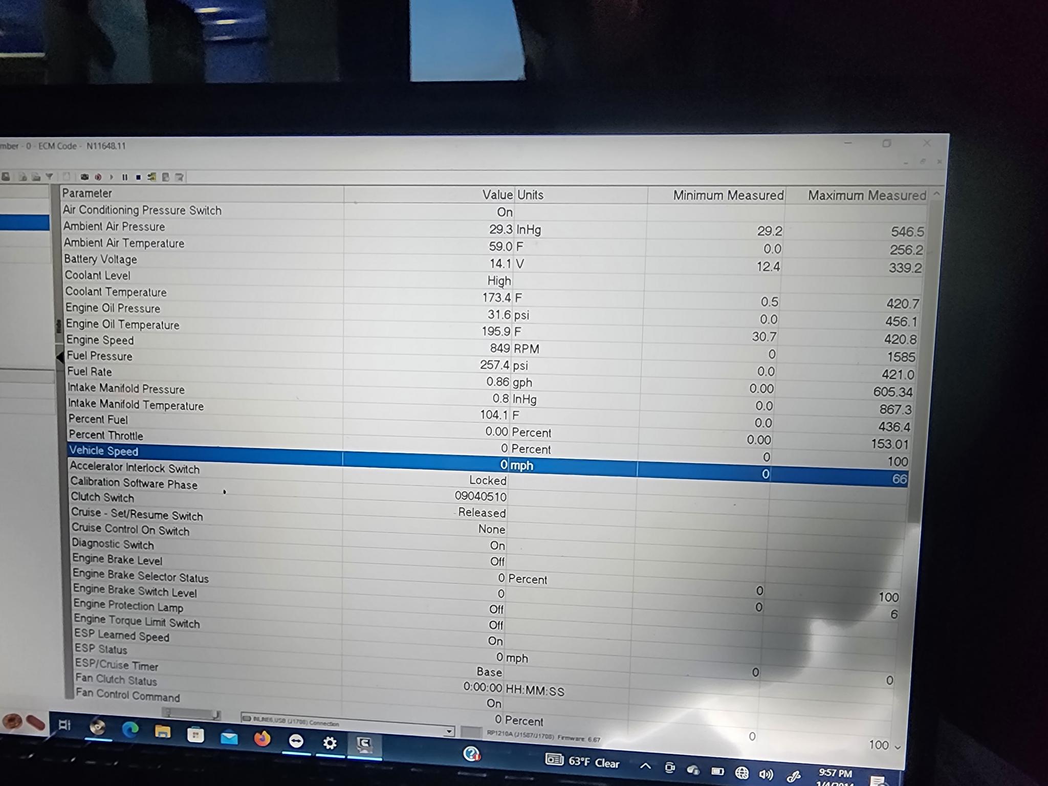

I have chinese inline, when I hook it up...I see weird thing..when I m9nitor readings
Current values,it reads ok..but after 10 minutes,min-max digits showing crazy...
In example oil pressure min..0,max 490psi
And all parameters like that..wondering...is it Chinese adapter,or Ecm..getting signals like that and going crazy..?

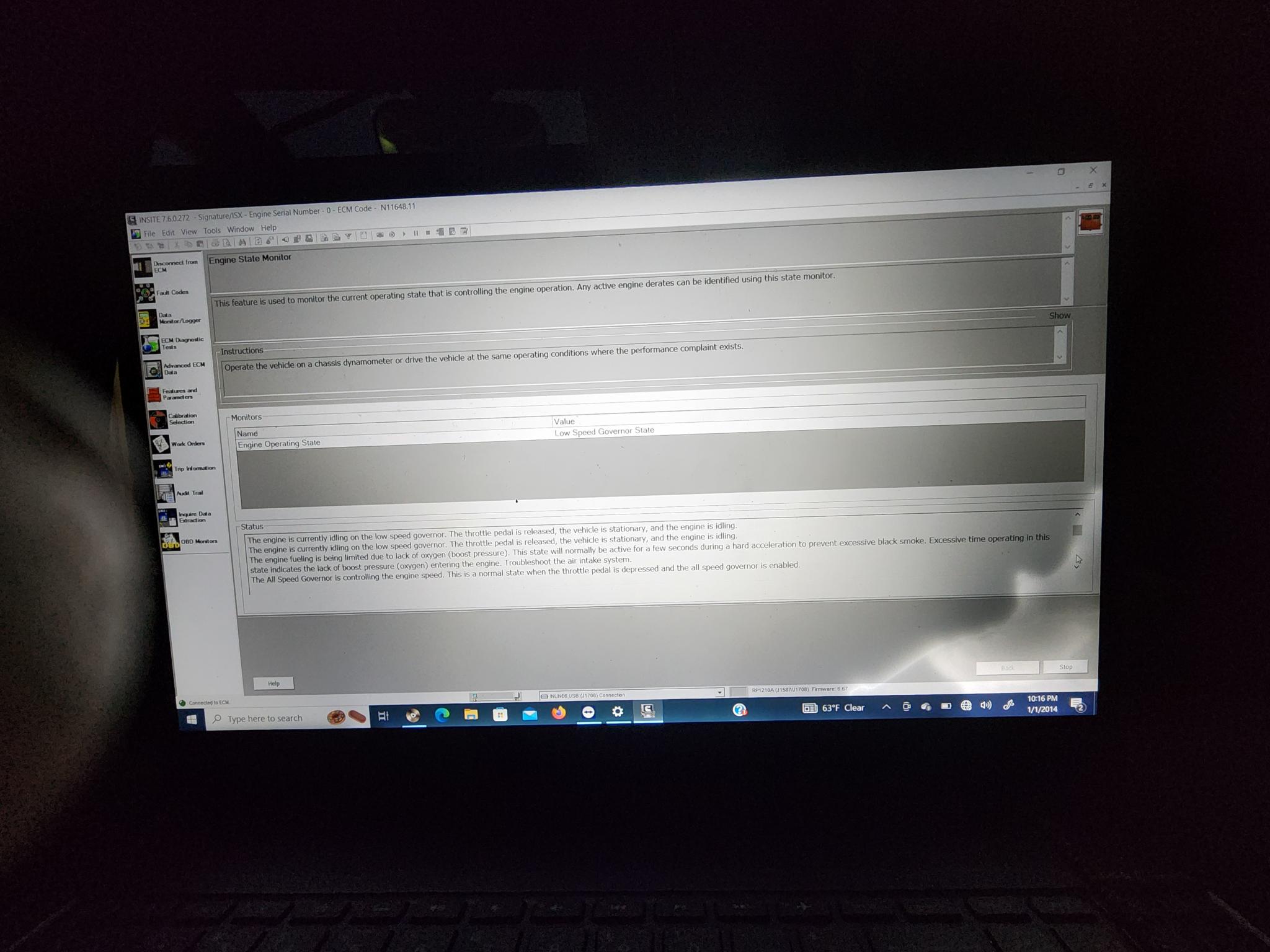

Also found option...engine state monitor...
While accelerate, or press throttle quickly...it shows message-fuel limiting because lack of boost pressure. To prevent black smoke..check air Intake system...and feel that engine is acting at that time..
And air intake system is operational..no leaks,holds pressure, turbo makes 27 psi..if it's mechanical, it shouldn't be Intermittent?
Turbo,injector won't be ..1 day spinning, spraying..1 day they aren't?

#4.. what you are seeing for the engine control state is exactly that. The engine doing exactly what it should be doing ... and it is 100% normal for it to transition in and out of fuel-air-mix hold-back conditions because the turbo is mechanical, and it takes time for it to spool up when you hard accelerate. - What your seeing is perfectly normal.

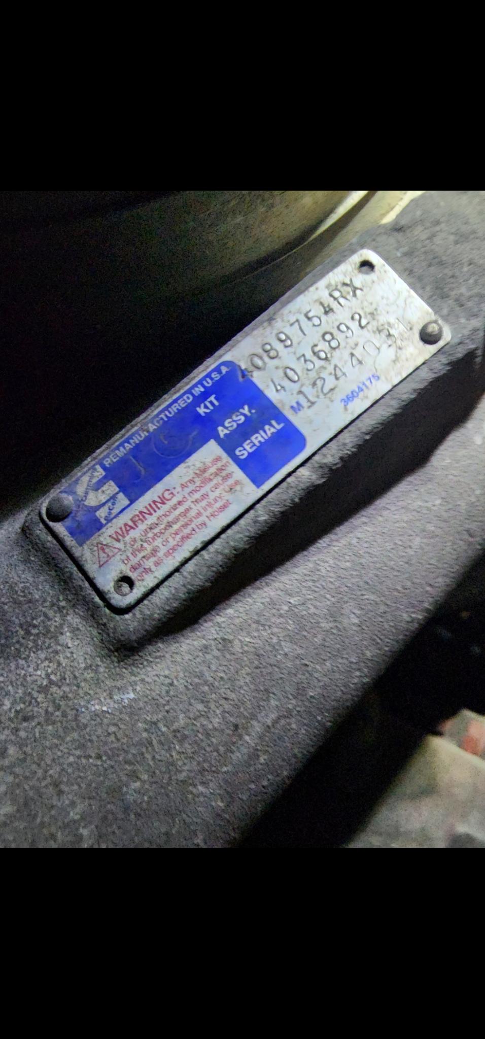

I have plain turbo-no wastgate,no actuator,no sensor...
It's still should be around 36psi?
I have at most 27...
No cac leaks,intercooler radiator-oem,mufler 1 year old.
No horizontal freeplay on turbo shaft,but a lot of sooton hot side of turbo....
If even all this,turbo can be weak?
ECM is genuine cummins recon.

Chinese inline can wrong readings?as on pic?

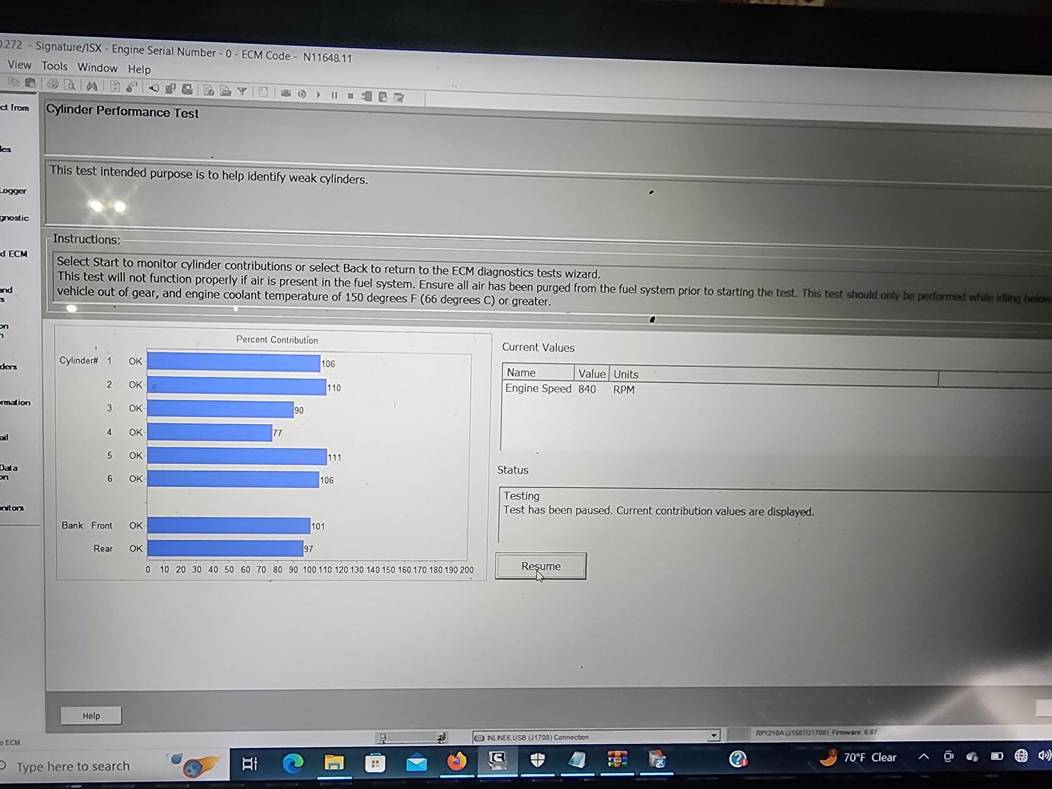

When I run cylinder performance test..
At 800+ rpms #3 is showing 77%,#4 slightly higher,but much lower compare to others...
At idle 600+ rpms,digits are better...
Does it mean that on higher revs they are underperforming?
Are #4&3....need to be inspected and replaced?

You have a bad program and possibly the wrong turbo on your engine. Why are you getting files from a "tuner" your engine is pre emmission so all you need is a factory file with the HP level you choose. Nobody here can help you as long as you have such a butchered up mess.
Put the correct turbo for your engine back on it and then get yourself a copy of c a l t e r m 3.17 only then can you begin to undue this horrible mess your in. Version 4 isn't going to work very well on an engine as old as yours.
 Thanks given by: hhow55
07-05-2024, (Subject: 2003 volvo isx15 cm570 issues )
Post: #27
RE: 2003 volvo isx15 cm570 issues
Hey,my turbo matches my engine serial number
