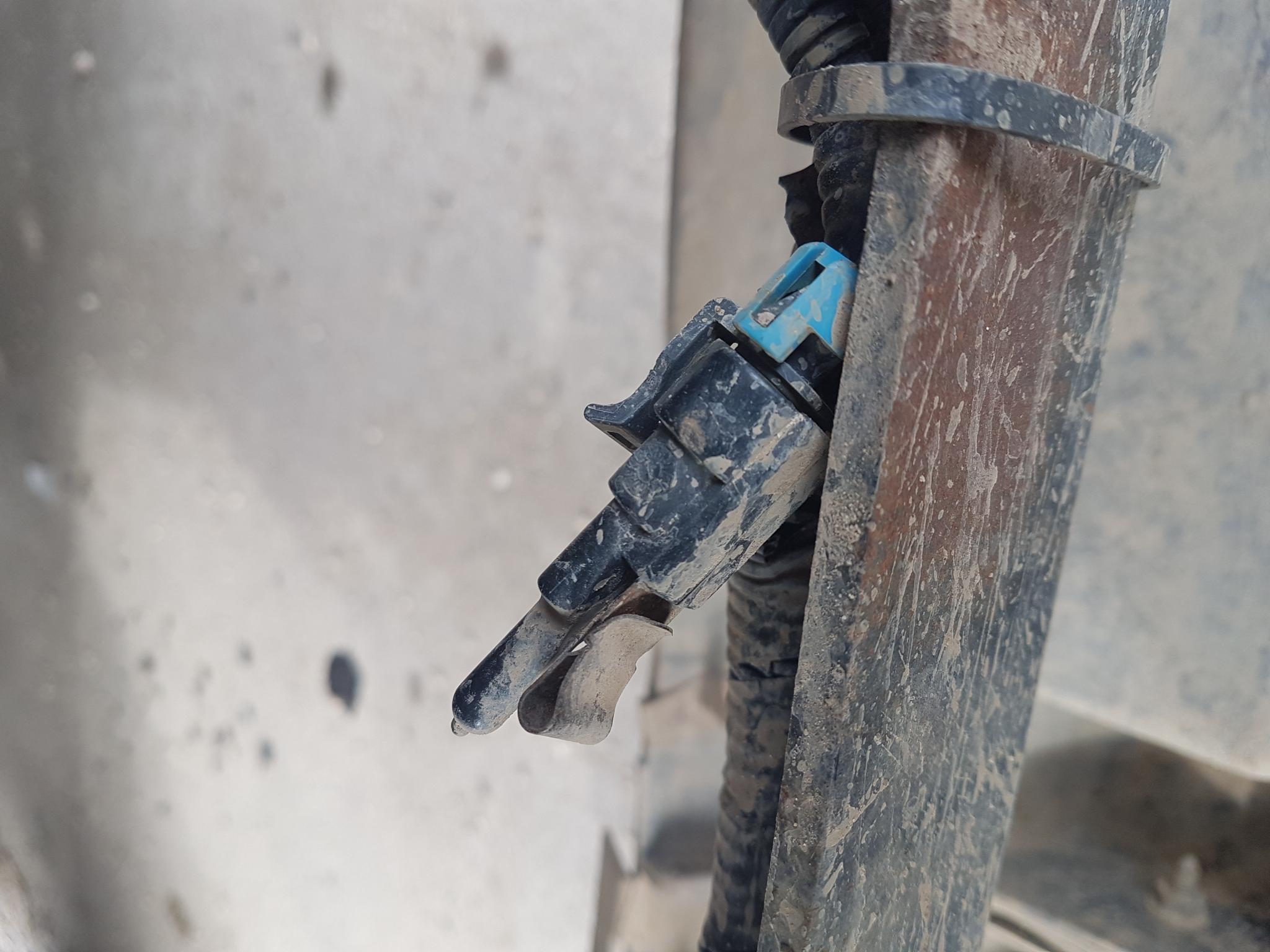

Is that what this is?
04-20-2018, (Subject: I found the Ambient Air Temp Sensor! 2008 ProStar... )
Post: #30
RE: I found the Ambient Air Temp Sensor! 2008 ProStar...
That would it.

Wow they really don't change the design of something. That looks like the exact 1 they used in the late 90's Century class. They used to mount them in the air dam section of the bumper and road debris would annihilate them.

I found mine, right where Waterloo said. I disconnected the sensor to cleaned it up. Relocated to behind the front bumper ( I'm looking to make a pig tail to mount it up on the windshield cowl. I don't like to cut factory wires.) My AC will freeze me out now.

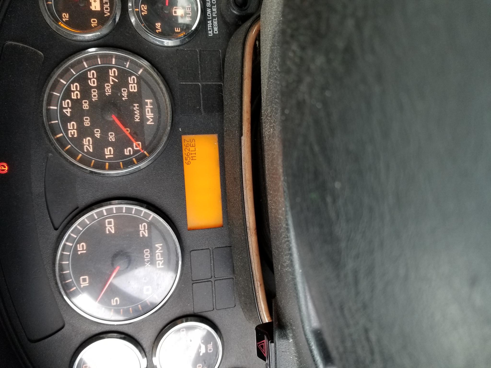

06-10-2019, (Subject: I found the Ambient Air Temp Sensor! 2008 ProStar... )
Post: #33
2010 prostar daycab...should I have the outside display on my dashboard cluster? Nothing but odometer...I even clicked thru the rest of the functions and no ambient temp readings.
This may explain why my a/c is cold in the am but during the heat of the day blows lukewarm...been chasing this a/c problem for quite a while now(new thermistors, new high temp cut out sensor, 2 new actuators, new receiver dryer, new a/c compressor). There is supposed to be a third actuator on the engine side...not sure if I can access it without evacuating the system...
I am getting lukewarm air thru dash vents when blower fan is off, driving down the road.... oh and also after replacing the g#**@@* 1800.00 body controller (thanks international)

Well I replaced the ambient temp sensor....still no outside air temp displayed on my dash??? No change in A/C performance either....
