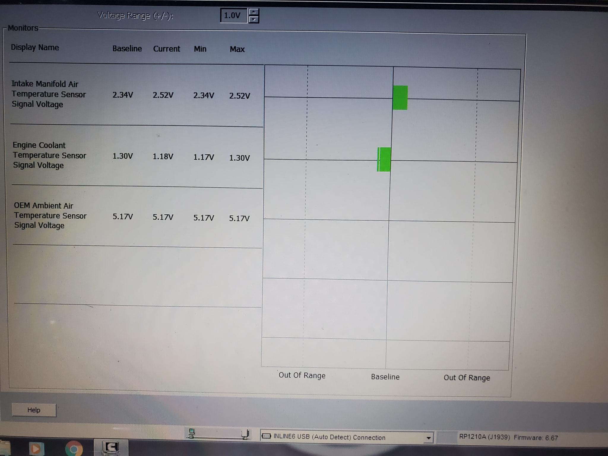

Finally got Insite working, and noticed I had an amber warning for the fan control circuit. I started looking at wiring, but it started raining and I put it up for the night. Was able to run a few tests though, and happened upon this.

That picture you posted is nice for finding intermittent problems, but if something is constantly reporting an incorrect value then it might not be noticeable there. Even still, 5.17v for the ambient air sensor seems off as they are usually in the 0-5v range. That could be the issue, either a bad sensor or wire on that circuit.
See Rawze's earlier post about ambient air temp bug with 870's.
Pull up Data Monitor and see what values the sensors are reporting. You can also see there what reason the ECM has for operating the engine fan. If the ambient air temp is reporting maximum high temp then the ECM might think it needs to run the fan to prevent over heating?
Also, what fault code was showing for the fan control and was it active or inactive? 1 count or many counts? recent or old? It may have been corrected by something you already replaced.

Code that I pulled was 2377 Fan Control Circuit Voltage Above Normal or Shorted to High Source, but it's been a couple of days since I pulled it, so I can't remember if it was active or not. I do, however, remember that it showed as amber next to the code. I have the program on my laptop, but stupid me left it at home. It's not something I normally carry, so I missed it on my rounds of getting everything together to go back to work.
