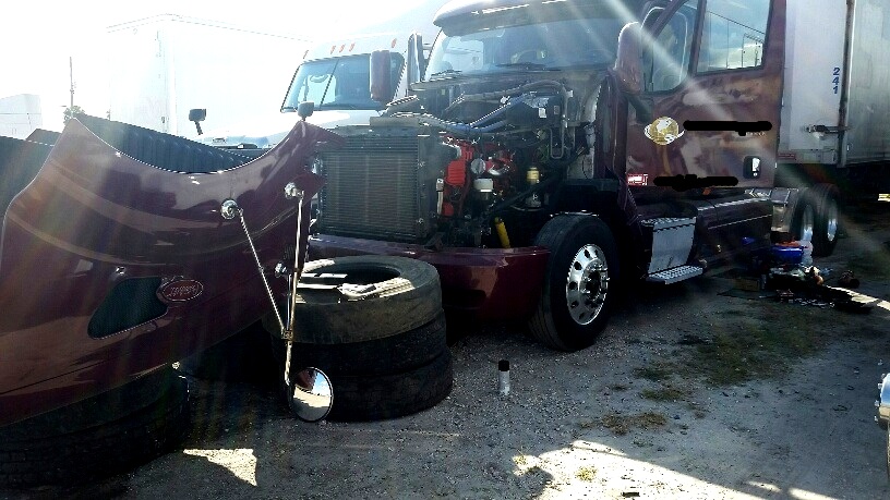

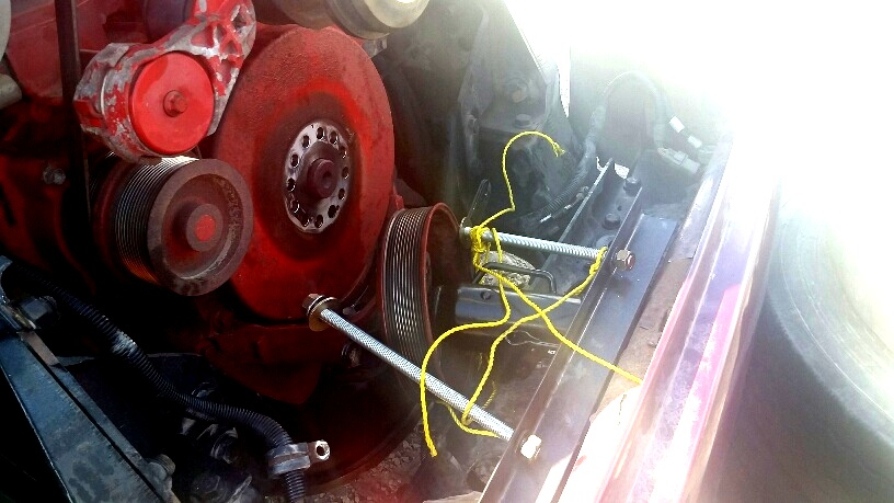

The hardest was to remove the pulley first. Wasn't so lucky as Bahdan, so I had to take the hood and radiators off - air and coolant (the AC condenser could be just moved away together with the hoses) to have enough space for using tools.
I used a 20Ton lift jack, a 2"x2"x0.125" red steel angle, made two 5/8" holes in it for two 5/8" red threaded rods and fixed all this with four 8th grade 5/8" nuts and washers (bought at ace harware). I put the pulley under tension to the point when the steel angle started to bend, then I used a torch to heat the pulley arround, after 2 min it popped out
