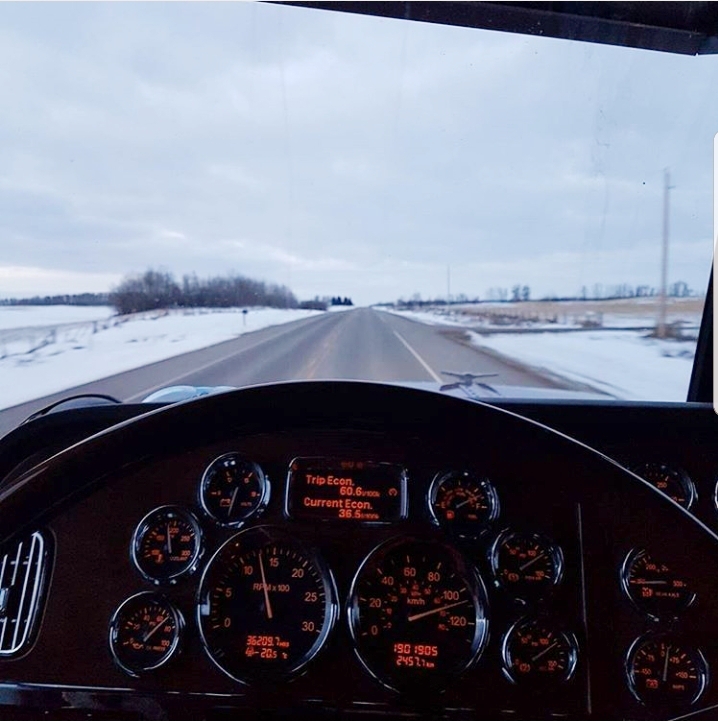

RE: What would you have done differently?? ![]() 3:36 on 11r24.5 I call 18th my Gettin home gear! User's Signature: I'm no mechanic, I'm just a guy that breaks down enough to know a bit. | |||
| 11-10-2019, (Subject: What would you have done differently?? ) Post: #61 | |||
RE: What would you have done differently?? (11-10-2019 )Brock Wrote: 3:36 on 11r24.5 I call that the "suck the bottom out of the fuel tank while lugging the engine" mode. This is because there are plenty of morons out there that would drive that way fully loaded. User's Signature: ->: What I post is just my own thoughts and Opinions! --- I AM Full Of S__T!. | |||
| 11-10-2019, (Subject: What would you have done differently?? ) Post: #62 | |||
RE: What would you have done differently?? (11-10-2019 )Rawze Wrote:(11-10-2019 )Brock Wrote: 3:36 on 11r24.5 Oooh I've heard it over and over again, argued with every damn driver I had over it . They all said "it's a cat, you can lug it" Maybe hauling fu$#ing toilet paper, not 140,000lbs ffs!! I run 17th at 100km 62mph ish.... and turn around 1600 rpm for the heavy load, 18th is solely for passing or blowjob day when I just gotta do 120km to get home lol This all being said, once i get my ISX swap done, I'm gonna swap out the gear ratio if i go back to heavy hauling..... it's just too hard on the driveline and engine to lift off with such tall gears. User's Signature: I'm no mechanic, I'm just a guy that breaks down enough to know a bit. | |||
