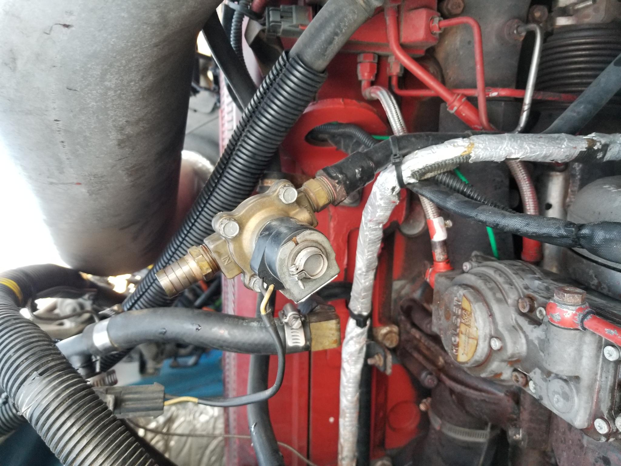

I am replacing my heater core again. I just had a shop do this last month, and it is leaking again. I'm ready to install new one, and need some info on which hose goes where.

does anyone have this valve? Can I remove it with cause any problems?

That is an optional shutoff valve for the heater core someone has instealled (a person or the dealership?). If it works ok then I would leave it in the circuit because it will make the A/C run cooler in the summer with the heater core switched off. Other than that, you probably could remove it if you wanted to. my own truck does not even have that valve.

Maybe there's something making your heater cores fail?

(02-01-2018 )Bahdan Wrote:  Maybe there's something making your heater cores fail?
Yes ! It’s wrong ! The valve is mounted in the core outlet side . It has to be on the inlet side .

Could also be a bad cab ground(s) causing the core to have to absorb ground current. Have seen that a couple times on dodge pickups. They are paticularly prone to that. One my bro did also have more than one failure and could only be fixed by installing a ground wire directly on the core. Not sure if that'll be your issue but might be worth looking at.

thanks for responses. I am going to remove it, i don't think it is working anyway. I have no heat when the truck is going down the road, and at the end of summer last year the A/C stopped blowing cold air. Maybe i'll just install a manual shut off valve instead. Wiseman is right, it is not installed on the supply side of the heater core.

can some post a pic of what their hoses look like going to heater core? Also it really shouldn't matter which hose I hook to up to the heater core itself? Is there a way I can see how much pressure my coolant system is generating when I'm going down the road?

Hose coming from head goes to inlet side . Inside heater core box there should be electric or manual/cable (depends on what controls you have)valve on inlet side . On others is on the firewall. Either case there should be valve on .
