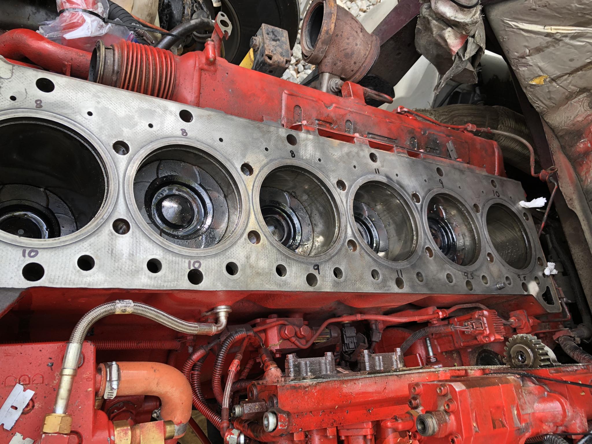

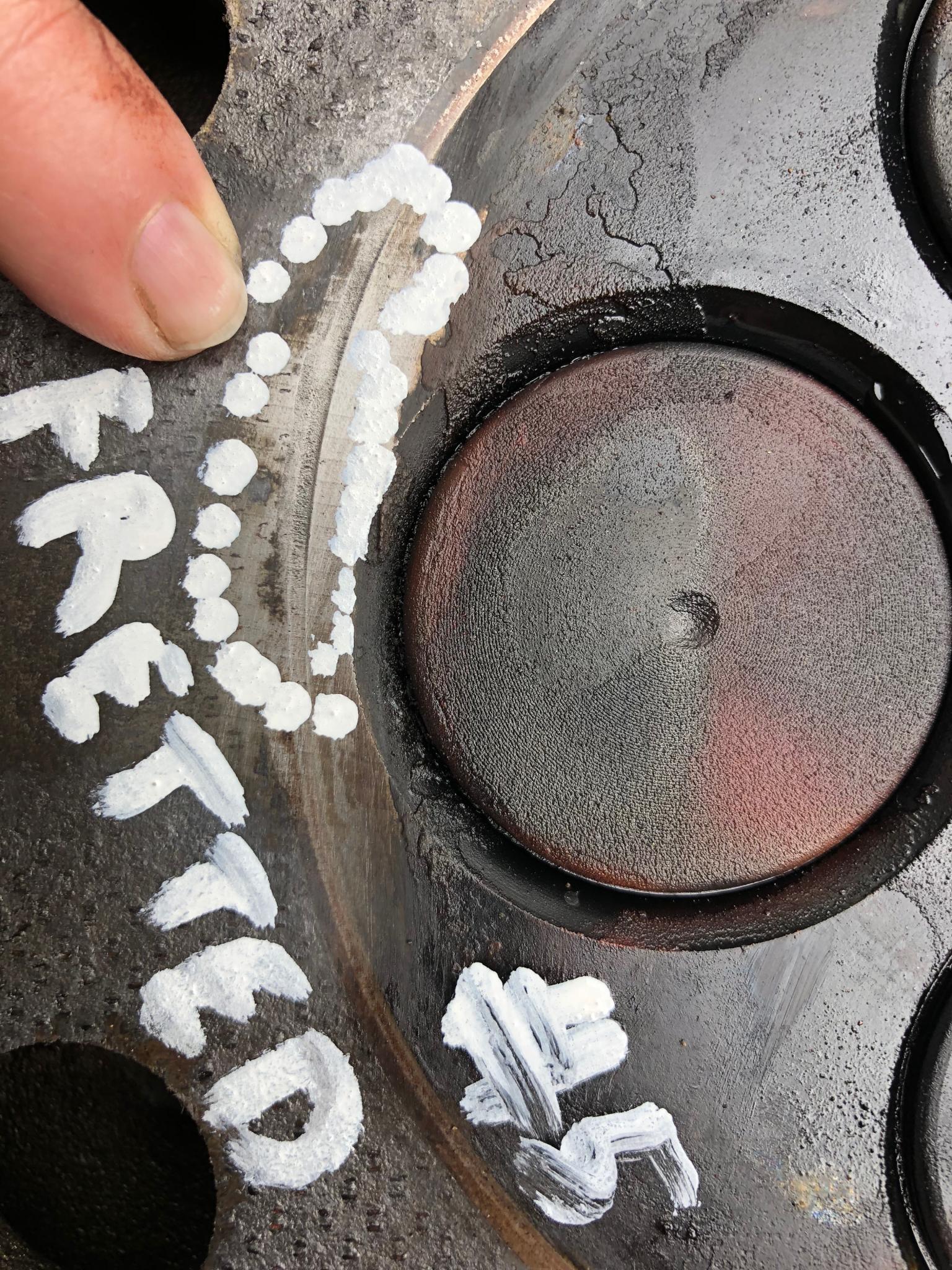

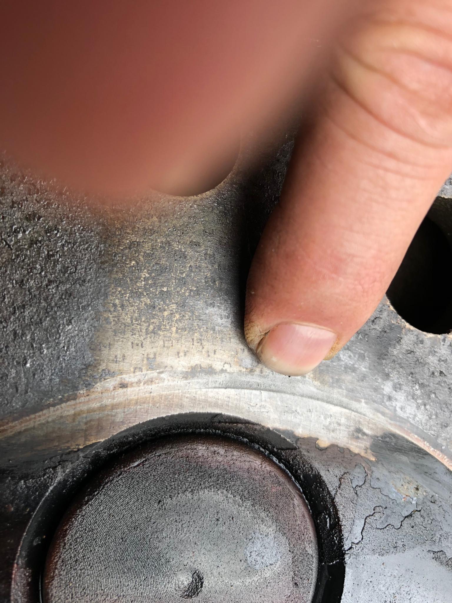

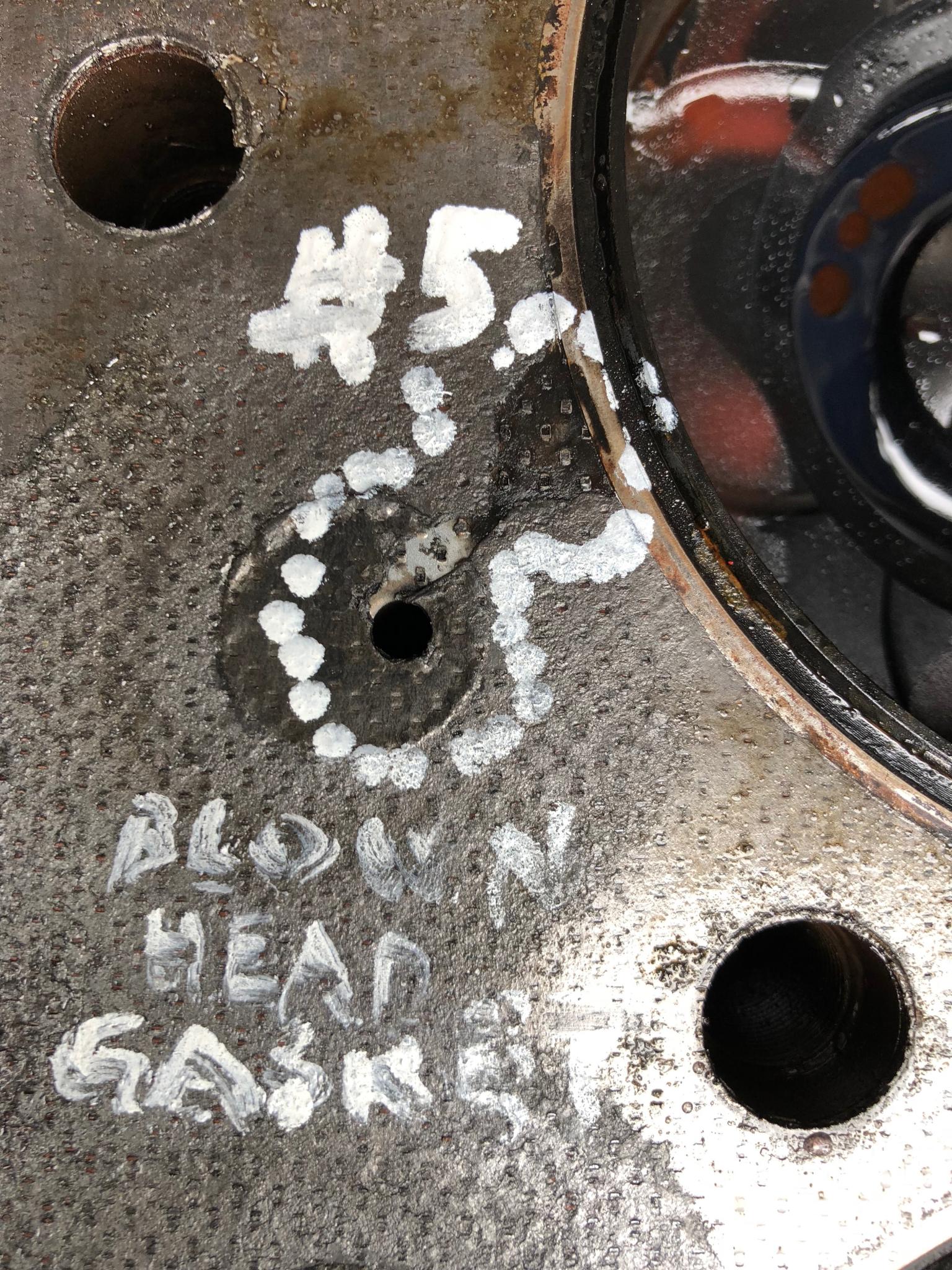

RE: Helping Waterloo out with an inframe ... -- Ok, so we tore the engine down today and found out what was wrong with it... Besides the parts for a smaller tier engine in it, we also discovered that the counter-bore he asked for never happened. It looks like 800+k miles of wear on the block at the mid-stops and that is the reason why he needed the inframe the first time. No machining was done at all. It appears that they simply took the engine apart and slapped in a new piston liner kit, head etc. --- The problem now is that the liners were dancing because of all the step wear that never got fixed. Most of the liners were leaning to the passenger side by at least 0.002". Here is what we measured when compressing the liners ... This caused the liners to eat into the new head pretty deep (several thousandths in places) ... So,... he will need an overhaul kit, a new head, the counter-boring that got missed, and a set of 0.020" shims to get this right. the only problem now with this is that he will need to figure out what kit to get. If he gets the stealershit to replace the 2 incorrect cams and injectors with the correct ones, then he can get the right overhaul kit for it, but if he has to stay with the lower HP cams and injectors, then he will have to order the lower HP overhaul kit. What a mess. Myself, I blame the actual failure completely on the fact that it was never counter-bored properly the first time it was apart. This engine had more than 800,000 miles on it at 600HP and a lot of step wear that you could simply SEE with your eyes, nonetheless have to measure. They KNEW it had problems with combustion gases getting into the coolant. You would have thought that someone would have at least LOOKED at all the obvious step wear that we saw in it as soon as the liners came out. - If this had been done properly, the truck would not be in my drive-way being torn down a second time right now. This missed step in the process has caused all of this downward spiral and nothing else. this engine was doomed from the day it left the shop regardless of the fact it has some incorrect parts in it. -- This is what a top dollar $40,000 inframe at a dealershit looks like first class!. - They can have that s$it!. This is exactly WHY I always fix my junk myself. User's Signature: ->: What I post is just my own thoughts and Opinions! --- I AM Full Of S__T!. | |||

Caveat emptor Guys, I am still in shock at what is going on here. Rawze asked me if I wanted to do the latest status write up, I said "no", as I am having a heck of a time wrapping my head around all of this. We get up and work, very little if any time to think about any of this, I am just hoping for the best right now and eternally grateful for what Rawze and his family are doing for me. The motor is apart, laying on a few tables, etc. Rawze called this the minute the head was off. After measuring the liner heights, he was 100% positive at what we would find, and unfortunately for me, he was correct. And yes, I am learning quite a bit, but nowhere near up to speed as to where I should be. I was naive, look the word up, being "naive" is not a good thing, or place to be. I tried to do the right thing, I had both Rawze and Unilever helping my uneducated rear end when I was in the shop having this expensive abortion. I "thought" the mechanic was doing his job, I asked about counter boring, and was told that would be done, asked about shimming the liners, who will cut the block, etc. Turns out nothing was done, nothing was repaired and all of the wrong parts were installed. You cannot make this sheet up! LOL! Yes, LOL! This is so tragic that it is funny! The stuff you only read about and thank God it is not you. Well, the joke is on me, and trust me, this is not good comedy, this is criminal. Now, what do we do? Today we should find out if the dealer helps, or I leave here with a 450hp motor and a lawsuit. At this point, I am not even mad, I am just rolling with all of this, getting mad will not help the situation or get my truck repaired with the correct parts. I honestly do not know what else I can do, trying to keep a level head, even though all of this is as embarrassing as hell. Hopefully my travail with this truck will help someone down the road. Encourage others to learn their equipment, how to repair it and what not to do. Mechanic first, as everything else is now meaningless. What else can you do? And the sad part, who do you trust? The days of the old reliable Series 60 and N-14 are long gone, the simplicity of "it just works" has left the building. Yes, I am getting a very expensive education. | |||
