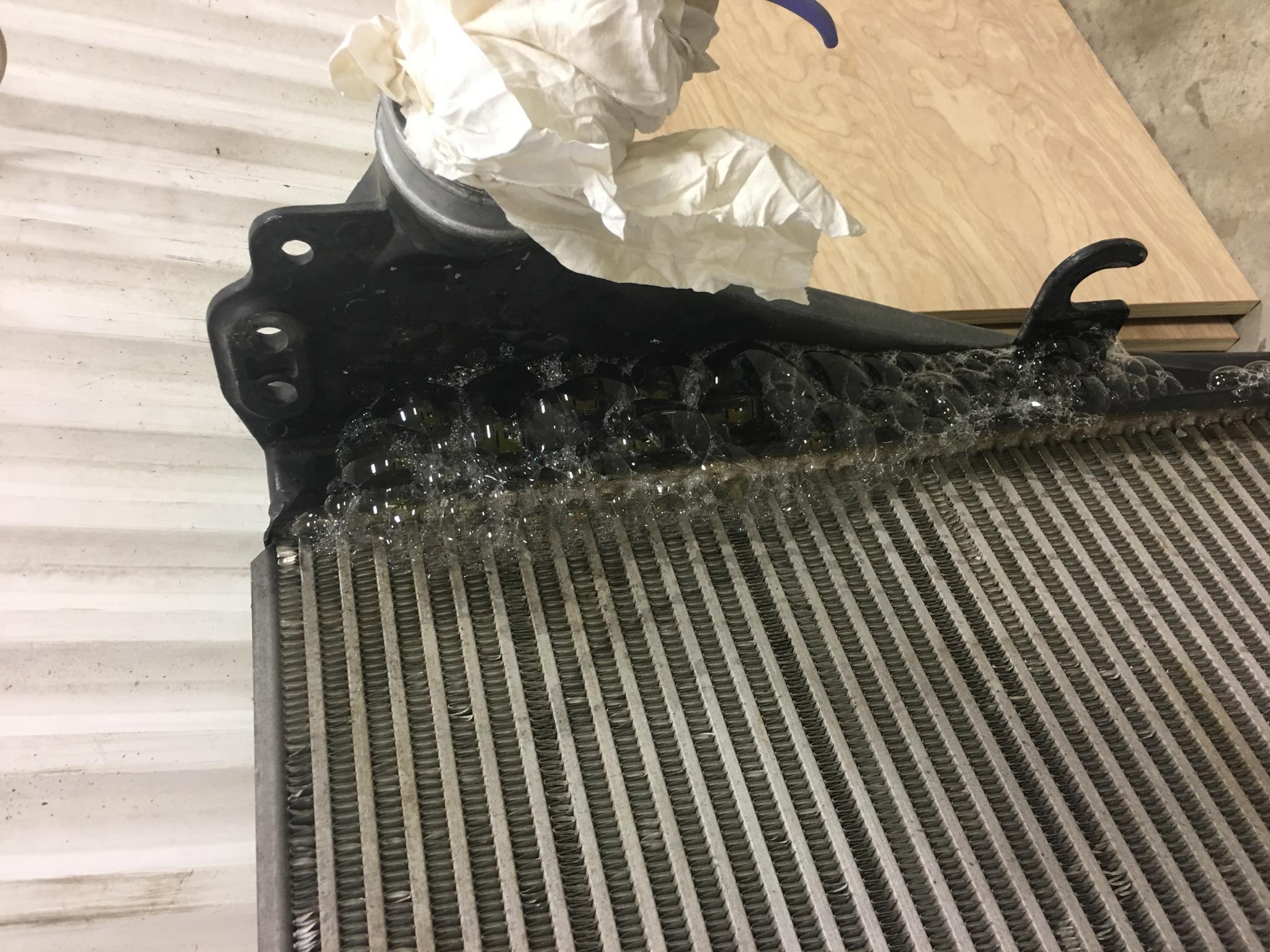

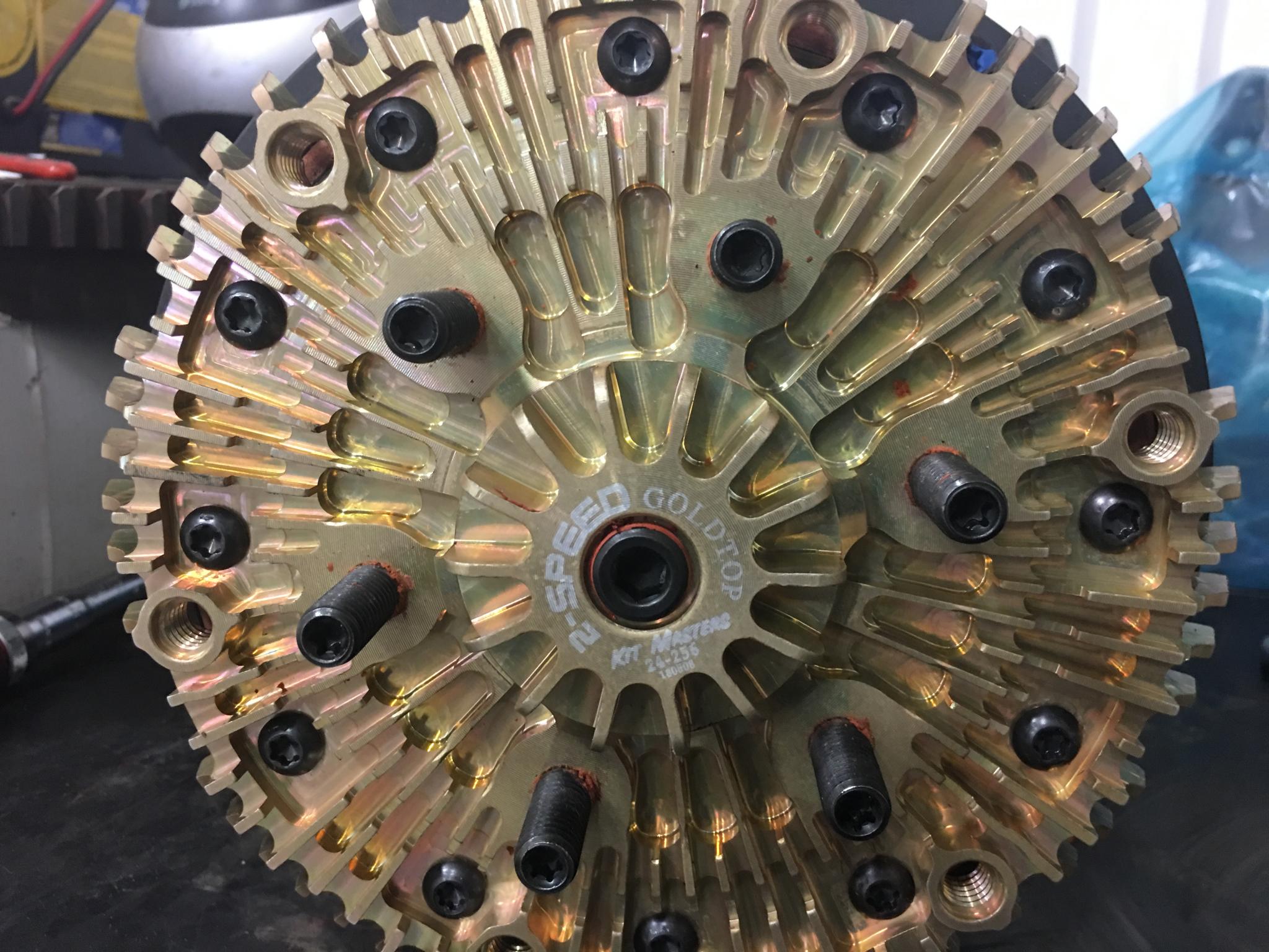

| RE: Air flow vs. rad shroud Alright, FINE!!! The village idiot has relented from his hair brained scheme of pulling the flat portion of my shroud.:too_sad: This ^^^ may have been a contributing factor:huh: Jeesh, I can't keep CAC's in this damn truck! I've had this truck since new, 12/09. The first CAC lasted 3 years, and since then it's been every 2 goddam years! Almost like clockwork. === I also replaced my thermostat and seal, it was not scraping metal on metal like the last one I changed was, but I had it open to inspect and I had new parts, so in they went. === Due to my, IMHO piss poor shroud design, and my belief that the full dimensions of the rad are not being utilized, I also put one of these in... I am thinking/hoping that the 2-speed hub will help draw airflow through the "stagnent flow" portion of the rad... I know, I know. You never make more than one change at a time or you don't truly know which change caused which or how much of the result. Crap was apart to change the retardly large CAC in this truck, and that made access to these other items easier. Yes, that means I'm a fat lazy bastard, and I'm ok with that. It leaves more time to drink beer and post my results here, so too bad! User's Signature: Why? Why do I always ask "why?" Because I can't learn or help teach others with "'cause I said so..." | |||

RE: Air flow vs. rad shroud (08-25-2018 )Hammerhead Wrote: ... make sure all your bushings are good and that things are not over tightened. That whole front structure needs to have a bit of give to it. Also when installing new, don't force any screws into their holes if they do not align up perfectly. Grind out the hole in the frame instead so that no stress is applied to the CAC or radiator. Lastly, when opening your hood, don't let it slam open. This will kill a CAC in a hurry and I see lots of guys do this at the truck stops while shaking my head every time. You also haul heavy. There is likely some twist in the frame when pushing things hard so make sure your lower front structure bushings are in good shape/not bound as well. User's Signature: ->: What I post is just my own thoughts and Opinions! --- I AM Full Of S__T!. | |||
