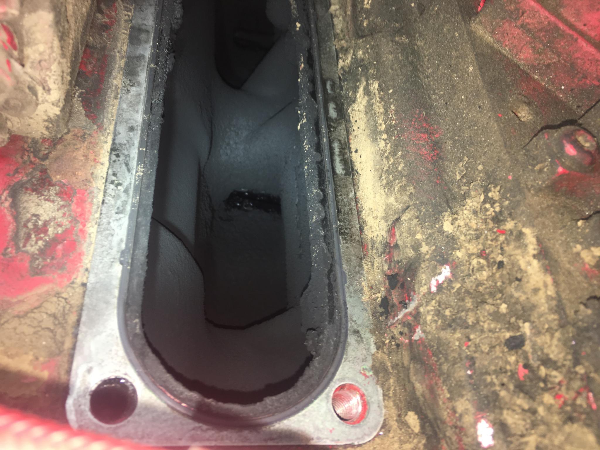

| RE: CM 871 Code 2639, DPF won't clean I started on the egr tuneup and noticed traces of antifreeze in the egr tube/intake pipe so it looks like I’ll be doing an egr cooler. I also noticed inside the head around the intake valves are wet. This one is worse than the rest. Normal or do I have injector oissues too? | |||

RE: CM 871 Code 2639, DPF won't clean (03-06-2019 )Doops22 Wrote: I started on the egr tuneup and noticed traces of antifreeze in the egr tube/intake pipe so it looks like I’ll be doing an egr cooler. I also noticed inside the head around the intake valves are wet. This one is worse than the rest. Normal or do I have injector oissues too? make sure the "wetness" is coolant and not condensation. ISX is notorious for getting condensation in egr and intake circuits. Test EGR cooler by pressurizing the coolant system over night to 20-psi and looking for coolant buildup in it next morning instead of jumping to conclusions. -- yeah, its common for valves to be slightly wet with oil on older engine/head. If it gets bad enough, it will cause DPF clogging (or smoking issues for trucks that have been de-mandated). User's Signature: ->: What I post is just my own thoughts and Opinions! --- I AM Full Of S__T!. | |||

| RE: CM 871 Code 2639, DPF won't clean I had red droplets in the EGR tube where it meets the intake pipe so I am assuming it is antifreeze and not condensation but I will pull the outlet of the cooler apart and check there too. Thanks for the help. | |||

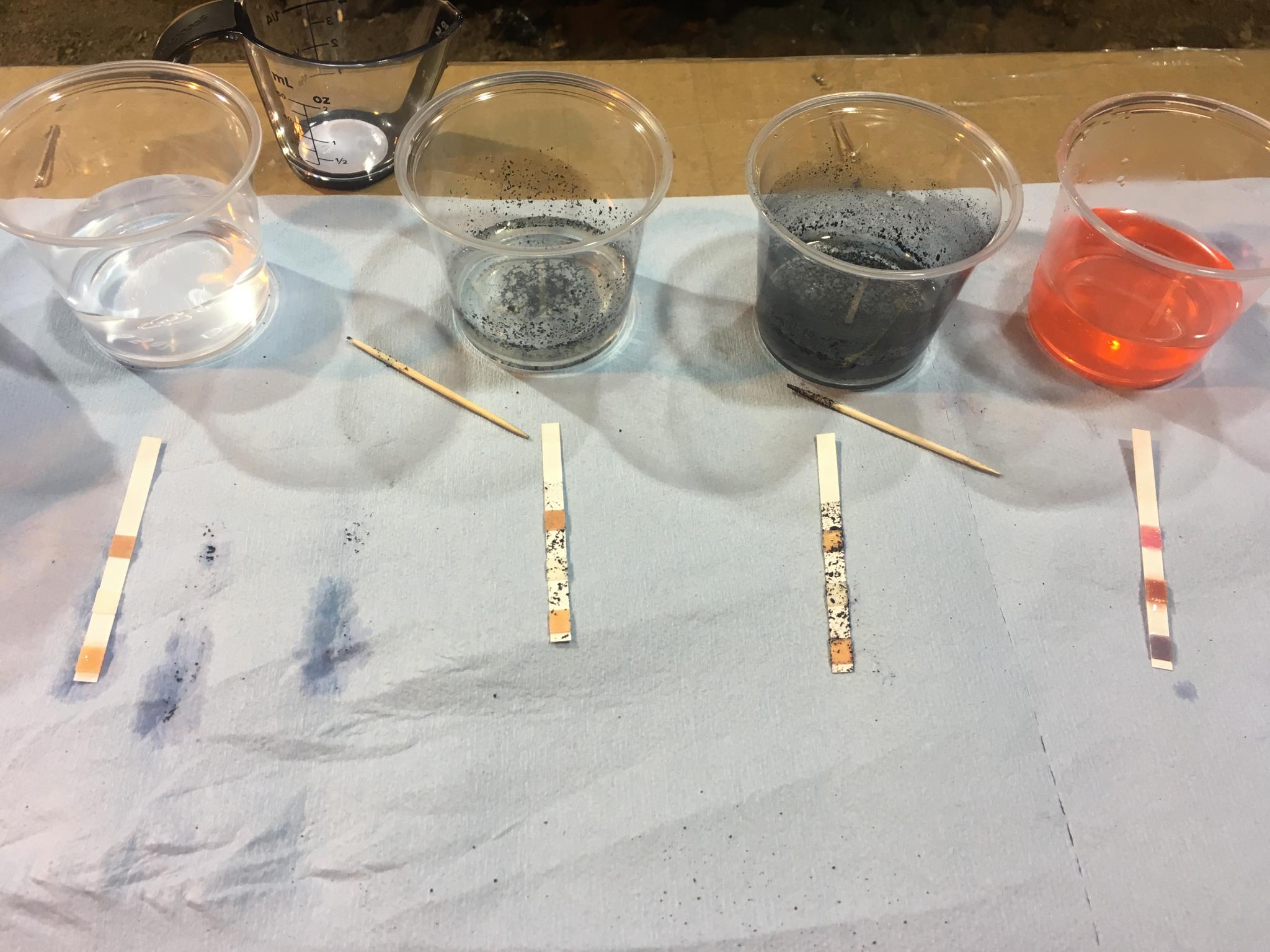

| RE: CM 871 Code 2639, DPF won't clean I did the test found on quickserve using fleet guard coolant test strips mixed with soot from the egr cooler outlet, it is supposed to change color if there is coolant in the soot . I have a baseline of distilled water, 2 samples of soot mixed with 25ml distilled water, and then a sample of the coolant that was taken from the system. Judging by this test I’d say it’s not leaking. Trying to find an adaptor to hook my pressure tester to it next. | |||
