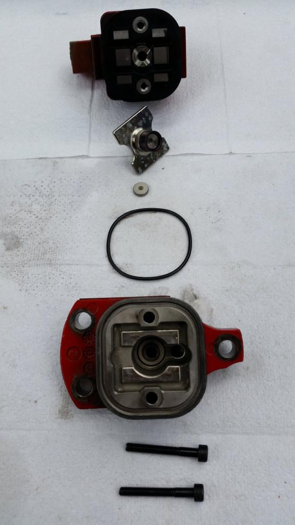

First of all,... they are not that hard to get apart,... and they also like to get small bits of trash in them over time. Taking them apart and cleaning them out is not a bad idea if you are having idle problems, or are loosing fuel mileage, or have rough idle. If you do decide to take one apart, I thought it would be nice to show the order they are put together from top to bottom. This makes it easier to get one back together the right way. Here is the pic,....
./uploads/201603/post_2_1456840277_bb5ff984f87b043aa16daf7c464244b8.jpg
If you take apart more then one at a time,.. Just keep in mind that the Timing Actuators ARE IN FACT DIFFERENT!,... and even the top piece,.. although it looks identical to a fueling (metering) actuator,... is in fact different. You should mark the tops (coil part) of them with a letter "T" for timing, and a letter "M" for metering before disassembling them, just so that you do not mix them up. The guts (plunger, etc.) is the same for both Timing and metering, but the base is NOT. The metering (fueling) actuators have 3 holes for fuel at their base, and the timing actuators only have 2 holes. Cleaning them is easy, brake cleaner does a nice job on them, and even the little check-valve in the base of the metering actuator can be sprayed out to clean it too. Just make absolutely sure they are perfectly clean before re-assembling one, and that the plunger is aligned properly.

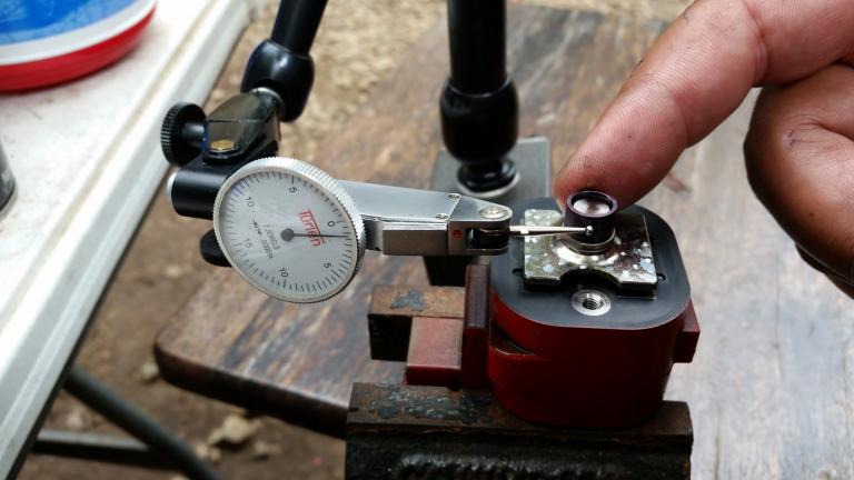

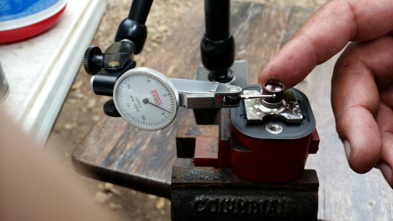

I have tested several, and the main thing that makes them go bad seems to be the plunger that extends into the coil. the shaft of it wears out, and you can see the wear on them if you look at them with a magnifying glass,.. and you can feel a "step" in them when pushing them into the coil (against the spring) using your fingers. this is a sure sign that one is bad,... That "Step" causes just enough delay in the plunger to make the "on-time" comming from the ECM unstable. This makes for for rough idle, or bad timing, and it will also cost you fuel. If it gets bad enough, it can damage the motor, and melt a piston due to excess cylinder pressures!. The amount of wear can actually be measured using a needle-type dial indicator,.. so I took a picture of one that was ok,.. and one that was not. Here are those pictures...
Good Actuator,... Still works ok...

And one that is bad,...
./uploads/201603/post_2_1456840353_9cc86e23a124d704718a07235af5ad10.jpg
- You can see from the pictures,.. the side-play of the plunger is about 0.001" - 0.0012" thousandths of an inch in the one that is not worn out yet (good one). The bad one has about 0.0037 thousandths of an inch side-play. The bad one in this picture was causing the truck to run terrible, so this is a good indication that it does not take much side-play in them at all for them to be bad. YOU ARE NOT GOING TO BE ABLE TO FEEL THE DIFFERENCE WITH YOUR HANDS,.. YOU NEED A DIAL INDICATOR!>
NOTE: Some reman actuators have more side-play than this. I suspect that they simply ground down the step-wear in them to make them work correctly again, so if there is more than normal amount of side play in them.. then test/check them for step wear like mentioned above.. and maybe look at the plungers closely under a magnifying glass before just simply assuming they are bad.
