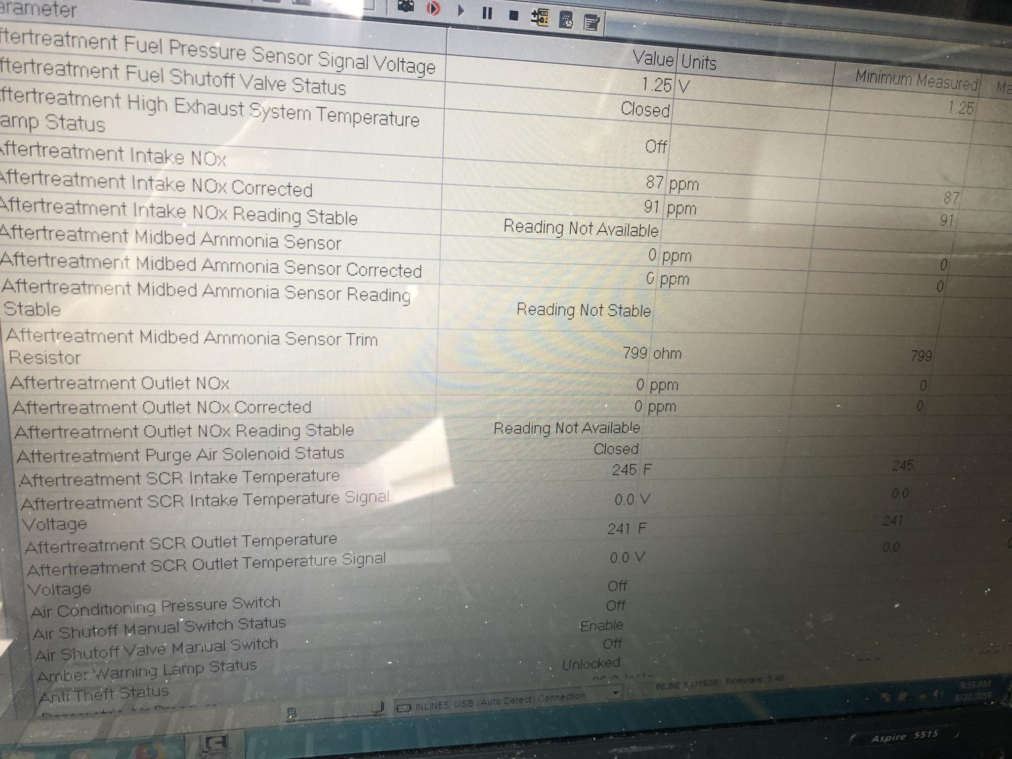

Engine: 2013 ISX15 CM2350
Milage: 550,000
Issue #1:
After getting a 3165 fault code, I was able to get the truck to Lubbock where I met up with SnailExpress. He connected his Insite to my truck and found that the 'Final' temp sensor on the SCR was the one that threw that code because it had read a temp that was higher than allowed maximum. And actually at the time it issued the code it was reading a higher temp than any other temp sensor in the after-treatment chain. Sergye had a possible theory as to why it did that, but obviously no concrete proof.
Is there anyone else with an idea?
Issue #2:
See attached image. The 'Midbed' ammonia sensor stating "Reading not stable."
When we ran a forced regen this was the reading we initially saw. However, as the temps increased and during the majority of the regen that reading for that sensor went to "Reading stable." And as the temps finally cooled back down after regen was complete, the reading went back to "Reading not stable."
For what it's worth, the truck performed almost perfectly during the regen. No hiccups what-so-ever. All readings were good, temps good, everything performing as spec'd.
Anyone have any idea what's going on with that Midbed Ammonia Sensor to give that sort of reading when cool and yet when hot reading correctly?

check the desomp tube for buildup?...

(08-29-2019 )Rawze Wrote:  check the desomp tube for buildup?...
http://rawze.com/forums/showthread.php?t...07#pid1807
On Dec 30 2018:
Doser Valve was replaced
Sensor Replaced
Decomp Tube was fully cleaned
Is it likely that it would be built up again to the point that it would be starting to cause problems?

That said, I'm riding the horse that brought me. And I hear you on all the different parts and pieces and their expenses. As of today, (I haven't hooked it up yet) I have Insite and my Adapter, so I will be able to keep a good eye on things going forward and I'm sure that will only help in keeping things running. I have admittedly spent a lot of money at the dealer since owning the truck almost 2 years ago, but I've reached my limit of no further dear brother. The warranty is great, but everything leading up to the actual replacement of the defective part and the part itself is all on me. And it's rare that a person can go into a dealership and spend less than a $1000. So going forward, IF I go into a dealership, I'm going to know upfront what's wrong and what needs to be done. My hope is that most of the issues I come across I will be able to handle them on my own and I'd be happy if I never had to touch that warranty again.
I can inspect that Decomp tube, my question is this, do I need to remove the Doser valve in order to visual inspect that tube, or can I take a peak with the Doser still connected?
have you registered your engine on quick serve. The procedure for decomp tub is there. It’s no where near the doser injector. You can look through all the part schematics there and kinda get the layout of things.
