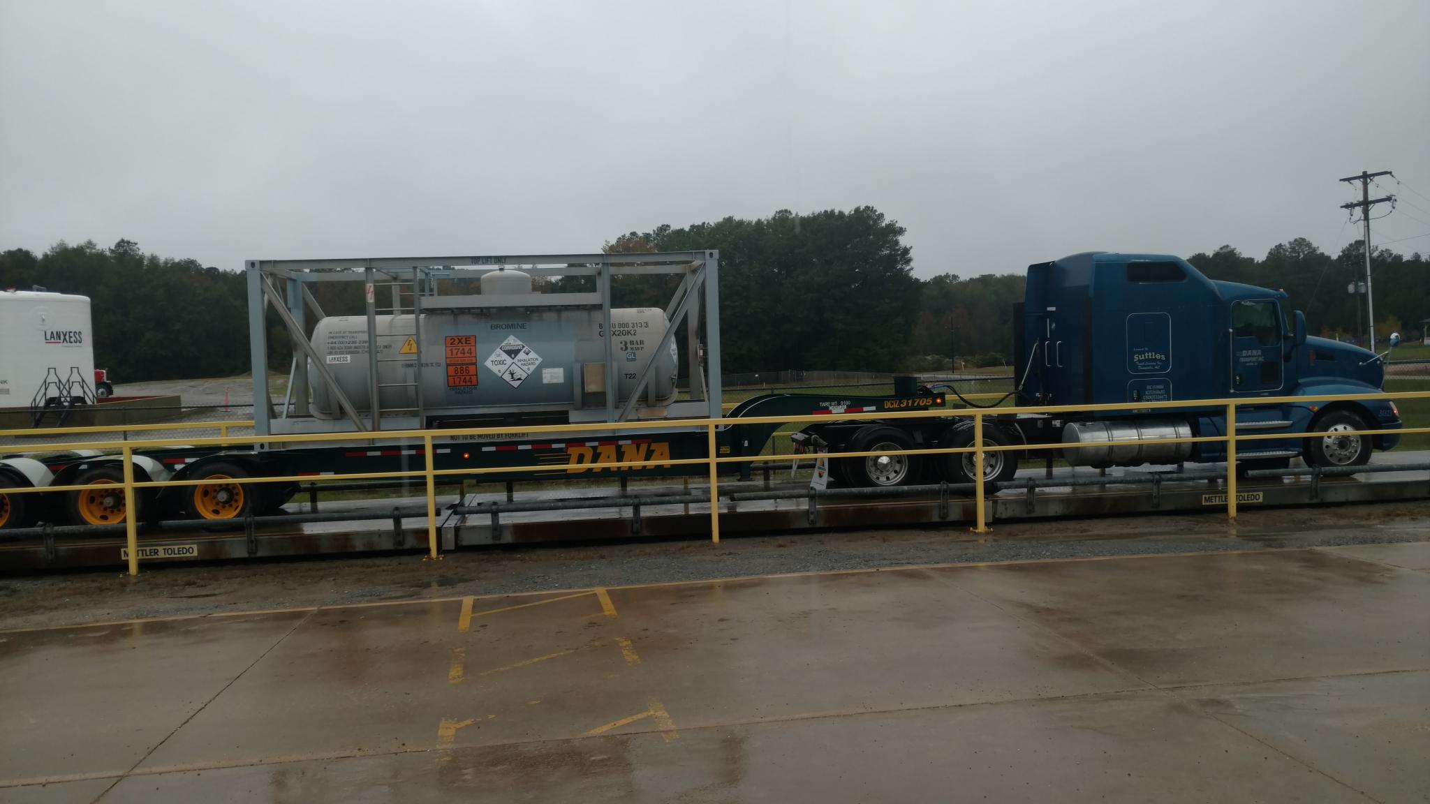

|    11-08-2019, (Subject: ISX450.......unrealistic expectations? )   Post: #17   |  |||
 RE: ISX450.......unrealistic expectations?  (11-08-2019 )hhow55 Wrote: My, My such a small world. I use to pull a lot of hcl, and caustic out of that plant when it was basf. What plant are you referring to? The one in my picture is in South Arkansas. The only product this plant produces is Bromine. They do use caustic for the scrubber. Use HCL but not really sure why, more as a cleaner agent I believe. User's Signature: 2015 Kenworth T660  |  |||
