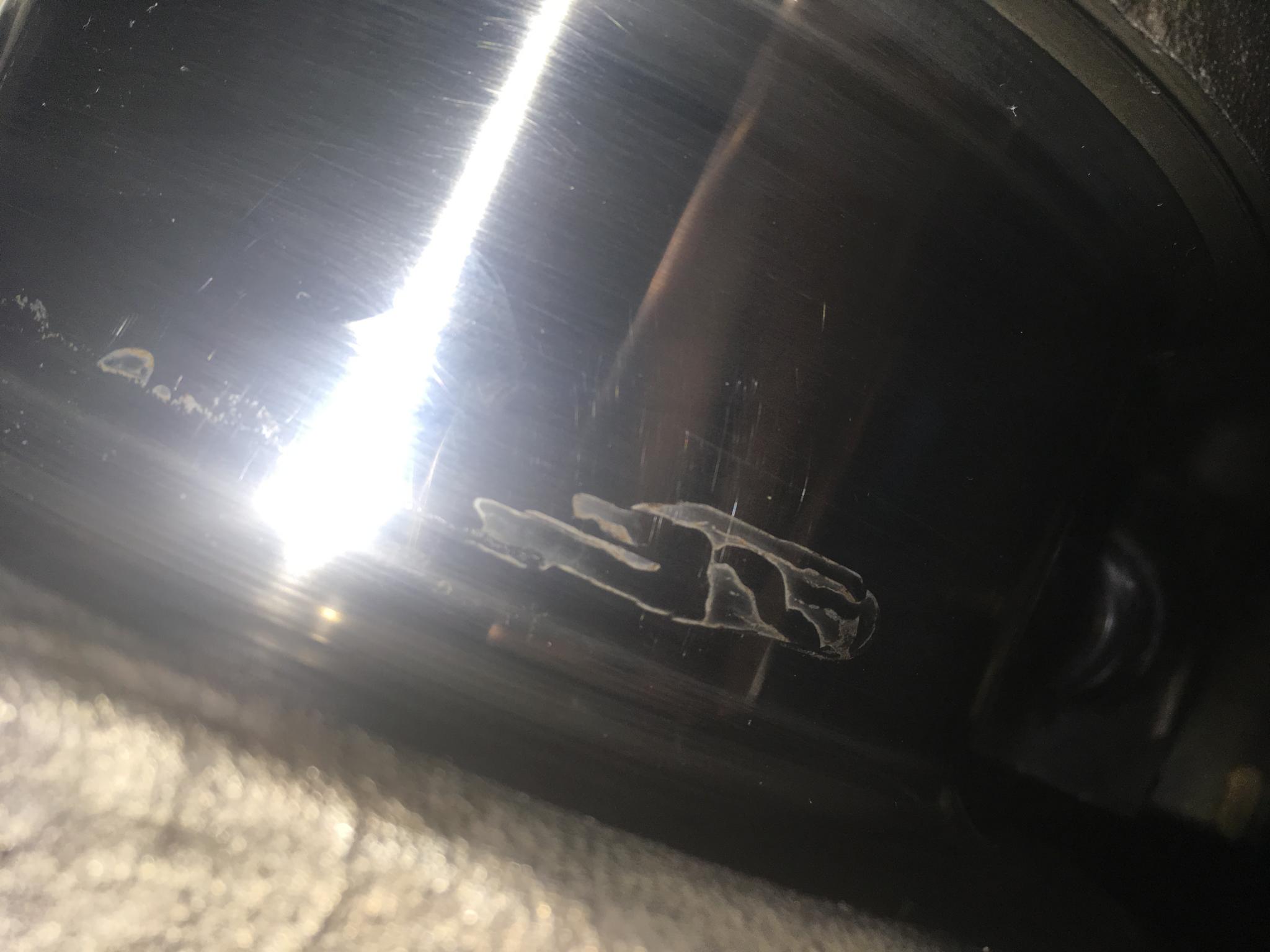

RE: CM 871 Burnt Valve Are u saying thats pitted right there? It looks like something dried on the surface . | |||
04-12-2020, (Subject: CM 871 Burnt Valve ) Post: #24 | |||

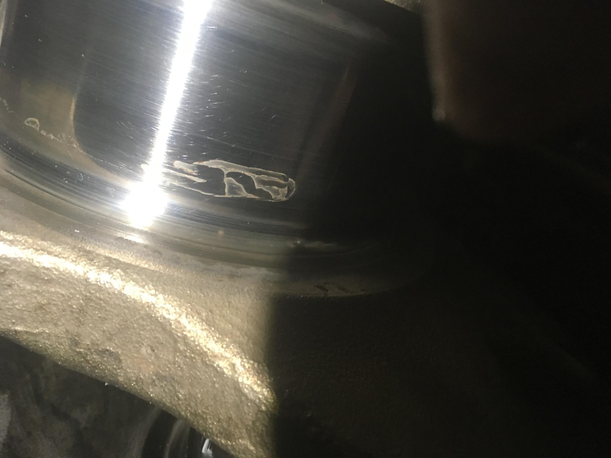

RE: CM 871 Burnt Valve (04-11-2020 )smorgan87 Wrote: Are u saying thats pitted right there? It looks like something dried on the surface . no its definitely a pit, like a piece flaked off, its hard to get a good picture but if you zoom in on the bottom one you can see the 2 shiney pieces they are the same diameter as the journal | |||
04-12-2020, (Subject: CM 871 Burnt Valve ) Post: #25 | |||

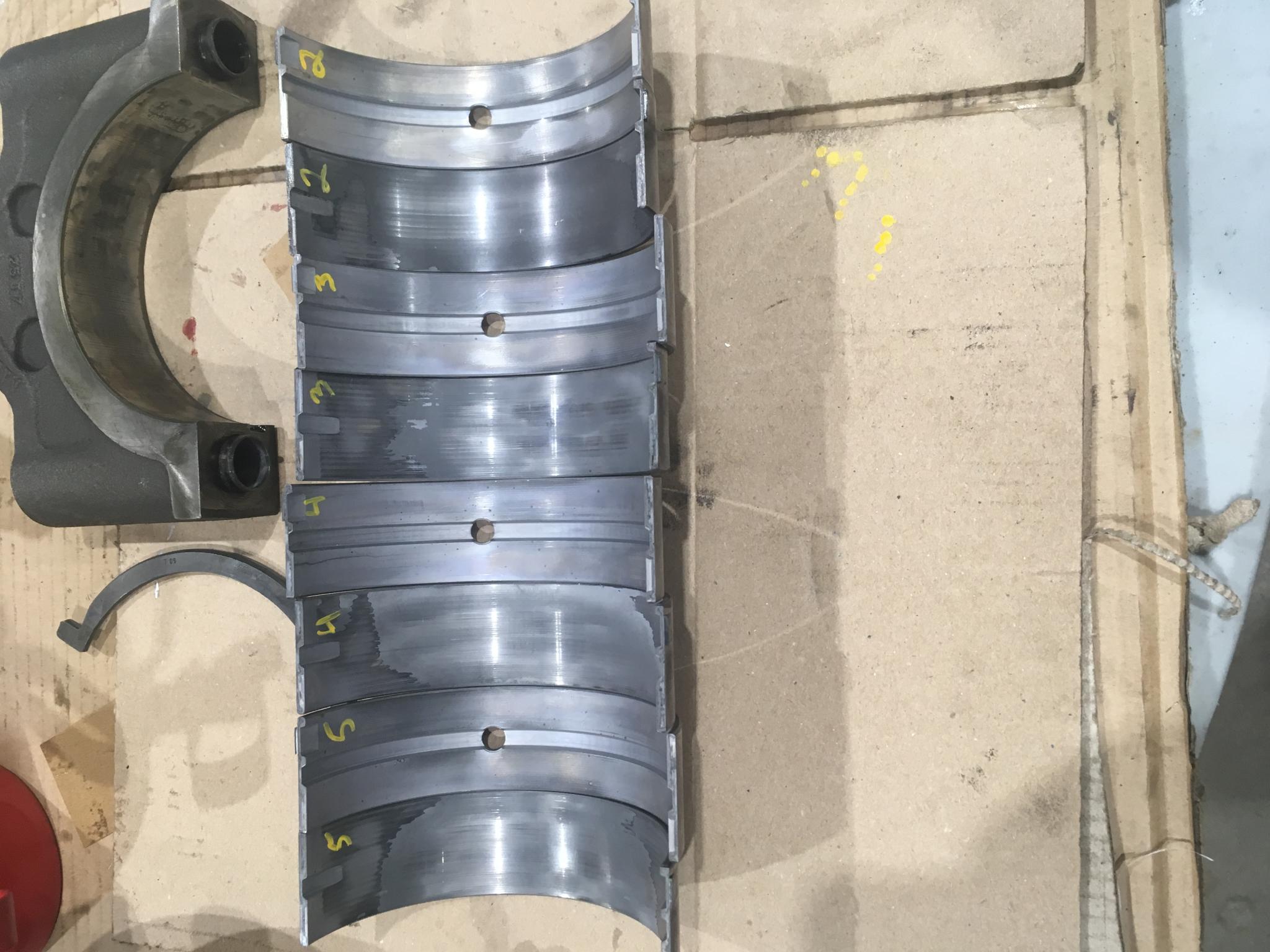

RE: CM 871 Burnt Valve biggest Q would be ... is it in the thrust side of the crank? Or the bottom where there is little to no thrust?. Next would be if it can be polished with a dremel + wire wheel to remove / dull its edges?. Last would be to determine how long it likely has been like that?. What did the bearing look like that came out of it?. If it happens to qualify by .... Not being on the thrust side of the crank, Looks like it has been there a very long time, bearing that came out was acceptable, and a simple wire wheel can clean it up a bit,.. personally, I would just polish it a bit and go again. Check it in 100k miles to be safe and to ensure it was not causing excessive wear to the bearing ... but that is just me. User's Signature: ->: What I post is just my own thoughts and Opinions! --- I AM Full Of S__T!. | |||
04-12-2020, (Subject: CM 871 Burnt Valve ) Post: #26 | |||

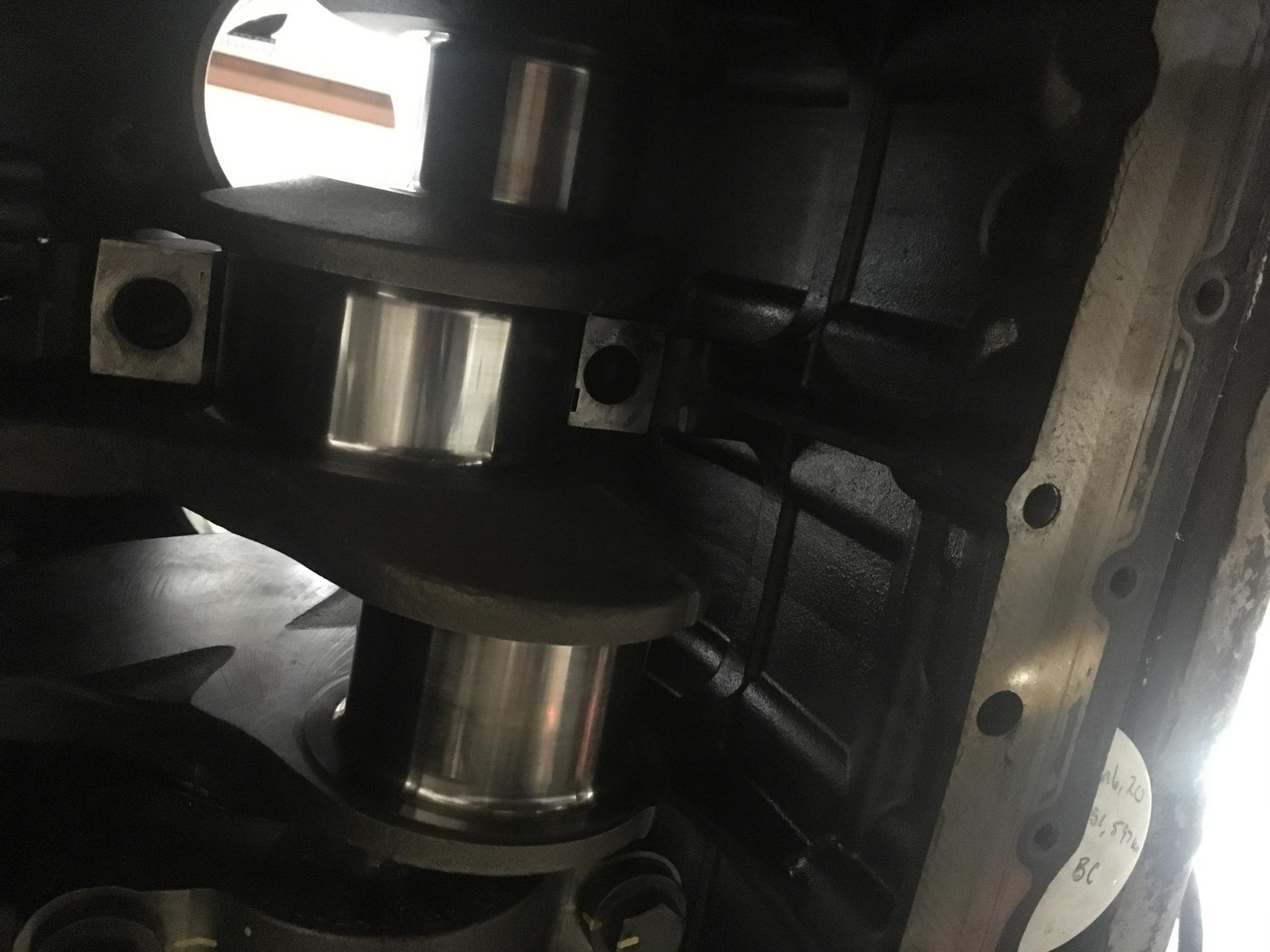

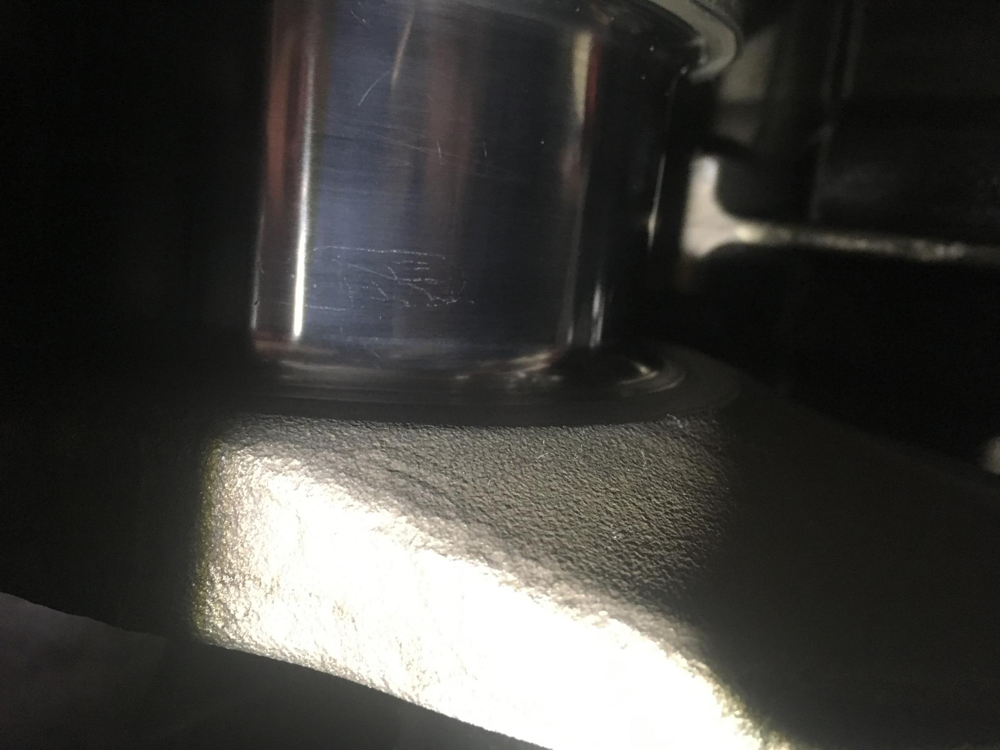

RE: CM 871 Burnt Valve Happy Easter Everyone Thanks for the suggestion Rawze. Morgan87 i was mistaken. When i looked at it last night i could have sworn and it felt like there was a nick. This morning following Rawzes suggestion i started with scotch brite enden up going 400 grit then 600 grit then scotch brite and finished of with fine crocus cloth. I'm feeling a lot better today. What ever it was still left a mark. Rawse im not sure about the thrust , If cyl 4 is at TDC then this mark on the 5th main is at 10 oclock and the rod journal for 5 is down at 4ish. I attached a picture of the mains that i have done so far. Thanks Again. | |||
04-12-2020, (Subject: CM 871 Burnt Valve ) Post: #27 | |||
RE: CM 871 Burnt Valve The cleaned up journal looks good to go. The removed bearings are also quite tidy | |||
