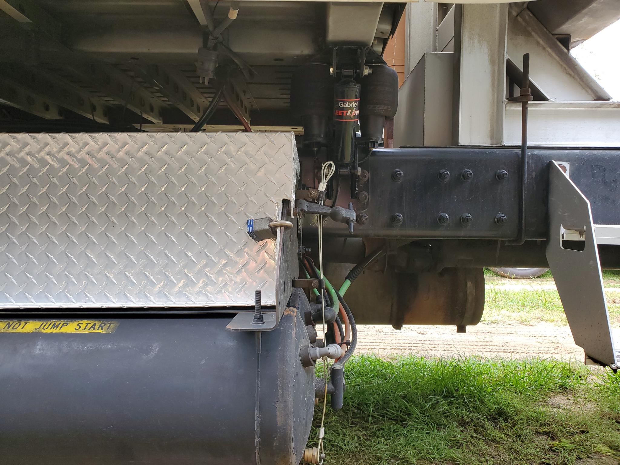

| RE: ProStar Sleeper Cab Airbags... (05-21-2020 )74bassman Wrote: I'm looking at replacing the bags this weekend. i'm just looking into other options.I put my Proride on my 08 in the driveway almost a year ago. It was easy to install by myself and didn't take long. The ride, my truck did have a pretty good ride before. The cab bushing have been changed as well as the rear motor mounts. The front springs have been replaced with new heavier springs and bushings from a place in Pa. I also replaced the four inch blocks in the front for inch and half lowering the front. Plus it's stretched to 296 center of drives. I run good made tires and centramatics truck and trailer. So with the Proride it's hands down the best riding truck I have ever been in and I have been doing this for over 30. To me it's a no brainer, two bags and one shock on each side. Plus mines heavy, tools, roof mount ac, all kinds of extras and two big dawgs most of the time. | |||

| RE: ProStar Sleeper Cab Airbags... (05-22-2020 )74bassman Wrote: I order the system this morning.Did you get it from the guys at Custom day cab? That's where I got mine. It's really pretty easy to install even though I have a headache rack in the way.I used two small jacks, one on each side. I did use a air gun to get the old ones off. Like I said before I did it by myself. | |||

| RE: ProStar Sleeper Cab Airbags...  I'm going to do the install in my driveway. Anyone who has done this install have any pointers or suggestions?  | |||

| RE: ProStar Sleeper Cab Airbags... (05-23-2020 )74bassman Wrote: I'm going to do the install in my driveway. Anyone who has done this install have any pointers or suggestions?I used a small jack on each side and a air gun. I removed both of the old ones first to get some room. Then I installed the center piece first because of my headache rack. Then I installed the bags and shock set up. The passenger side bolts on mine are behind the can so tough to get to. Everything I needed was in the kit for the air lines. It's a nice set up, Rawze had a video of I believe his install. I watched it so I had a good idea about it. | |||
