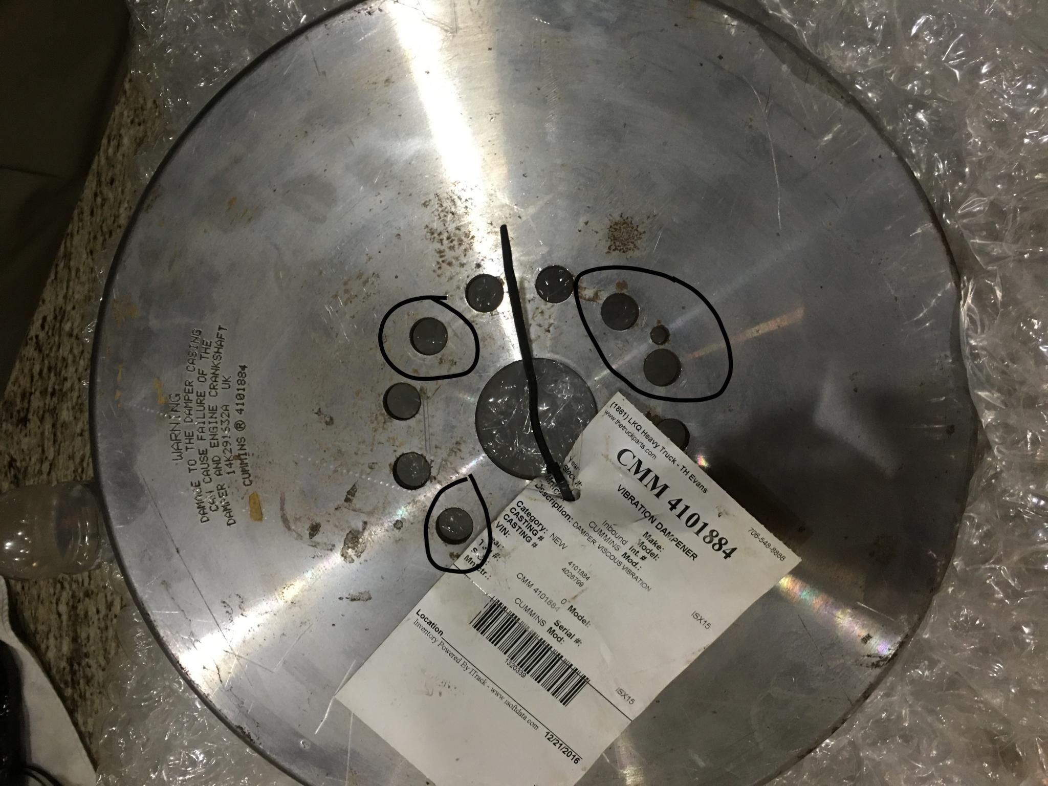

(10-26-2021 )SquareOne Wrote:  The damper arrived last night. Opened up this am to find this a fairly roughly handled ‘new’ part. Looks like it’s been hanging around for the last 5 years at someone’s shop... Not so much worried about the surface rust as I am some of the damage that’s on it from transport through the years. Has some scratches (that could be sanded out) and a couple places where it has definately contacted cement ( maybe when standing it up to get ready to place it on a shelf). I’m sure it will still function as it should. However, I would def be rejecting this if it were placed on front of me at my local Cummins store.
- If I'm understanding correctly, the fluid inside the damper hardens, therefore it becomes ineffective. Cummins maintenance calls for a 500k replacement, but my question is does the fluid harden because of use or does it have a shelf life? This part I just received for example appears to have been on the shelf for nearly 5yrs according to the stock tag. Would that shorten it's effective lifespan even though it hasn't been installed?
Here are some pics. Any thoughts? Already contacted FinditParts and sent them an email with the condition.
THAT IS A USED PART... DID YOU INTEND TO BUY A USED ONE?
There is no telling how many miles are on that thing.. It looks like a WHOLE LOT! .. someone stripped the pain off of a replacement damper right off an engine somewhere, and half-arssed cleaned it up.. then stuck it in a box.

LKQ lately has been selling "New" harmonic balancers on eBay.... Every one of them look to be taken off the truck and stripped of the paint.
I circled where it looks like the bolts made their mark when tightened.

(10-26-2021 )Rawze Wrote:  THAT IS A USED PART... DID YOU INTEND TO BUY A USED ONE?
As far as it being used, I def did not intend to buy a used part. I did notice the markings around the mounting holes which made me question it as well. Never removed one before, so I assumed (with the frequent difficulty of removal) it would have much more scarring around the mounting holes, center bore, and rear portion where it would be in direct contact of the crank. Didn't even consider they would've stripped the paint though....that's pretty chicken shi#t and they should be held accountable if that's the stuff they're trying to pull.

I don't know.......... how would they strip that paint off so clean? There's not even a spec of red and it wasn't media blasted. The writing is absolutely perfect, not eaten away by rust. Maybe you guys are right but I'm not so sure. It looks like surface rust from being stored in a plastic bag (condensation) maybe somewhere that wasn't temperature controlled.

(10-27-2021 )tree98 Wrote:  I don't know.......... how would they strip that paint off so clean? There's not even a spec of red and it wasn't media blasted. The writing is absolutely perfect, not eaten away by rust. Maybe you guys are right but I'm not so sure.
not sure but that is DEFINITELY A USED PART!. it is blatantly obvious!. And it does not look like somethng someone had installed for a few days and sent back.
