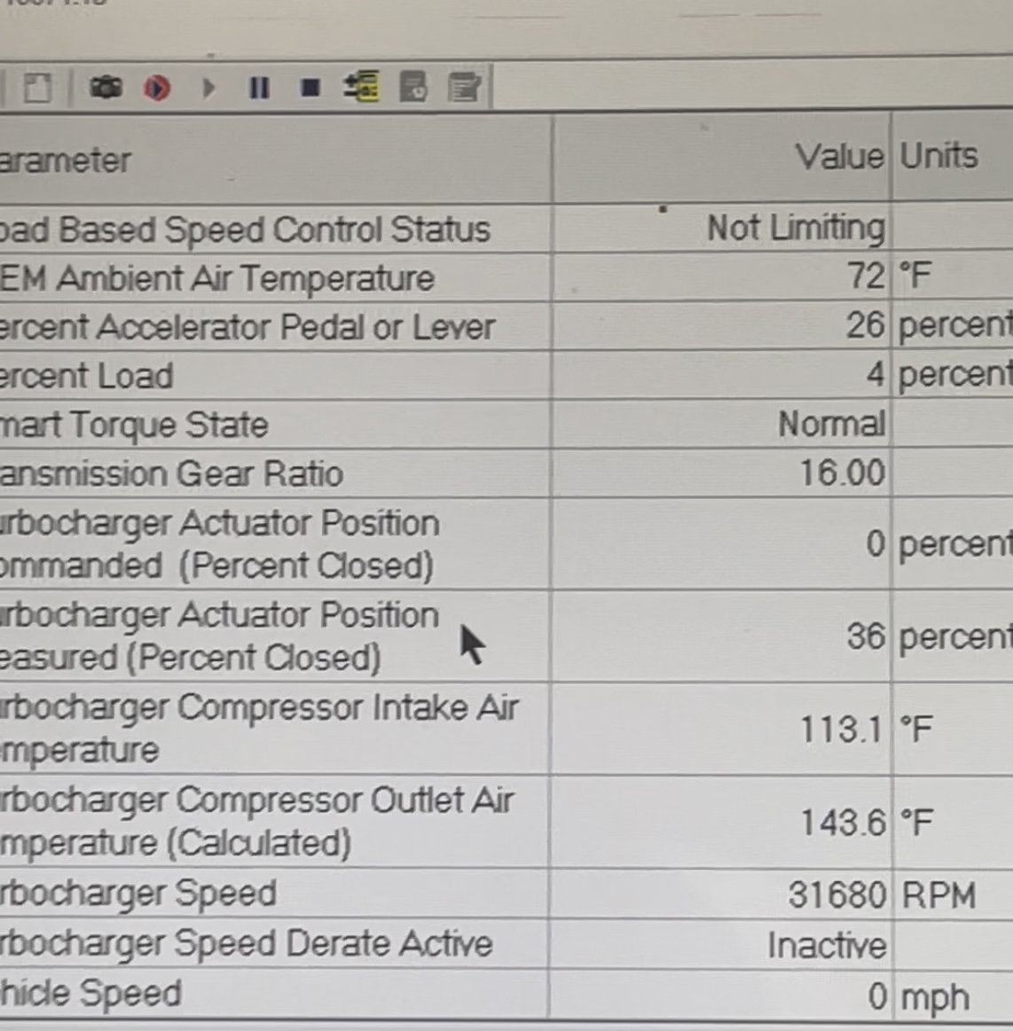

871 Low Boost / VGT Commanded Kinda jumping gun here but wanted to throw this out there see if anyone else has input that might help CM871 - 2010 - International ProStar DayCab - ECM has M&M was done year ago and truck has been fine since then. Now Low Boost, will only build 8-9 Lbs. Replaced Turbo(turbo would not calibrate) , Calibrated during install etc. New turbo had no problem calibrating as the old turbo did so did not replaced the Actuator. Now noticing Turbo Actuator Position Commanded is reading 0 !! NEVER MOVES DURING OPERATION Turbo Actuator Position Measured is reading 48% at Idle , 1800 RPM went down to low as 27 % Going to replace the Actuator and check the plugs/wiring. Any other ideas or thoughts. Thank you | |||

RE: 871 Low Boost / VGT Commanded Update and Correction - Did not have solid connection eariler J1939 is Ohm 60 When unplug the Actuator at the J1939 120 Ohm Plugged the J1939 back up - Unplugged the Actuator and measure the actuator itself 120 Ohm Now where the actuator plugs into the harness on Passenger side is reading 171-173 Ohm Both Terminating Resistors have been checked - 120 Still have No fault codes and When monitoring from in-site still getting zero on Parameter - Turbo Actuator Position Commanded I cannot imagine anyone has tampered with this ECM, but going to double check that. It has OG 871 M&M with no changes made from the OG M&M | |||

RE: 871 Low Boost / VGT Commanded In a hard pull?... and what positions is turbo "measured" going to?... how much boost?. and what is the fuel flow doing?... and what is the engine state parameter saying?... and what is the turbo RPM reading?. If the "measured" is responding properly then you may just be barking up the wrong tree by looking at the "commanded". sounds to me like you have a massive boost leak (or exhaust restriction, etc.) somewhere?. User's Signature: ->: What I post is just my own thoughts and Opinions! --- I AM Full Of S__T!. | |||
