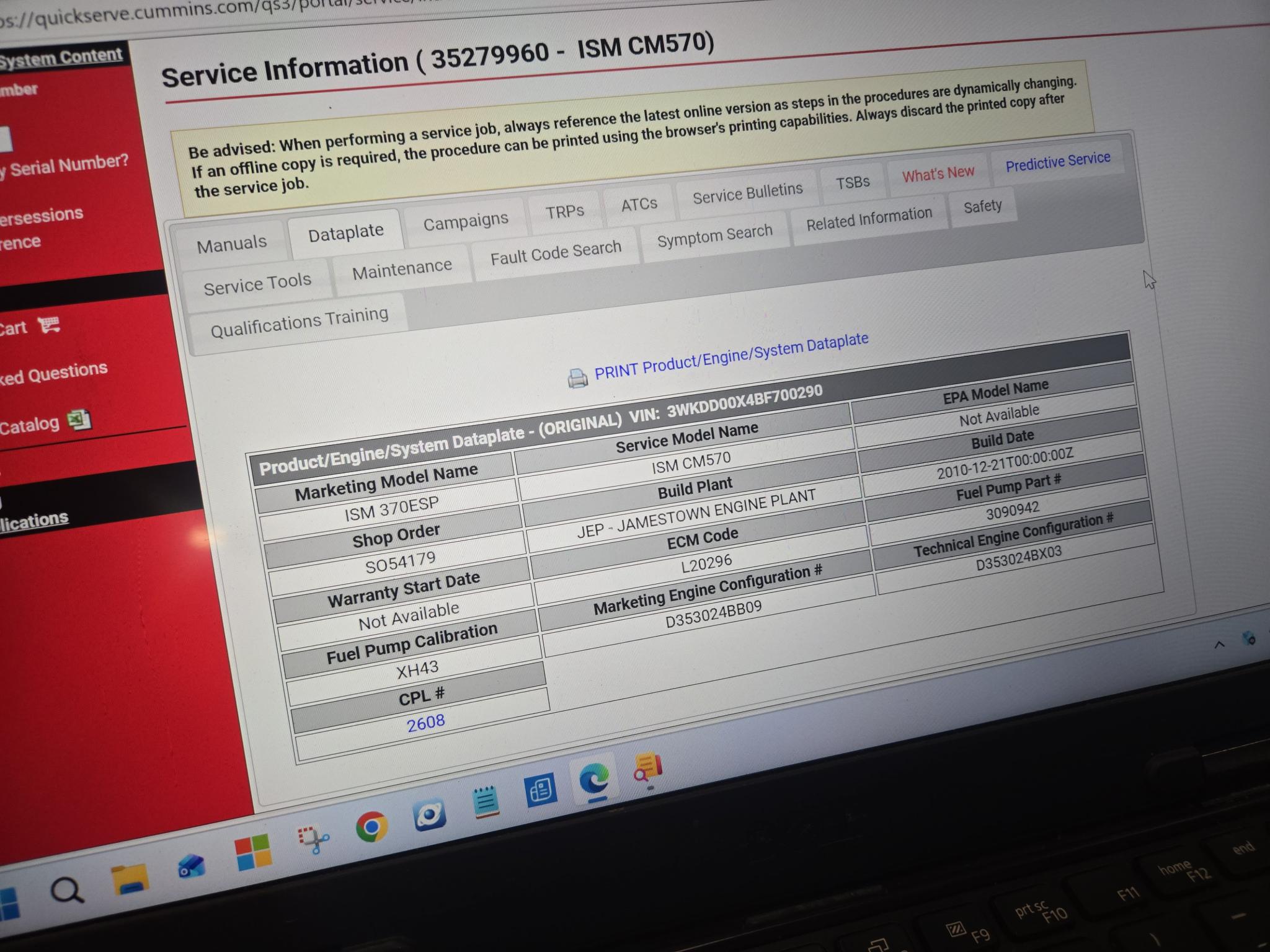

ISM & M11 basically the same engine. My old freightliner year 2000 had one in it. 330HP ESP.
Very reliable stout engine. Here is the data plate off quickserve, maybe it helps you in some way.

From what I could tell you have an M11 longblock with CM570 controls. Please understand that this calibration has three different variations for an auto trans and different power curves. I'm assuming you're linehaul with a manual transmission.
Here is what I came up with:
ECM# 3681405
Current calibration:
L20302.37 330HP 1250TQ at 1,800RPM
DO: 02103
SC: 20069
FR: 02584
CPL: 2607
Replacement calibration:
L21133.16 330HP 1250TQ at 1,800RPM
DO: 02103
SC: 20076
FR: 02657
CPL: 2607
You should be able to download that calibration off QSOL. If not, PM me and I'll send it to you.
