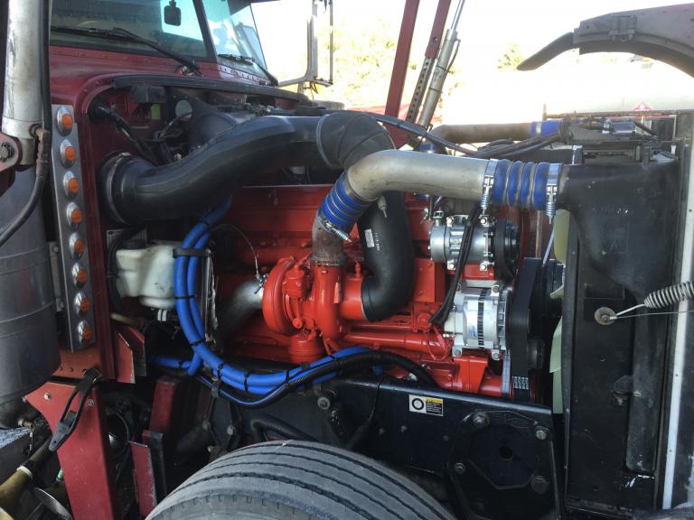

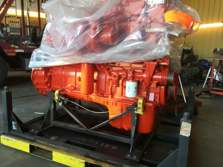

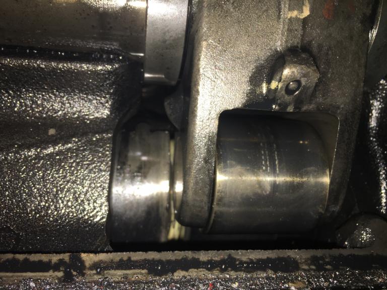

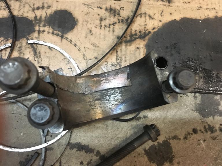

RE: New motor time! Its been a busy few weeks but I'm finally about done with my truck. I'll try and attach a few pictures. The oil pump failed and made a serious mess. So Cummins reman crate motor it was. Plus new clutch motor mounts radiator bushings. Every coolant line and clamp replaced. Power steering pump rebuilt. Every fuel line and diverted valve changed. New FASS pump. New radiator new AC condenser. New u joints. New brakes S cams, bushings, slack adjusters, wheel seals, drums. New fan hub and fan and belts. New alternator and AC compressor. New Receiver dryer and expansion valve in the sleeper. 4 new shocks in the rear. 2 new tourque rods. 2 new frame extensions on the front(common to break on the front of car haulers with masher bumpers) PTO resealed and spines greased. Every exhaust clamp changed(dual stacks). 4 new LED headlights and 4 new marker lights in the masher bumper. Suspensions mounts(rear) disassembled inspected and reassembled with anti seize so it can be taken and aligned before it goes out. I still have a bypass oil filter to install. | |||
10-03-2016, (Subject: New motor time! ) Post: #23 | |||
RE: New motor time! Sure are pretty when they are new. | |||
10-03-2016, (Subject: New motor time! ) Post: #24 | |||
RE: New motor time! Cam bearing pushing out of the journal. | |||
10-03-2016, (Subject: New motor time! ) Post: #25 | |||
RE: New motor time! #4 rod cap. Melted bearing. The cap had to be beat off the crankshaft with a sledge hammer. | |||

10-03-2016, (Subject: New motor time! ) Post: #27 | |||
RE: New motor time! Mostly done. Sure looks good. | |||
