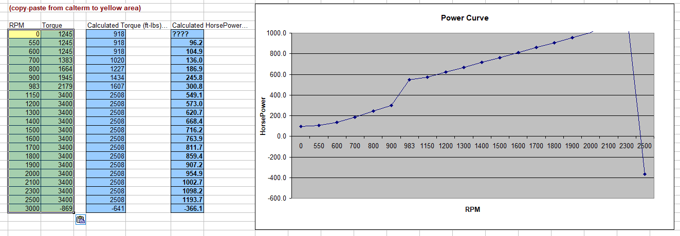

== Someone has completely destroyed the power torque curve for the engine. The power/torque curve has been completely destroyed. It has been set to an engine killing 1000+HP, and 2500+ ft.lbs torque. I guess someone wants to completely destroy this engine rapidly. It was also done incorrectly and in the most harmful ways possible.
Looks like a kindergartner made this complete trash!!...
./uploads/202506/post_2_1750100619_5dd31172b0c60ab13ab10c182961e936.png
(right click, view image to see larger image).
