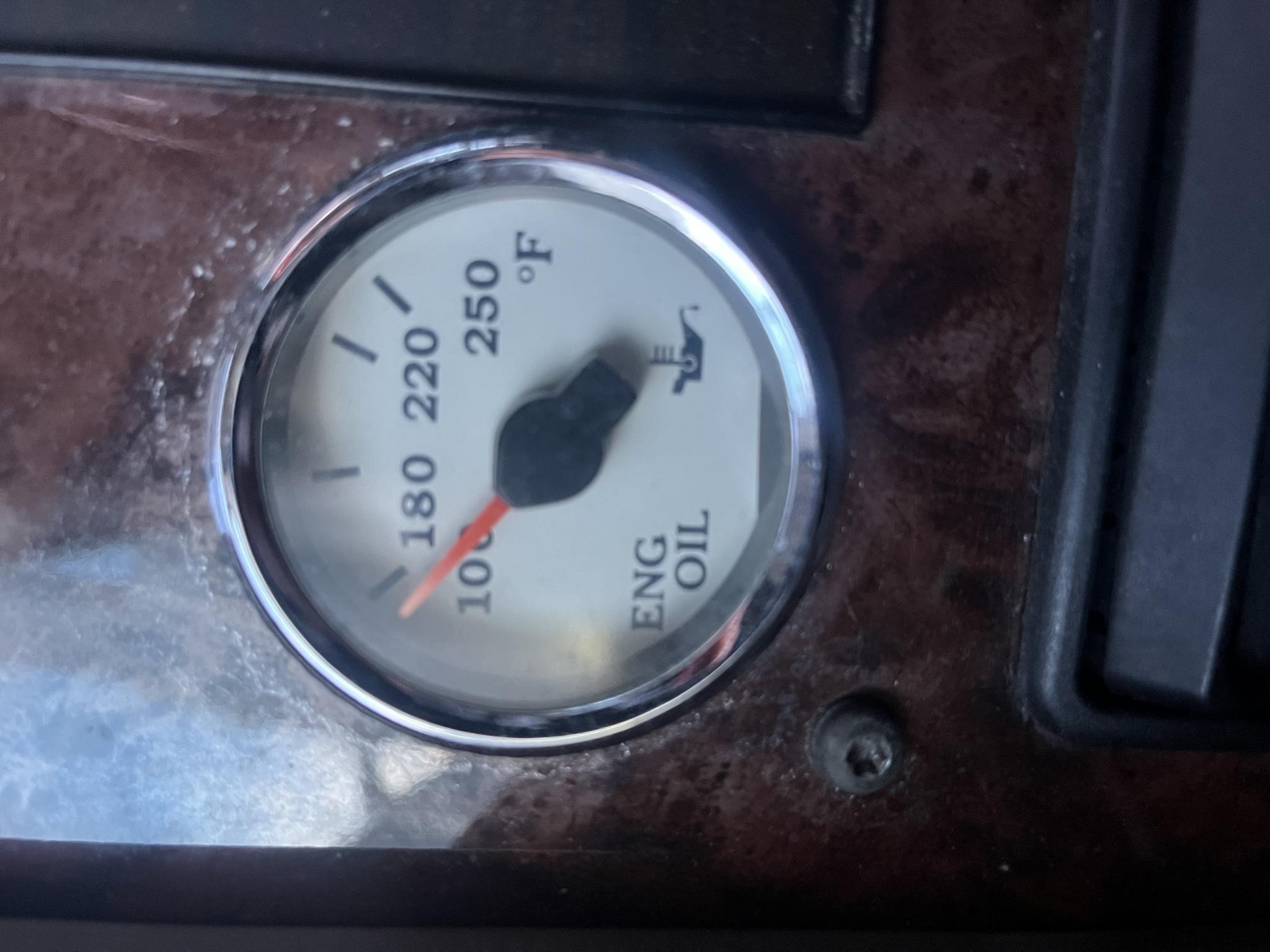

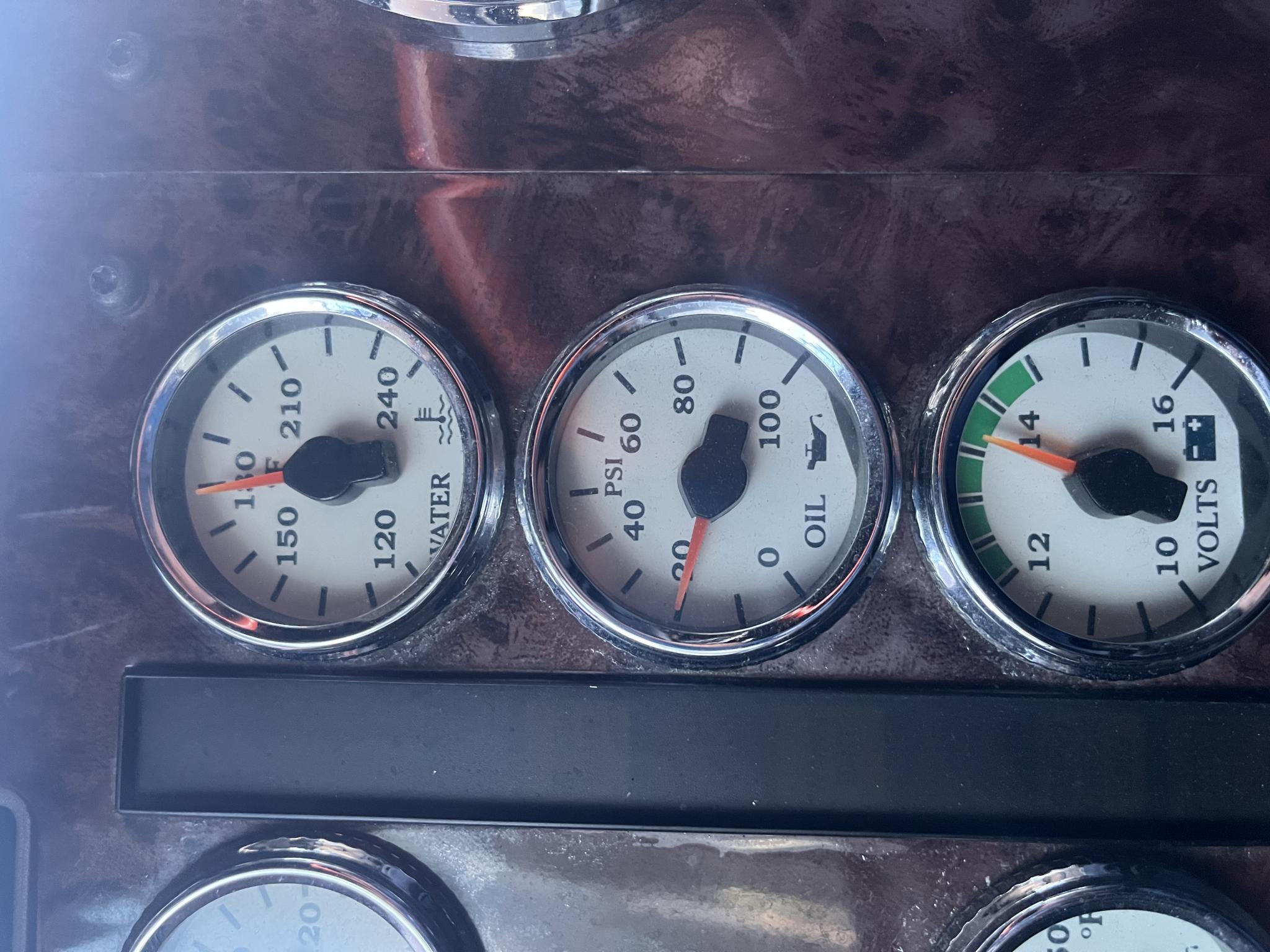

Well my water temp was normal and my oil temp didn’t spike or anything. This is an image before i shut it down to cool off
