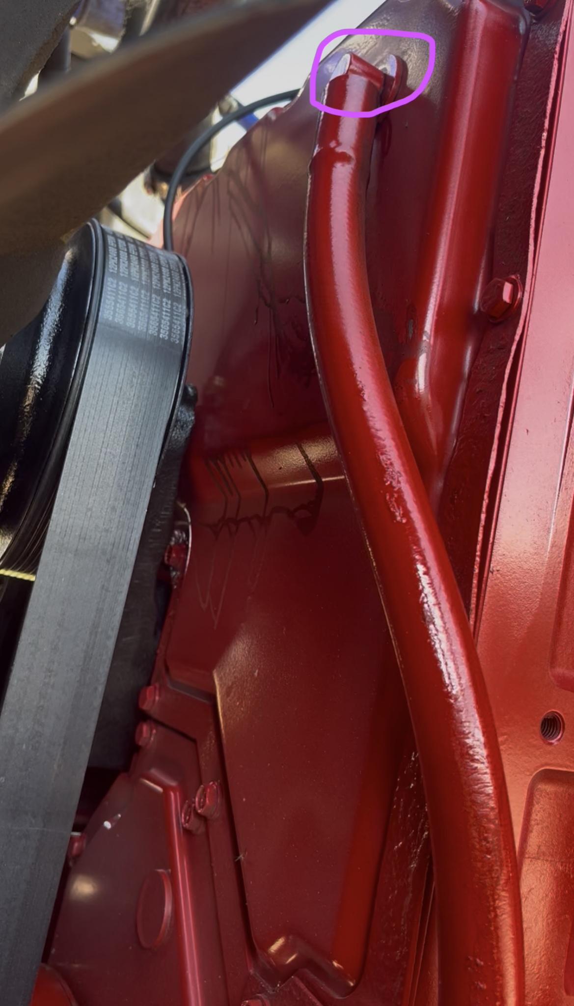

| RE: Front structure seal Change the breather gasket too and save you some time if you don’t mind. Mine leaked after | |||
| 01-25-2026, (Subject: Front structure seal ) Post: #8 | |||
| RE: Front structure seal Ok thanks I’ll look into that it wasn’t leaking beforehand. Never thought about just removing the filter and running the tube down. Thanks User's Signature: 2010 kenworth t800 isx500hp cm871 13spd 3.55ratio | |||
| 01-25-2026, (Subject: Front structure seal ) Post: #9 | |||
| RE: Front structure seal I don’t think it was leaking before | |||
