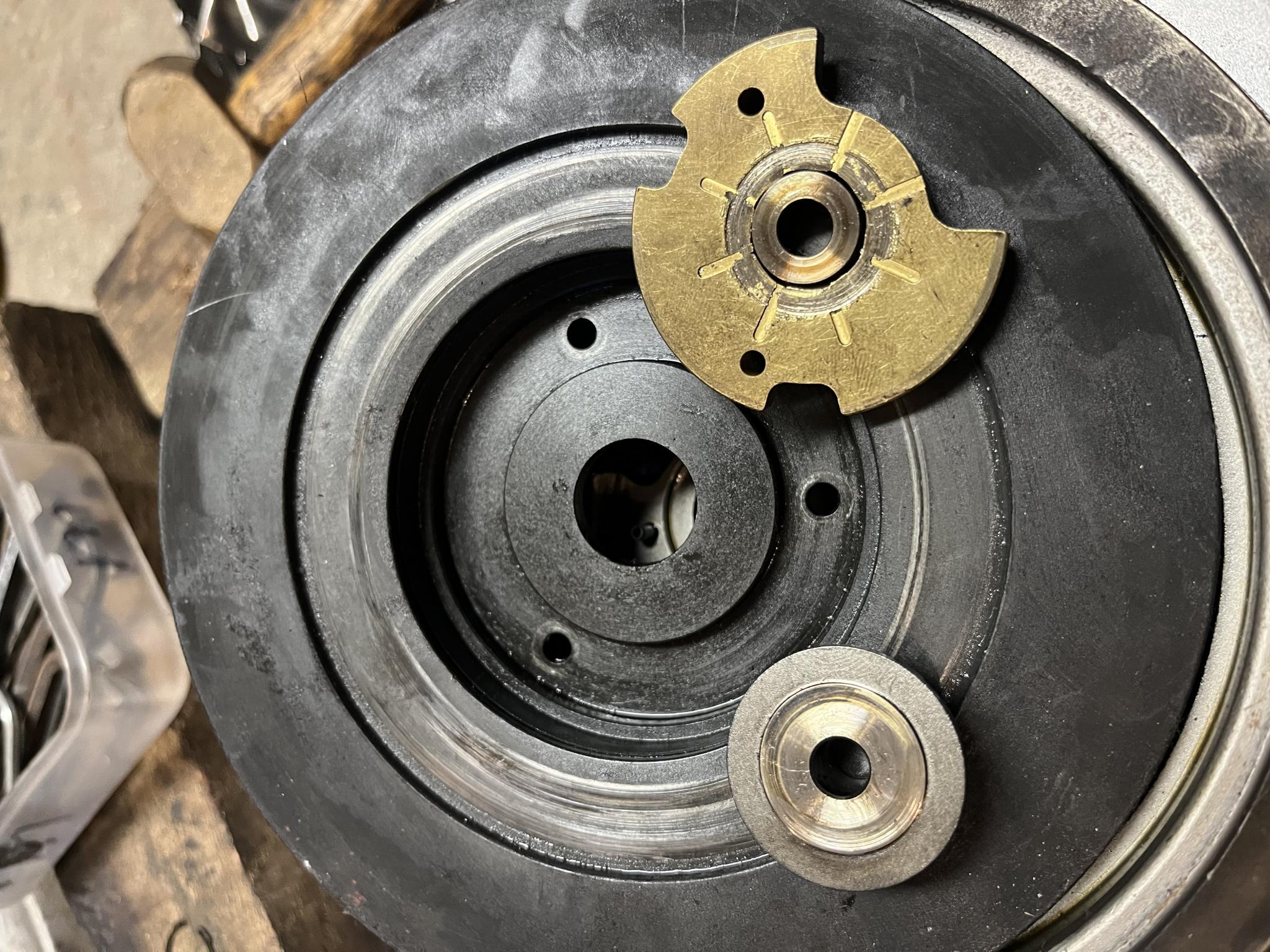

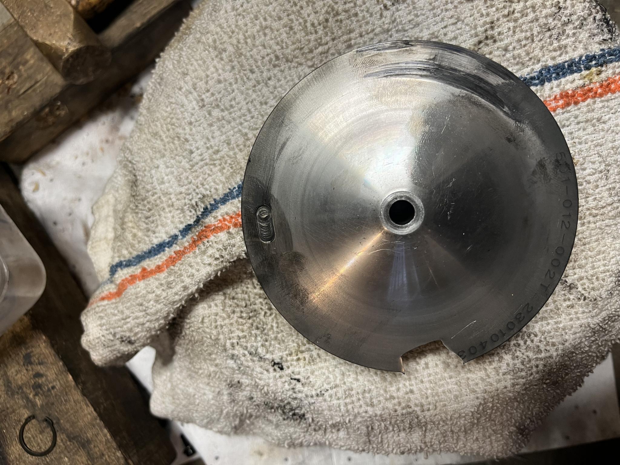

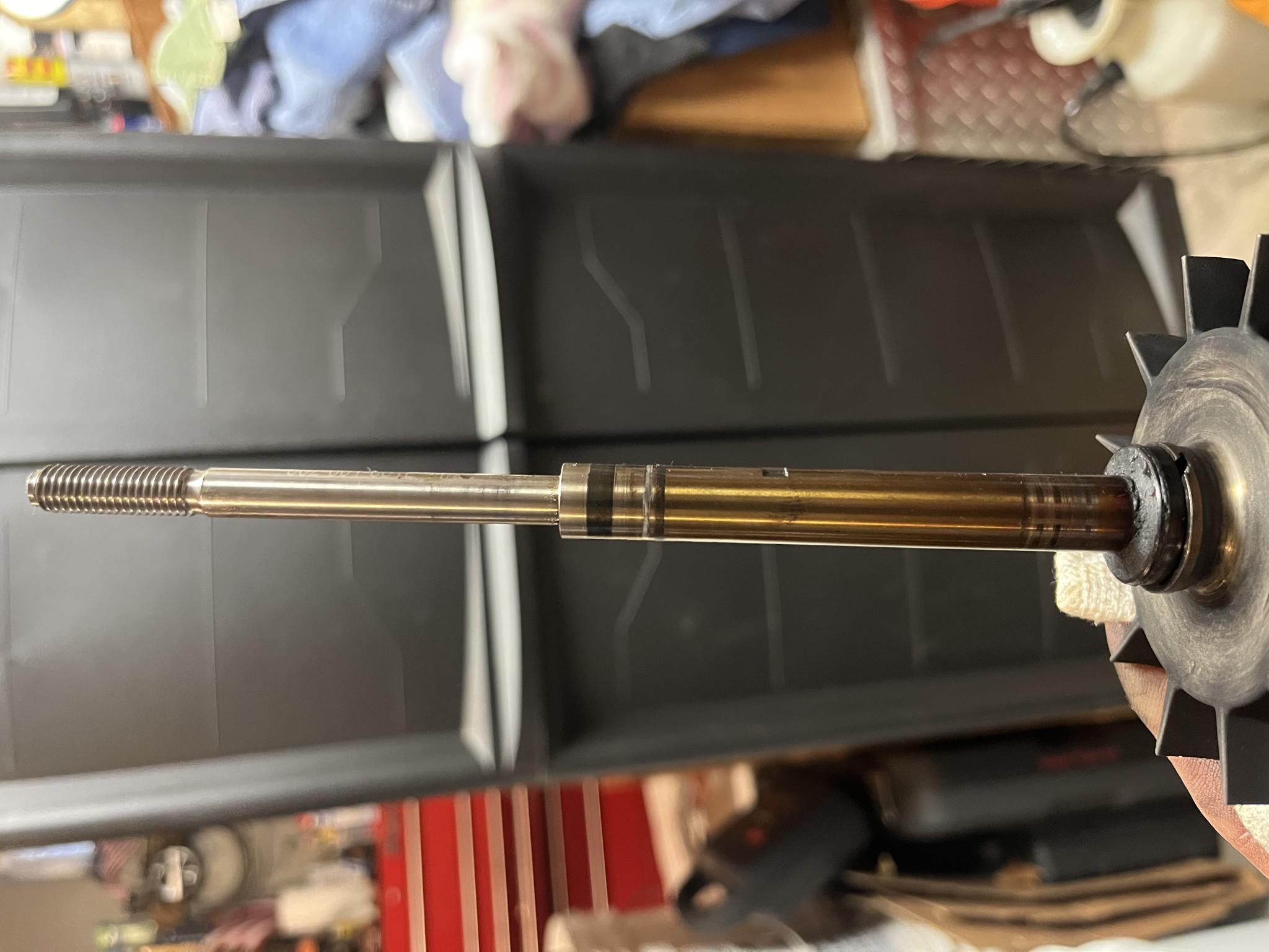

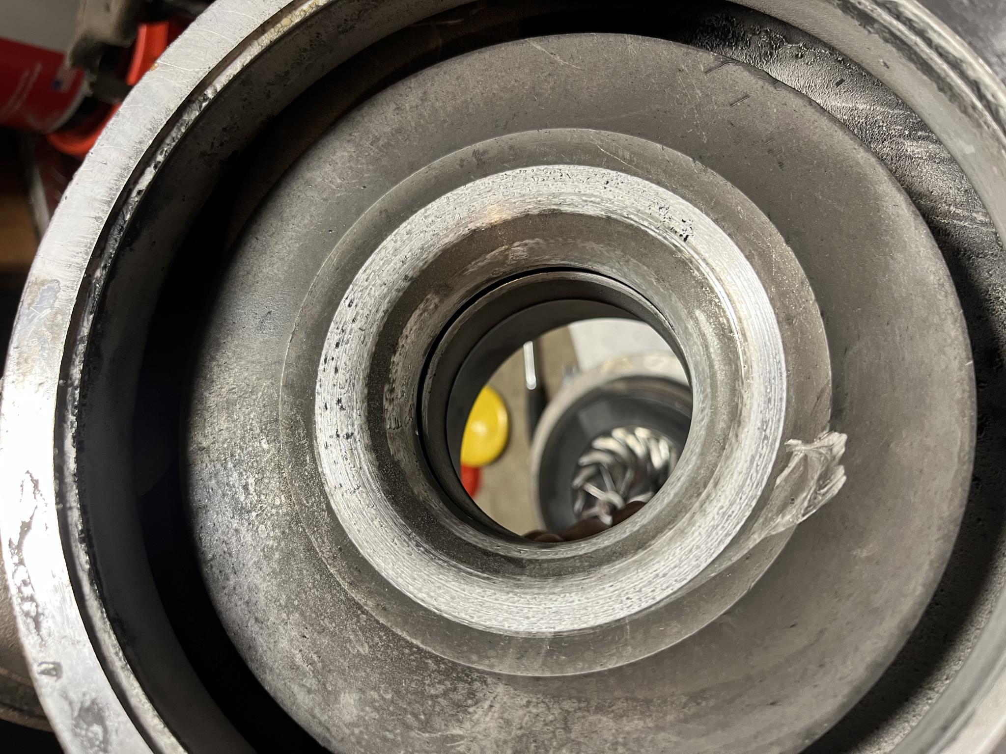

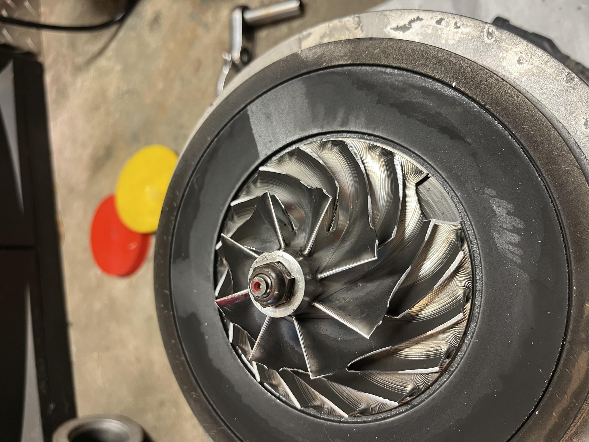

Preliminary findings: shaft is warped which caused the damage. The bearing parts have wear. The vgt works fine. There was plenty of oil in there.

Some photos

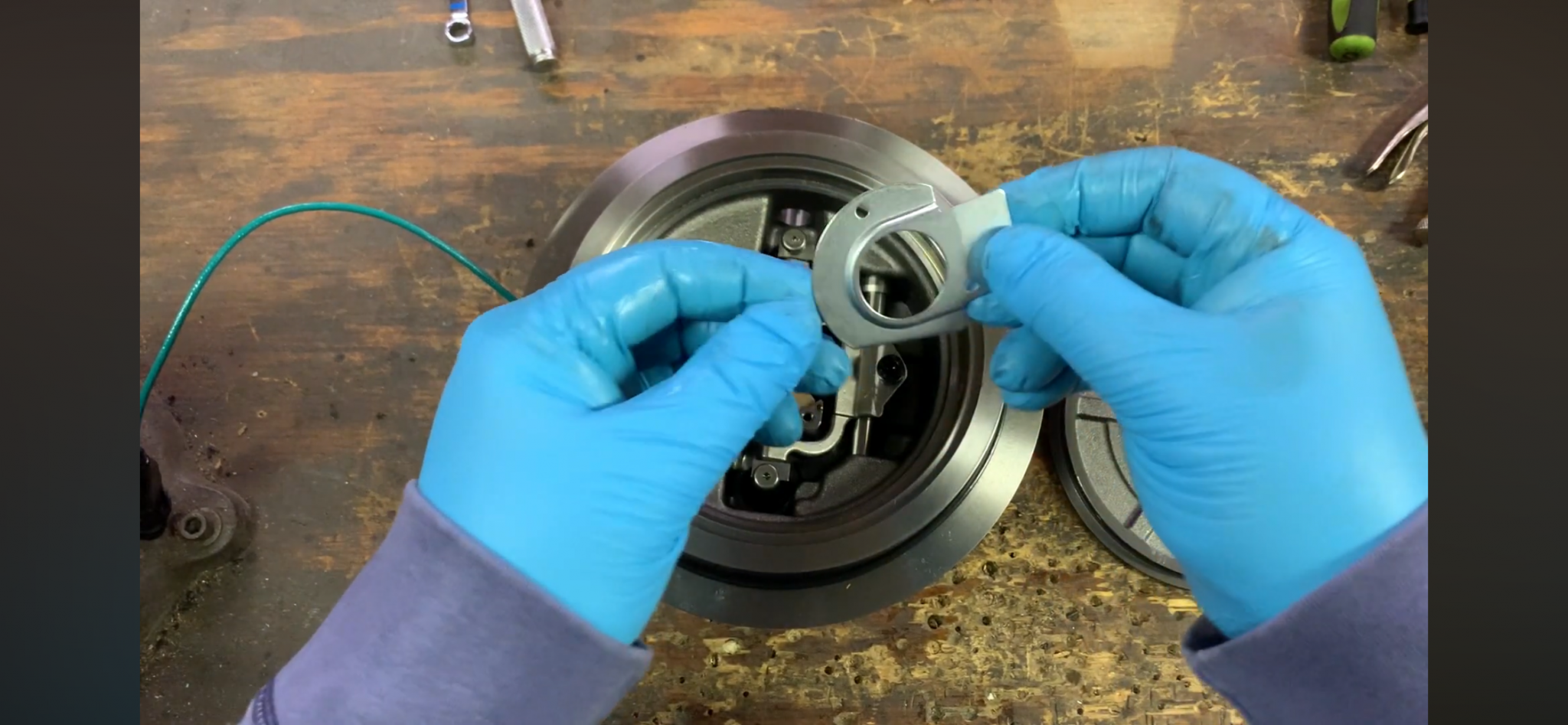

RE: CM871 turbo premature bearing failure
Mine did not have this piece.
