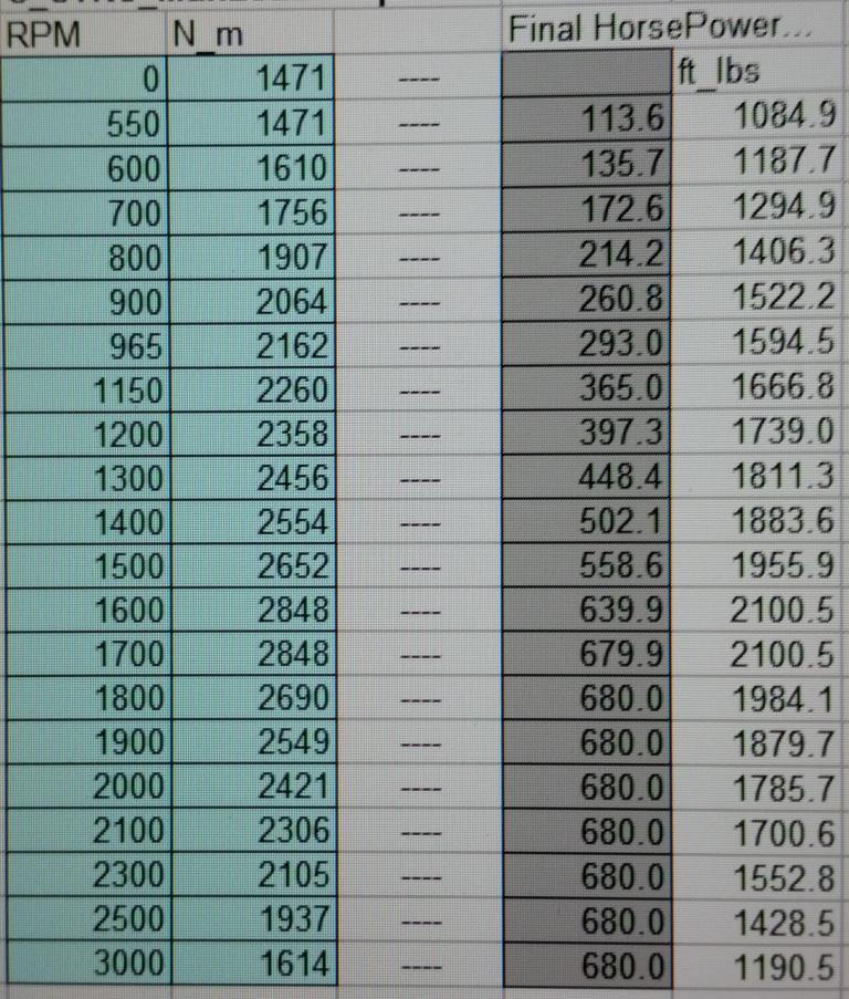

RE: Increasing HorsePower -- What You Need To Know For an MM truck with AV10098 in it,... If you wanted to haul heavy and were geared for it to be in the 1600+ range when pulling hard like you should be,... custom liner height and head torque, etc.. and you could stand for having to do rods and mains at 600k instead of 800k ... Max I would want to custom tune it to would be around 680 HP or so, but limit its torque below 1300 to about 1800 or so, and peak it at 1700 to 2100 ft-lbs of torque. An example would be Something like this perhaps?... ![]() I would also limit the boost to around 36-37 or so and let the EGT's run slightly higher just to protect liners and bottom end etc. a bit too. User's Signature: ->: What I post is just my own thoughts and Opinions! --- I AM Full Of S__T!. | |||

RE: Increasing HorsePower -- What You Need To Know Agreed, running big weighs an engine should not be operated any lower than 1450-1500 rpm. The stress duration is just too long at any rpm lower than that and will dramatically shorten longevity. I believe this is why I have never had liner issues. I refused to bump the power rating to 600/2050 when offered for free from my home KW dealer. I don't pull lower than 1500 as a rule, occasionally when I was preoccupied or busy communicating with pilot cars or something I would go to 1400, but that was the exception, not the norm. The reason my engine was inframed was because of a cracked head that I believe was a manufacturing defect. It wasn't cracked in the usual suspect places, it was cracked on the intake plenum over #2 behind the ECM cooling plate through to the coolant passage. The motor consumed coolant from day 1, and nobody would accept it and do any real investigations for me. Upon taking them to court when I finally had the discovery documentation, I found that the cooling system pressure test procedure was only done for 2hours maximum. No wonder they never found anything, they weren't really looking! You didn't mention the rating of the AV10104 cal, I am assuming this is the 600hp 1850tq file? User's Signature: Why? Why do I always ask "why?" Because I can't learn or help teach others with "'cause I said so..." | |||

RE: Increasing HorsePower -- What You Need To Know (01-22-2017 )Rawze Wrote: For an MM truck with AV10098 in it,... If you wanted to haul heavy and were geared for it to be in the 1600+ range when pulling hard like you should be,... custom liner height and head torque, etc.. and you could stand for having to do rods and mains at 600k instead of 800k ... That's such a beautiful torque and power band that it brought a tear to my eye! User's Signature: Why? Why do I always ask "why?" Because I can't learn or help teach others with "'cause I said so..." | |||
