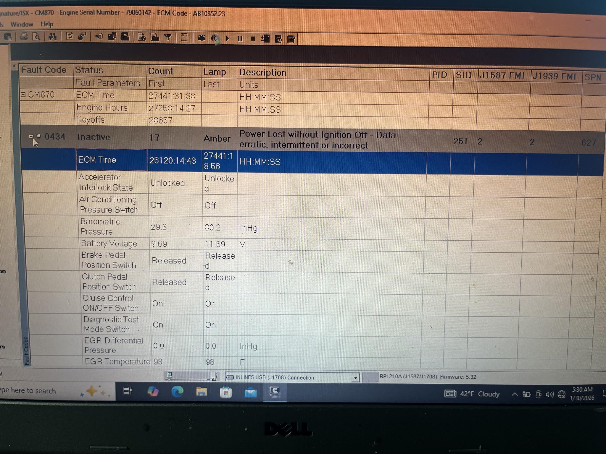

| Cm870 Driving This morning and the engine shut down on me on the interstate. I pulled over the hood saw nothing out the norm. I glanced before it shut down saw my water temperature about 200 which is not normal. I tried started it back and it started and instantly shut down. I plugged in insite and it’s only said engine shutdown without ignition off. Took down my filters and they are clean. Just changed them like 9k miles ago. Help please. | |||

| RE: Cm870 Ecm going bad maybe? https://www.rawze.com/forums/showthread.php?tid=8608 Oil preasure sensor is fine? What oil pressure insite shows you? Maybe low oil pressure shutdown? | |||
| Yesterday, (Subject: Cm870 ) Post: #3 | |||
| RE: Cm870 That’s the code | |||
