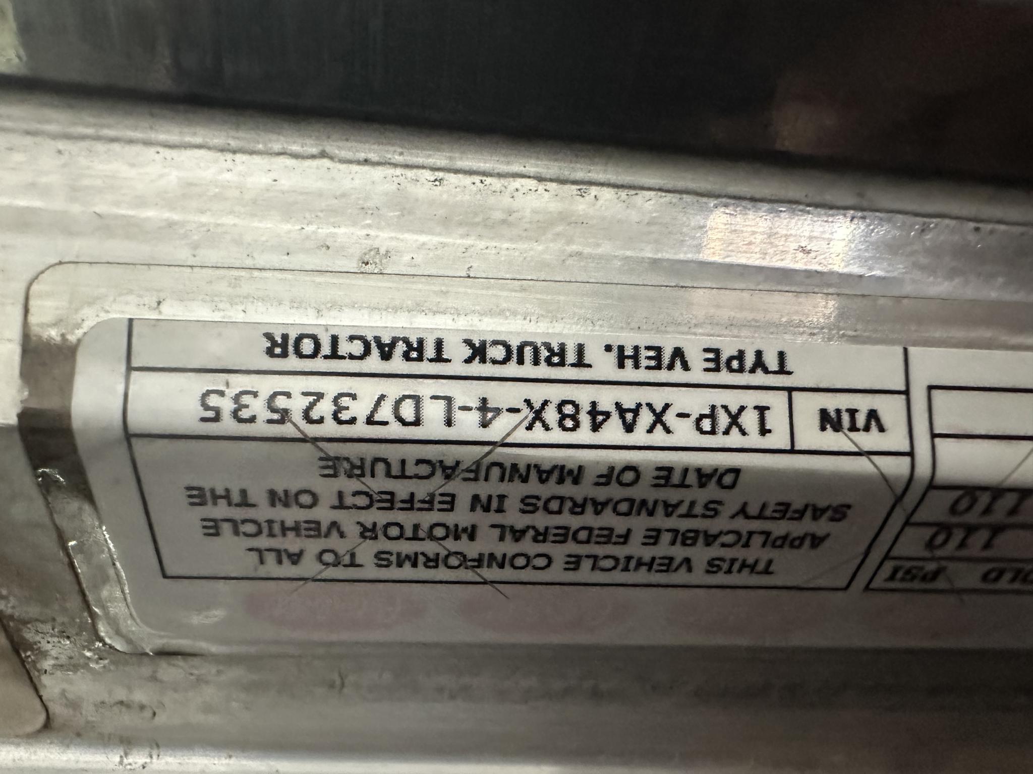

| Hi everyone, I’m hoping to tap into the collective knowledge here. I bought a 2020 Peterbilt 389 with a Cummins X15 at an auction. The truck came without an ECM. 2020 Peterbilt 389 Vin 1XP-XA48X-4-LD732535 Ecm I’m using ESN 80140981 P/N 4384413 S/N 22357078 D/C 01252019 E/C HD10357,00-60000 00000 CM2350 5532 I got a used Cummins ECM from a 2020 International with the same CPL. I had it rewritten using a calibration from a similar year Peterbilt with similar specs. After installation, everything works except the brake pedal signal. The problem: · In Cummins Insite, the brake pedal status is always “depressed.” · In ESA (Electronic Service Analyzer), the brake pedal status changes correctly between “depressed” and “released” when commanded. · The brake lights work normally. · The truck won’t regenerate and is in derate. What I’ve tried so far: 1. Checked the brake valve and brake pedal switch – both are functioning properly. 2. Sent the ECM to Peterbilt to have it bench-updated and rewritten to match my Peterbilt’s VIN and specs. No change. 3. Swapped in another ECM from a known working Peterbilt with the same X15 specs. The problem remains exactly the same. At this point, I’m confident the issue is not the ECM itself, but maybe a mismatch in parameters, wiring, or how the brake signal is being interpreted by the engine ECU. Has anyone else run into a similar situation after an ECM replacement across different chassis (International to Peterbilt)? Could this be a configuration issue in Insite (e.g., brake switch input type, CAN vs hardwired, or something in the vehicle parameters)? Any advice on what to check next would be greatly appreciated. Thanks in advance for any guidance. | |||
