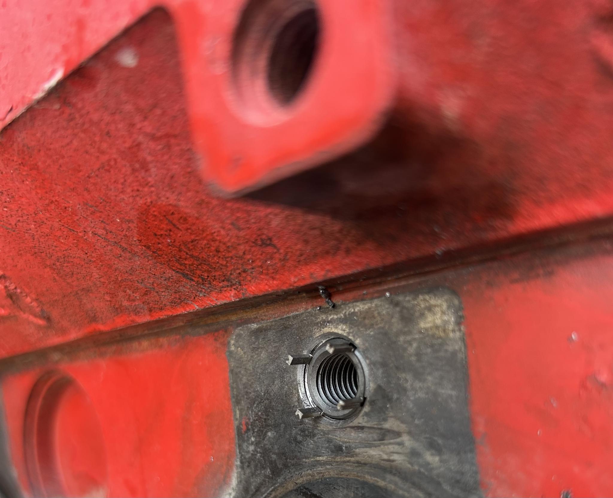

| Exhaust manifold bolt holes stripped I replaced gaskets and bolts on the exhaust manifold a couple of months ago and when I was torquing I the bolts three kept turning. I ended up putting in helicoils. Recently I started to hear a loud exhaust leak and isolated the cylinder from where it was coming from and retorqued the bolts but the lower one just turned endlessly which has a helicoil. I’m thinking of drilling it out to the next size up and using timesert’s on all bolt holes so I don’t have to deal with this again. Will be ordering a new manifold,and gaskets. Will drilling it out to the next si.•ze up and putting in timeserts work ? Also is there a drill guide or something to get a perfectly straight hole ? | |||

| RE: Exhaust manifold bolt holes stripped If I had to guess it was definitely a bad install due to the way I installed them and you’re going to blow a gasket with what I did lol. The stripped original threads happened when I did the retorque after a week of the install and all the bolts did was turn so I didn’t want to take everything apart and just tapped right through the manifold (critical mistake). The manifold is an oem 870 manifold and the bolts gaskets and spacers were {non-oem}. Helicoil size is M10x1.5. As far as drill depth I wouldn’t be able to tell you right now because u don’t have it apart yet but will in a week from now. My plan is to use a Big Sert 5015 kit that will keep the M10x1.5 size. | |||
