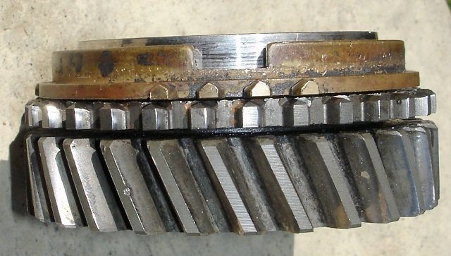

So what is your take on some gl-5 rated gear oils that have additives that have negative affects on yellow metals? Is there validity to this,should I be concerned which gear lube specifically to add to an engine? Please shine more light on this.

(03-15-2016 )dodges1515 Wrote:  So what is your take on some gl-5 rated gear oils that have additives that have negative affects on yellow metals? Is there validity to this,should I be concerned which gear lube specifically to add to an engine? Please shine more light on this.
You have a very good point, and I was concerned about the same thing a long time ago when I first looked into alternatives. i found pictures like these..
./uploads/201603/post_2_1458048495_feb783ed8656199580a6321042d8dfa5.jpg
I read the same thing a long time ago, but have since found these things to contradict this..
* that picture was of a component that was already very, very old.
* The engine oil itself has those missing protections.
* The maximum of about a 12% mixture (1 gallon) to the normal engine oil is not likely to cause these types of problems even it it were the older GL-5 (no longer made).
* The newer GL-5 oils have been modified to significantly reduce this.
* Also, you can see above that I recommend the sta-lube GL-4, but that the cheaper GL-5 oils will work better than having nothing at all in a worn out engine to help reduce play and internal vibration in the engine components.
- At a maximum or 12% mixture (1 gallon) to the normal engine oil, I would think there would be little or no concern even if someone did use a gallon if the the cheapest modern GL-5 for say, 500k miles. I shall soon find out as I am about to inframe my own engine that now has more then 950k miles on it and I will have a chance to take a good look inside at all the brass/copper exposed components like the rods (brass wrist pin bearings) and other bearings that are likely showing copper by now for corrosion on edges and surfaces. I have actually been using the cheapest 85/140 wal-mart GL-5 to test this as a "worse case scenario" this last couple months. I am doing this just to see the effects when I pull the engine apart.
