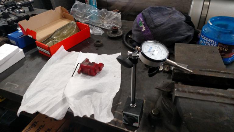

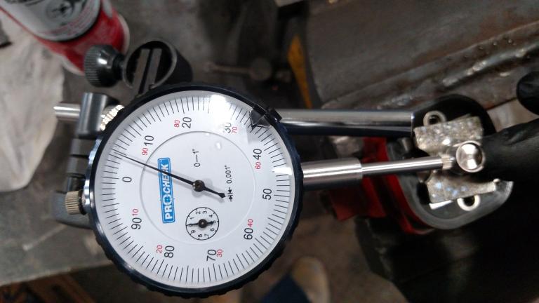

My back timing actuators was leaking I guess bad gasket, but either way I pulled it off and measured the shaft side play. It was 9 thou' of an inch. So I decided to buy a recon one for 430$ at cummins in Orlando, FL. I measured it too, and it shown 5 thou' of an inch. I decided to ask where the dealer took the recon parts, and they gave me the number for Associated Fuel in Georgia. I called them, they said they do not recon actuators because nobody sells parts for it so they can't help me any further on this question.
If someone else has the same experience please share, I wish ask what your side play threshold was on new or recon parts. Thanks!

(10-28-2016 )Sergiu Wrote:  My back timing actuators was leaking I guess bad gasket, but either way I pulled it off and measured the shaft side play. It was 9 thou' of an inch. So I decided to buy a recon one for 430$ at cummins in Orlando, FL. I measured it too, and it shown 5 thou' of an inch. I decided to ask where the dealer took the recon parts, and they gave me the number for Associated Fuel in Georgia. I called them, they said they do not recon actuators because nobody sells parts for it so they can't help me any further on this question.
picture sharing
Yes, many of the recon actuators have more side-play than new ones. It seems to be ok, because there is no step in the plunger from excess wear. I am thinking they are polishing the old ones down/removing the step in them if they aren't too bad.

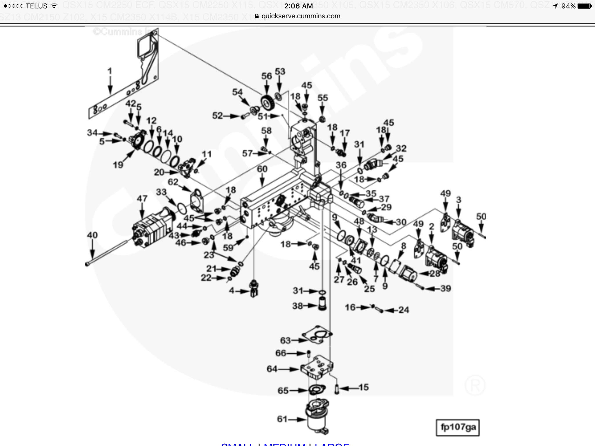

So on top of checking the fueling and metering actuators and the injector test, is there any other beneficial steps to take? I seem to remember unilevers saying you can clean other parts fuel system related but be damned if I can find that post now.....
03-06-2017, (Subject: Checking your Metering and Fueling Actuators by Rawze... )
RE: Checking your Metering and Fueling Actuators by Rawze...
The two pressure regulators, can't remember the exact numbers but I think it's a 260 & 380 psi regulator, as well as the oriface for the timing relief I think.
I'll try and find it for you...
Post number 7 of this thread http://rawze.com/forums/showthread.php?t...3#pid12033
The pressure regulators are #'s 25 & 37. The oriface is under plug #59 I believe. He told me he uses a mirror & a pick for the oriface.
Quickserve->Parts->Fuel System->Delivery System->Fuel Pump drawing # fp107ga
In service, under the IFSM drawing # 05c00201 shows it much less cluttered, but not numbered for a better reference.
