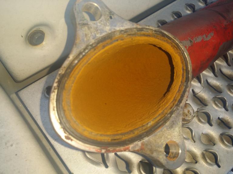

I took the venturi pipe off and it's got this brownish color instead of the normal black soot.

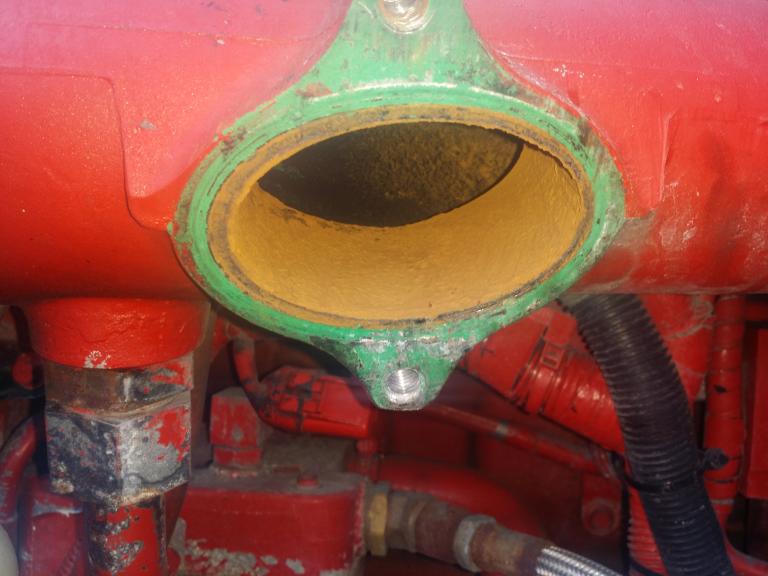

RE: What could this be. Pictures inside
./uploads/201603/post_824_1456841912_3d9c2571dc2fe15fb2f871803a4dbdd9.jpg
I'm assuming coolant.
03-01-2016, (Subject: What could this be. Pictures inside )
Is it also showing up behind the erg cooler?
Not that I can see
It's the combination of anti freeze and nox gasses it's caused by a leaking egr cooler I would replace it immediately and clean the egr valve
Yea I figured. Can that also pressurize my coolant overflow bottle.it's been doing that on hard pulls . That's y I checked the venturi pipe.
Yes if coolant can come out then exhaust preasure can get back into cooling system.
