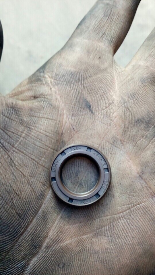

I have 4309076RX Cummins ISX Turbo.... I want buy seal in this turbo but i dont know part mumber. anyone know please just help me. Thank you very much.

They (Cummins,dealers and Holset ) don't sell this part or any parts for their turbos !!!
I've learn this after calling all of them including Holset headquarters.
Your best bet is specialized store. Or search internet for kits including seals along with bearings .
But please read the next and be warned !
I guess this is the actuator shaft seal ? ... and I think the bushing is gone (badly worn) . Shaft probably is worn too .
Put shaft back in , and see if have much radial play . If this is the case new seal is not gonna prevent oil leak cause is not designed to work with more than minimal shaft radial play. Roughly 0,2 mm (0,0078-0,008 in), no more !
And this is BS , not to sell parts for their turbos !
But I guess they have a very good reason to do that!!!

(11-25-2016 )Wiseman Wrote:  They (Cummins,dealers and Holset ) don't sell this part or any parts for their turbos !!!
Just a guess here .. They probably don't sell parts because they don't want the liability claims against them if your turbo goes into runaway and causes a truck accident or your engine to blow up.
Personally, if my turbo needed new parts,.. I would simply reaplce the turbo. I am not out here to save a few bucks re-building something that can destroy my engine as it gets worn out, putting me at the end of a tow hook, and costing me 20x more than if i had just replaced it to begin with.

if anyone knows which replacement parts sold elsewhere, let me know.If replacing the turbo is very expensive.... :((
11-25-2016, (Subject: Hello all member. I need help about Cummins ISX Turbo )
RE: Hello all member. I need help about Cummins ISX Turbo
Call around to turbo rebuild shops. I know of 2 real close to me so finding one is not hard.
