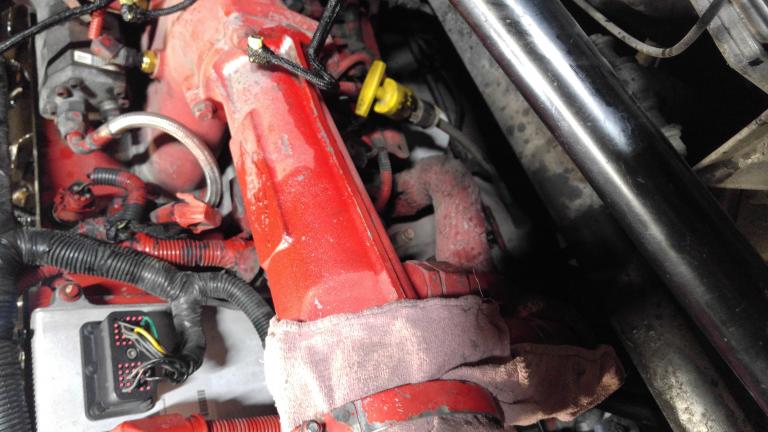

As a volvo driver get a less restrictive intake manifold and pm gearhead or Unilevers in regard to getting your engine running optimal as possible.
./uploads/201611/post_1639_1480373082_8c3b8e62981fe849c64d85d60d62408e.jpg
