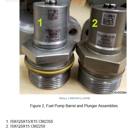

Also barrels and plungers for 2250 and 2350 have different part number and they cannot be mixed. Installing incorrect barrels and plungers will result excess fuel in the oil
./uploads/201704/post_608_1493088831_a86d1aaf8acc4e12e991ce12c4215454.jpg
They have different part numbers:
For CM2250 Fuel Pump Barrel and Plunger Repair Kit, Part Number 4327258;
Retainer, Spring 2872626
Seal, O-Ring 3867651
Barrel and Plunger 4307402
Spring, Compression 4928605
Washer, Sealing 4954944
For CM2350 Fuel Pump Barrel and Plunger Repair Kit , Part Number
5406130;
Seal, O-Ring 3330538
Barrel and Plunger 2897343
