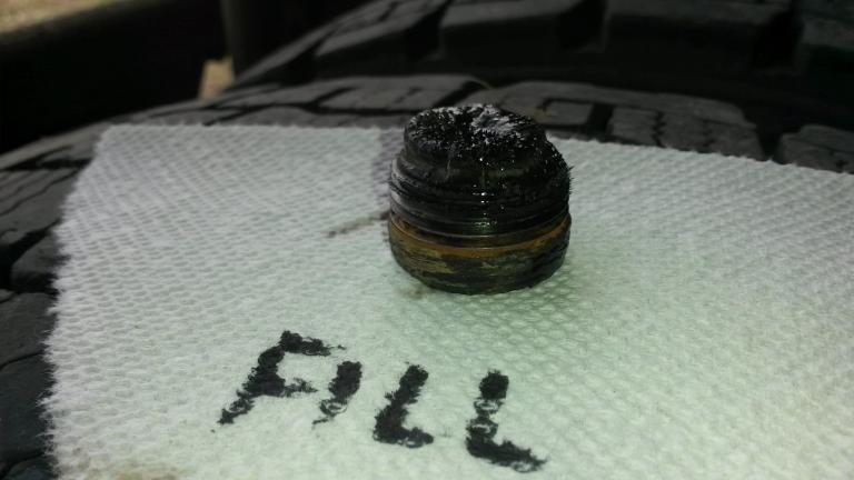

These pictures kinda fit this thread. They are of my rear diff plugs when I changed oil back in April.
This is the fill plug.
./uploads/201612/post_1327_1481434754_43e6cabbd9dfbaec780496abeeeb855d.jpg

Oil was changed right around the 800000 km mark as per OEM recommendations. There was no real hard filings on the plugs I could feel, just a metallic fuzz. The front diff plugs were similar but maybe 25% less fuzz. I don't think I'll be letting it go that far again.
