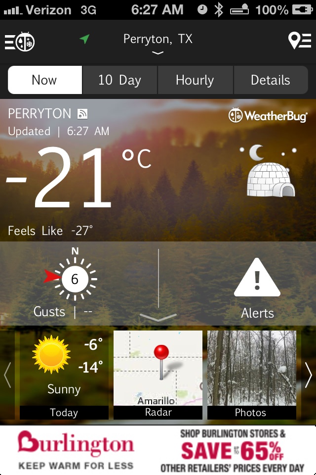

(12-18-2016 )hhow55 Wrote:  https://ryder.com/winterdriving
./uploads/201612/post_2077_1482071675_462a25b8ec3f2735a1e8a9582545ff9d.jpg
thats 6 below Fahrenheit btw
Was talking to a buddy this morning. He's in Whitehorse heading for Inuvik. It was only -4C/25F up there...mother nature hates me!
