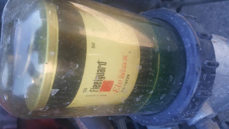

(12-29-2016 )Brock Wrote:  Interesting. I've been wondering about my davco lately, I see a lot more constant uair bubbles in the housing than I think I should. I know some is normal but I'm gonna check it out.
Mine had little tiny bubbles all around it. The davco filter base looked to be brandnew so I never thought it could be bad. All the fuel lines on truck are new to,along with fuel pump. Makes me wonder if they were chasing same problem

RE: Injectors
Here is a pic

50 micorn filter in that thing is an insult.
Change it to a 10.

(12-29-2016 )race7820000 Wrote:  Here is a pic
That's the housing I was referring too , I lost my own no4 injector twice because it the fuel pump was drawing air through the filter housing. Cavitation in the injector ended causing it too leak and caused a knock. Put two new injectors in no 4 over a 7 month period before finding it .

I am not a big fan of those davcos to many problems with air and cavitation.

(01-02-2017 )gearhead Wrote:  I am not a big fan of those davcos to many problems with air and cavitation.
Personally, I don't think it is so much the davco, but more like abuse from oil change places that do not take the time to care about what they do. Mine was damaged by speedco, and then a TA,.. then that was it for me!. -- Ever since, I have always changed my own filter in it,.. and a million miles later, it still works great in keeping water out of my fuel, and filtering out buildup to less than 10 microns.
I would MUCH rather have one than not.
