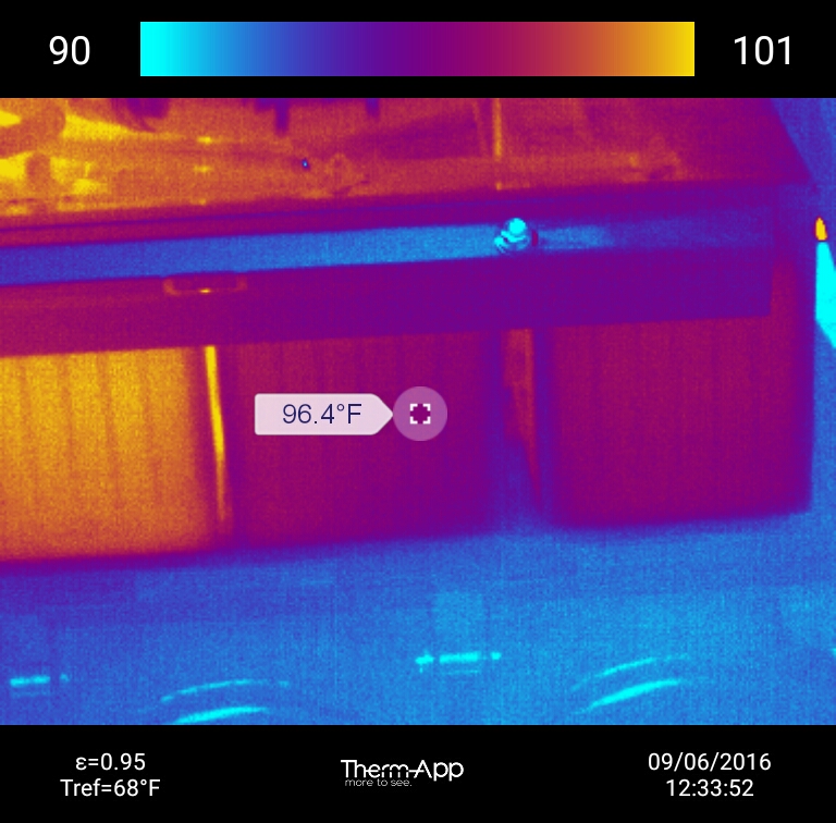

Weak plate in battery (second cell from the left shows a hot spot inside it) ...

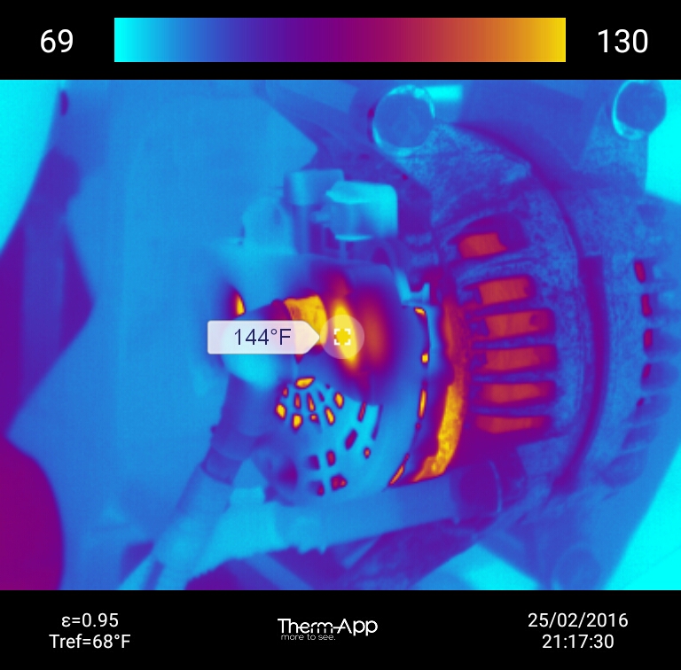

Alternator with diode pack going bad but not completely failed yet. Was putting slight A/C ripple into batteries, weakening them. This also causes the batteries to drain slowly when truck is shut off.

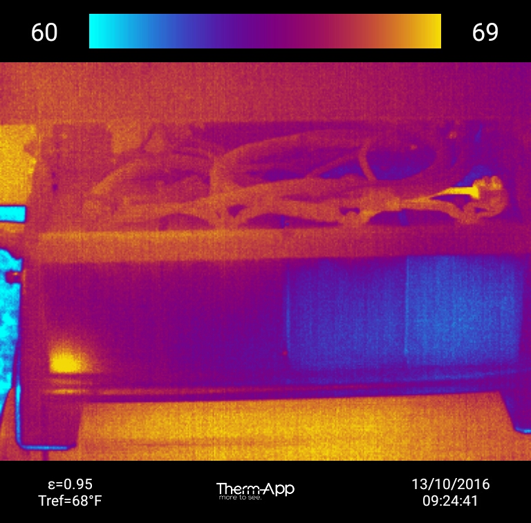

Mis-matched cell (far left cell is hotter than the rest).

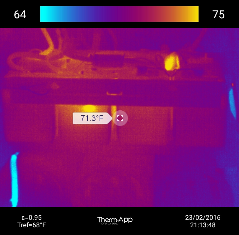

The mounting bar was over-tightened on one side a bit and it weakened the bottom left of corner of a cell due to excess mechanical stress. The battery got weaker and weaker over time even after the bar was corrected. -- Yet another reason why a torque wrench is your friend.
