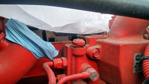

I busted this removing the EGR tube, quickserve is sucking a$$ in trying to ID this. ./uploads/201702/post_2459_1486077205_a351a77e08b4dbcdadcbc4f8b431c694.jpg

exhaust gas pressure sensor!
the fact that its still red isnt good, good thing you broke it!

I'm just messing this up to no end. I forgot to align the fan clutch holes before I tore everything else apart... I guess I'll do that last.
Thanks for the nomenclature, I never would have guessed it being stuck on the the thermostat housing.

And oh yeah, don't worry about breaking that sensor off. You were gonna change it anyway, now it's much easier to remove...lmao
hint; 1-1/16" six point socket

(02-02-2017 )fargonaz Wrote:  I busted this removing the EGR tube, quickserve is sucking a$$ in trying to ID this.
http://rawze.com/forums/showthread.php?t...40#pid1340

I'm east of Phoenix. I was able to get a 27mm on it. It was only 110 at my super friendly freightshaker dealer; at least I don't have to pay his labor.
