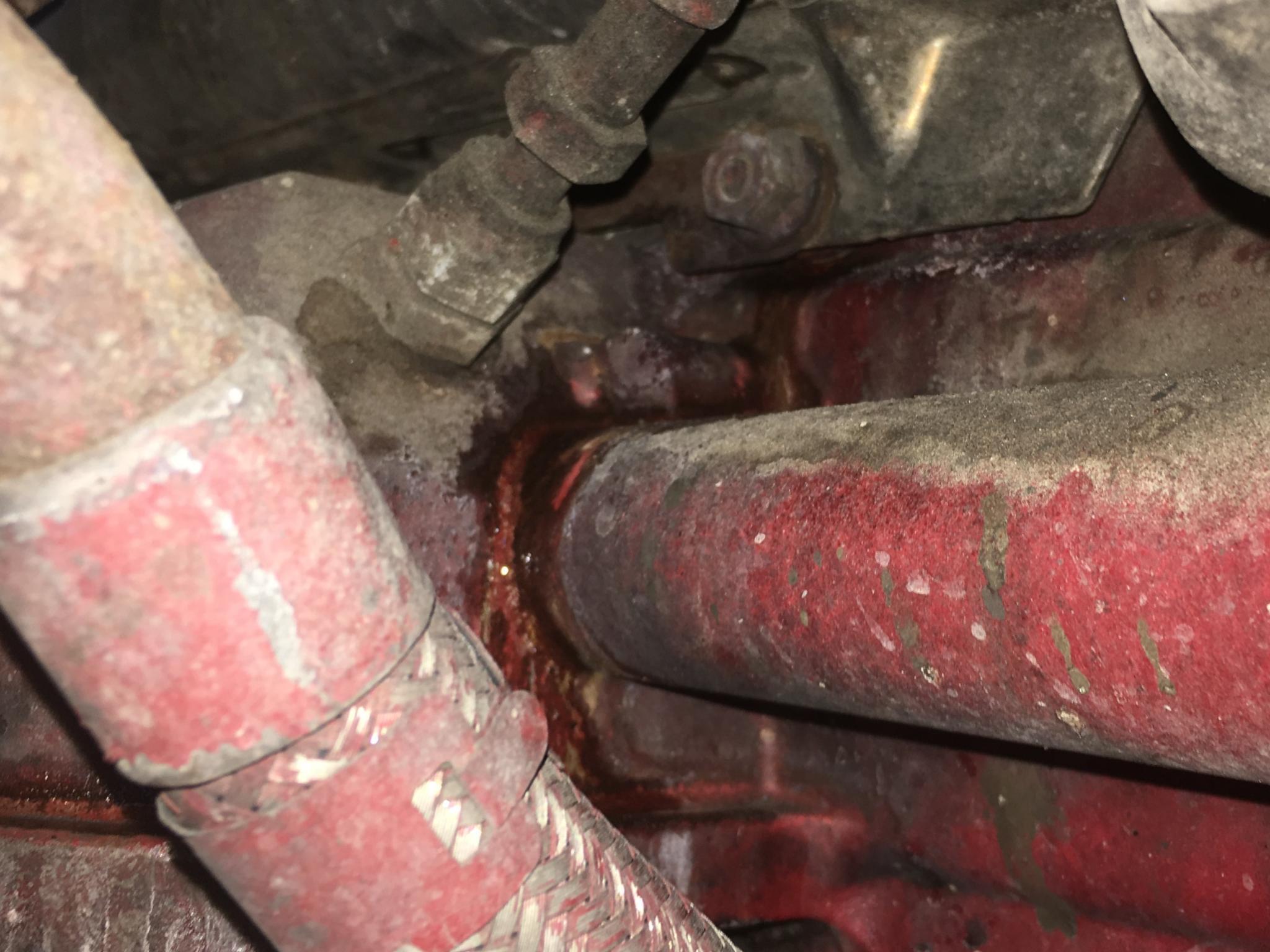

| Ok so during my prettily this morning I notice a small puddle of coolant at the rear of my engine. I traced its path back along the block to the egr cooler. Its leaking my from behind the egr cooler and running down right behind one oft he egr coolervmounting bolts which resides just in front of the oil filter. Is it possible to have a leak externally or do I need to do more searching? Also can I put my modified zero pressure cap on to finish this morning nth off to get home? | |||

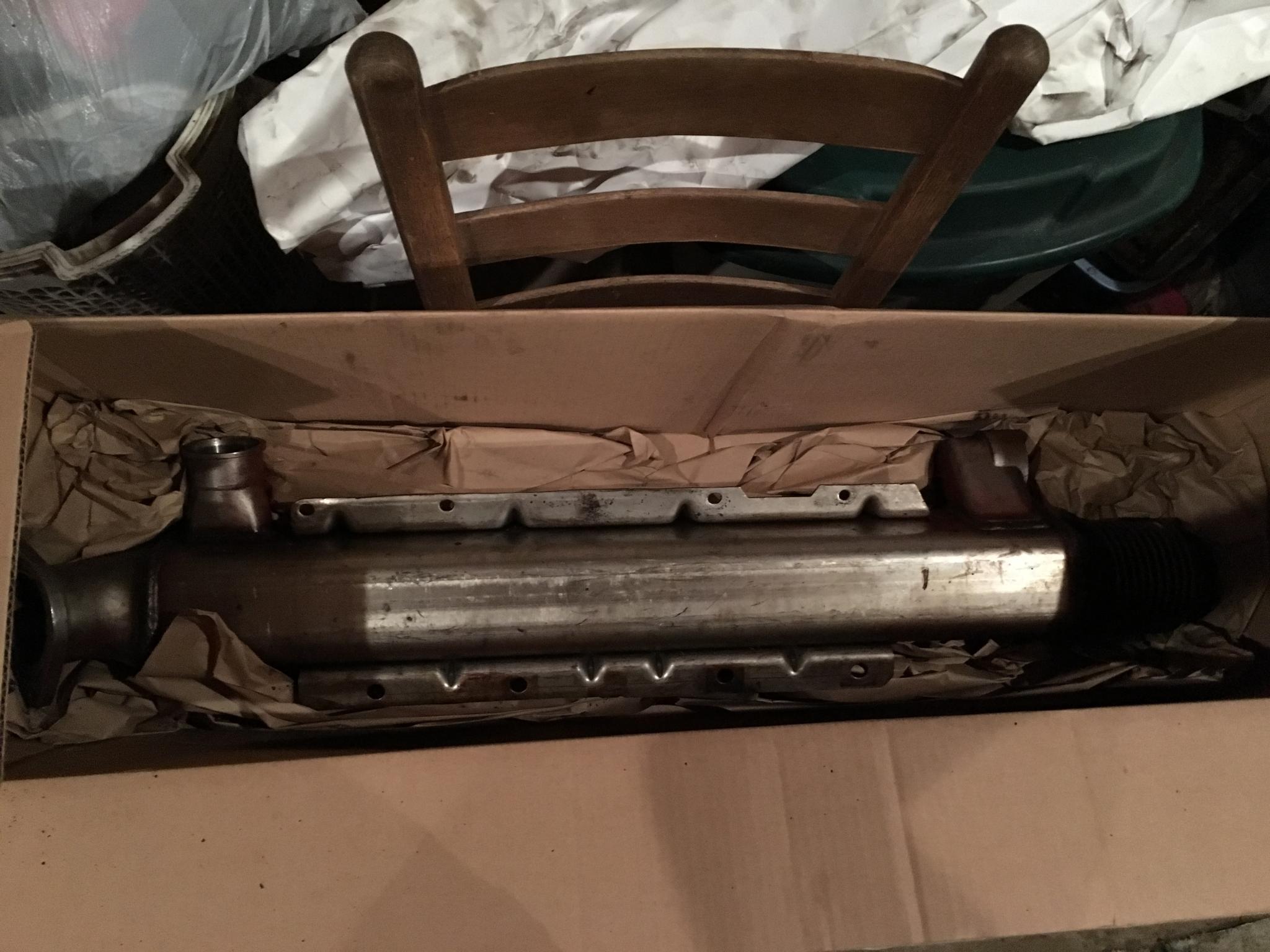

| RE: Egr cooler leaking externally? Thanks Rawze. Got one being shipped to my house. Going to take it in to my local weld shop and have it modified. Running without any pressure in the radiator has slowed it down considerably. I'll never understand why these things break right after you leave from home time. Had it did this right before I went home I'd have yanked it off right away. But no, it waits till I'm 3000 miles away lol. Damn you Murphy. | |||

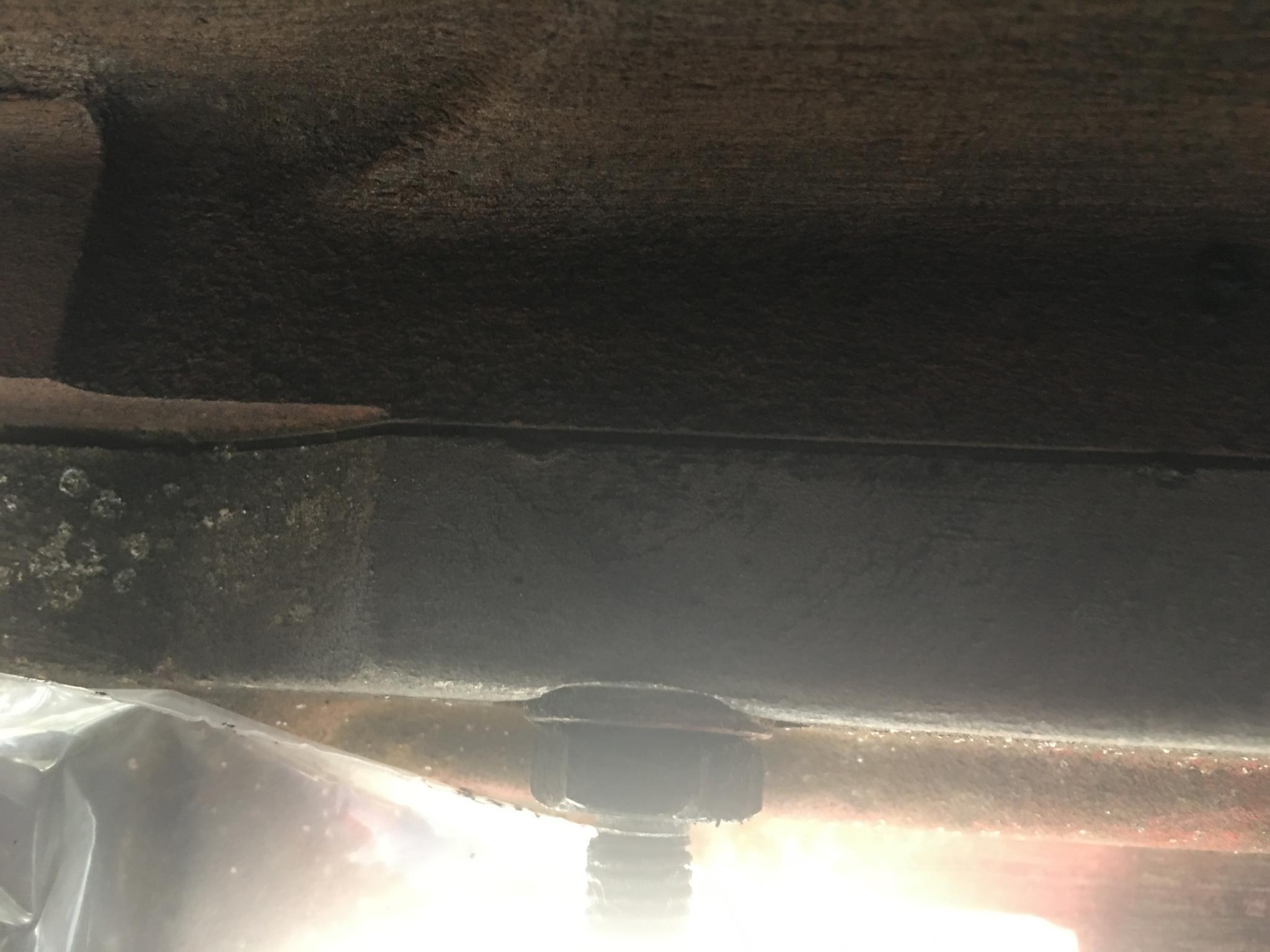

| RE: Egr cooler leaking externally? After brushing the built up dirt off of the mating surfaces I found what appears to be a nick in the casting. I found it from following the coolant stain in the aluminum. You can see them in the picture, they look like water rings lol. I'm 100% sure the oil cooler has never been disassembled so this is either a factory imperfection or the coolant cut a groove in the housing. I'm leaning towards a factory flaw though. Will post more once I get the cooler off. I have found a NOS on eBay for $150 to replace it if it's damaged beyond repair. If it can be fixed I'll fix it. I know a guy that owns a machine shop who can do it but it'll be a matter of cost. Might be cheaper to replace it than fix it. | |||
