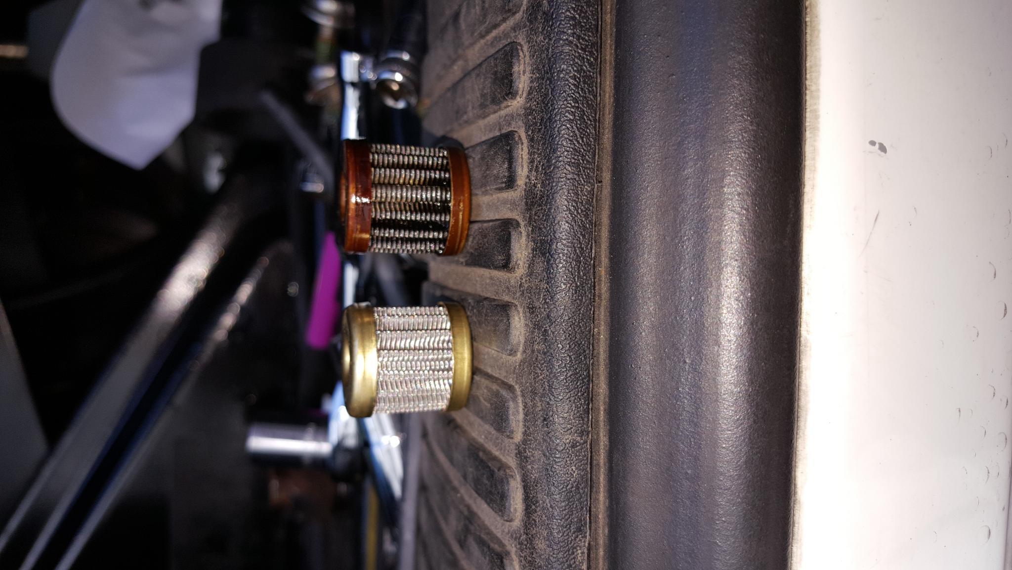

I changed the manifold pressure sensor and no diffrence. I remembered there is a small brass screen filter in the top of the fuel pump, i took it out and it was pretty black so im gonna see if i can get a new one tomorrow along with some new fuel line

Well i think i fixed my power problem. Changed the little filter on top of the fuel pump and changed the suction line and my truck pulls again! Thanks everyone for all the advice!
