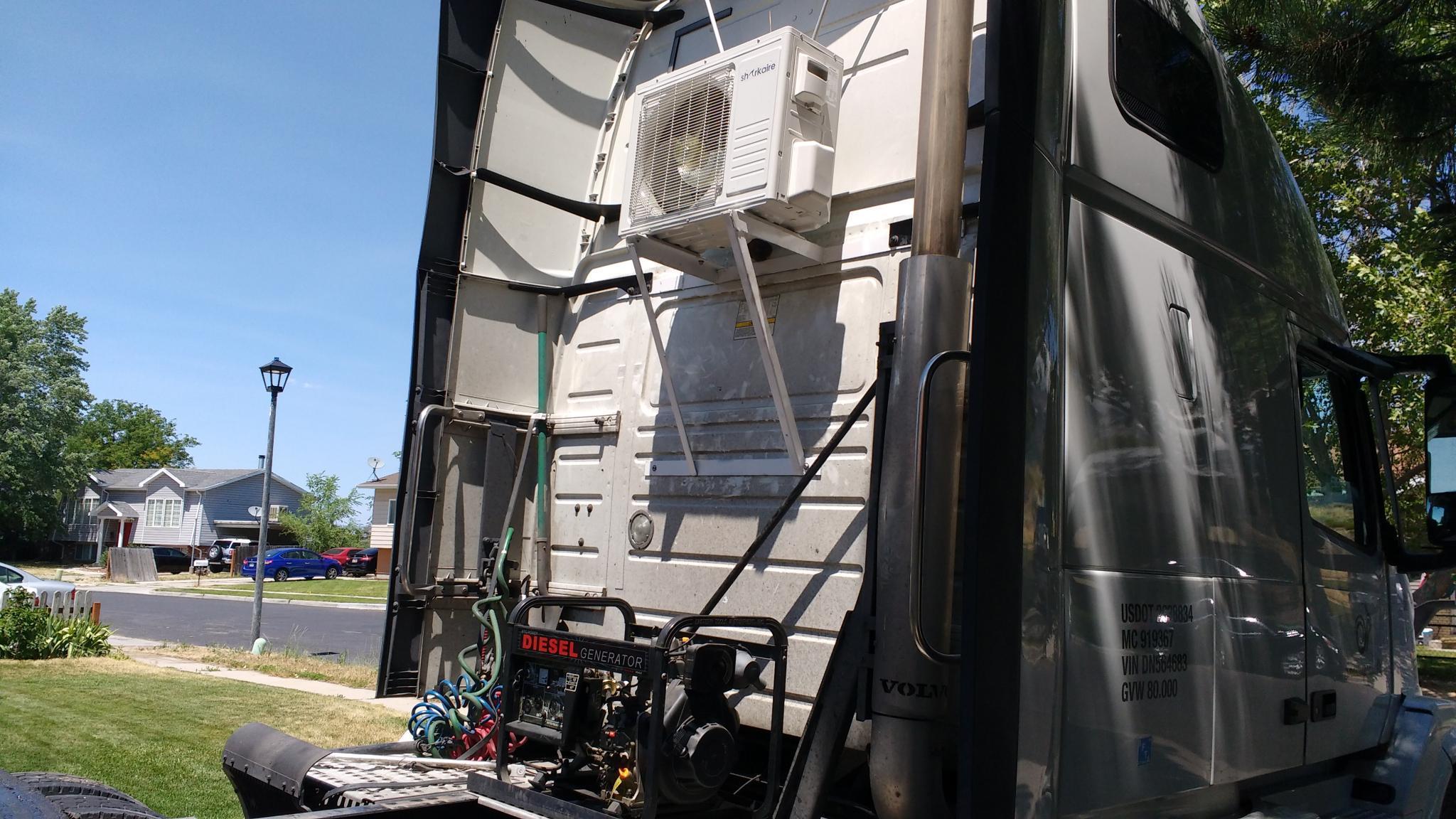

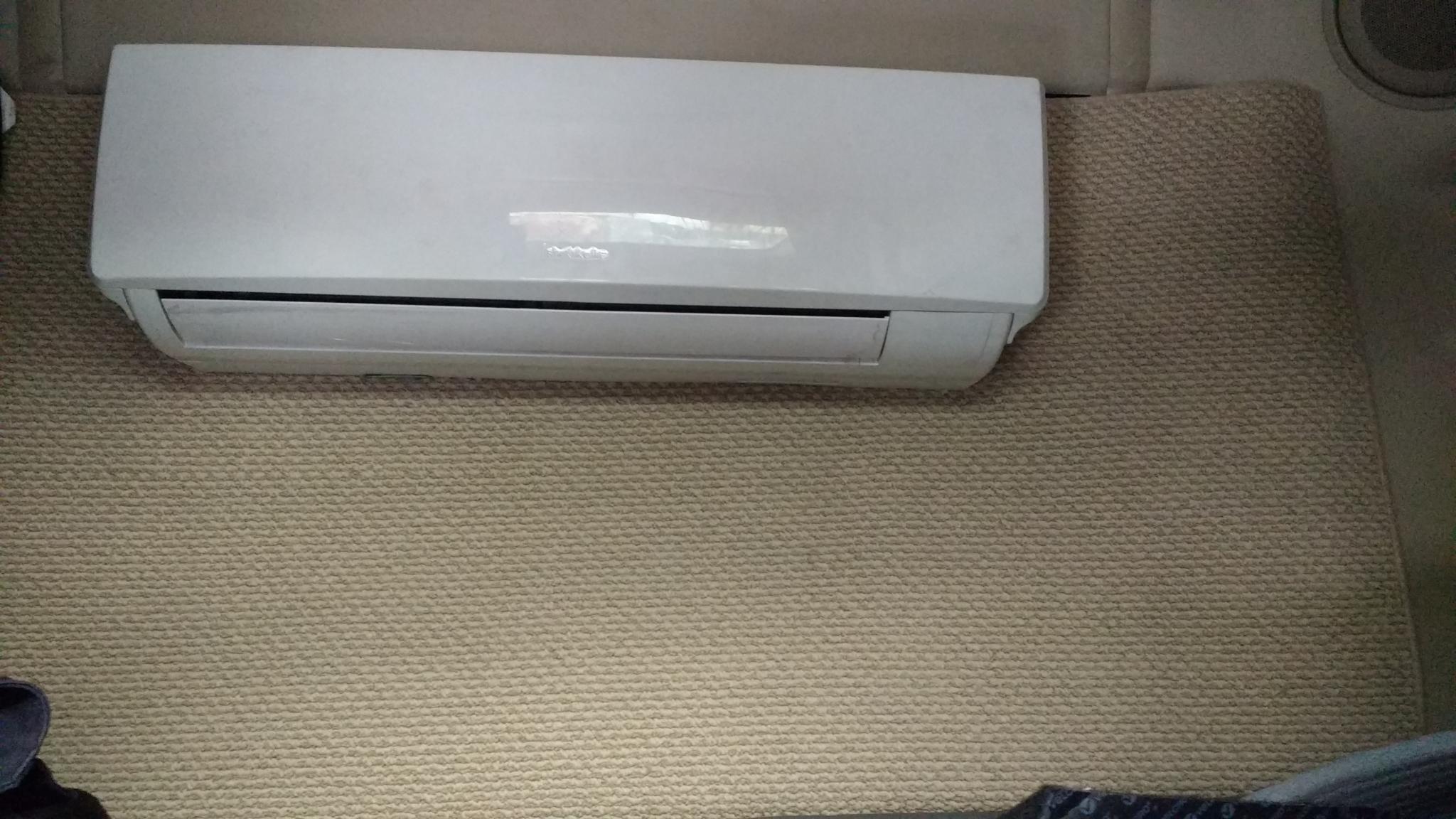

Here is my home brew setup.
Split system AC.
Powerful and quiet.
No weigh moving forth and back every stop.
No openings cutting.
All space inside sleeper still available.
Generator has fuel from truck fuel tank, remote start.
 Thanks given by: Rawze , Waterloo , flying240 , simon999 , barf , Toolguy
