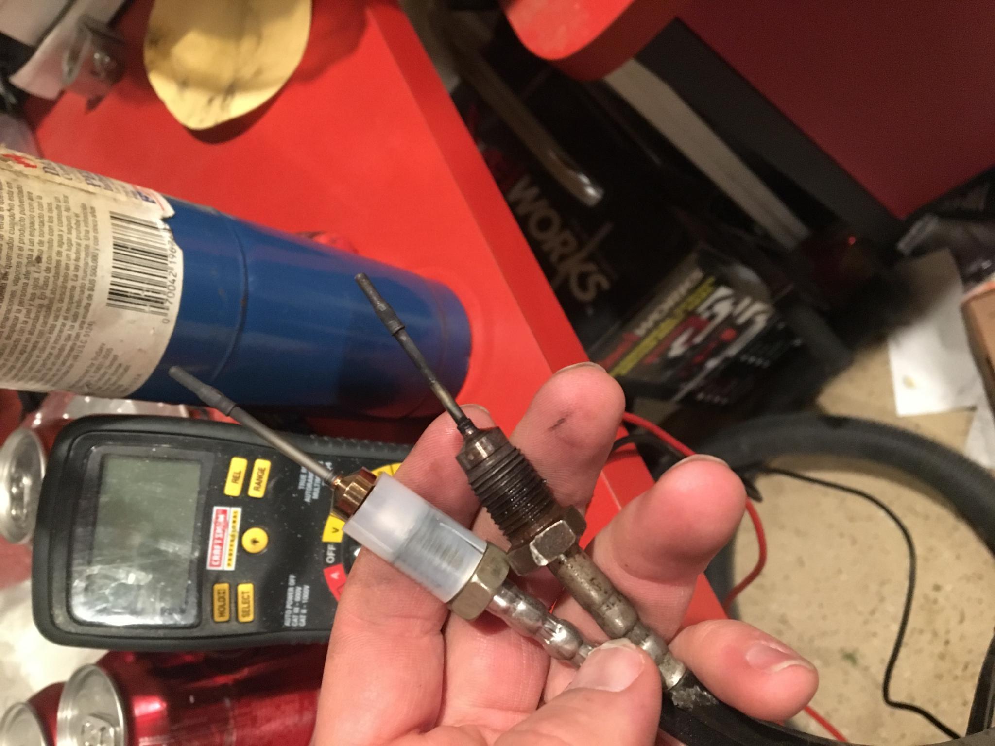

I pulled out two of the sensors and also measured the new sensor I bought.
They both read about 300k ohms at room temp and if I them just about glowing hot they read about 250 ohms.
They all react about the same way, but the #1 sensor was a but coated with soot... and was slower reaction time until I cleaned it.
Could that cause the issue with the check engine light?
Should I just replace the sensor and not try the cleaned one?

I pulled the front and rear sensors, with the front sensor being a bit sooty.
I will swap the two to begin with and see if the fault follows the sensor or not.

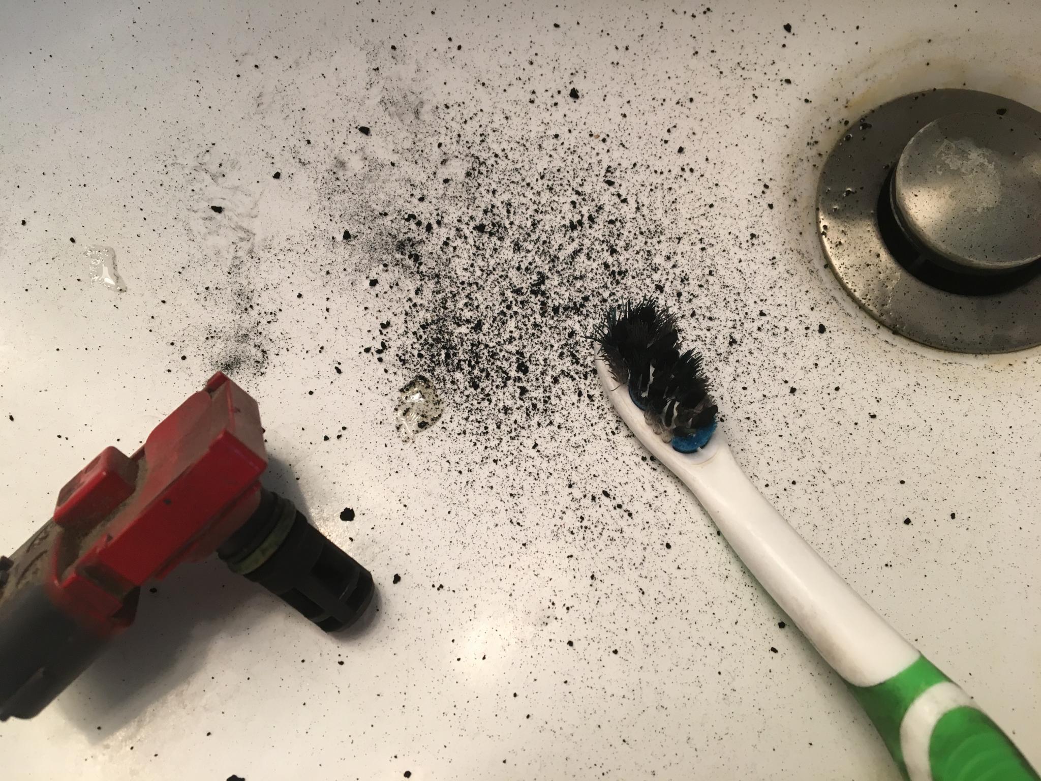

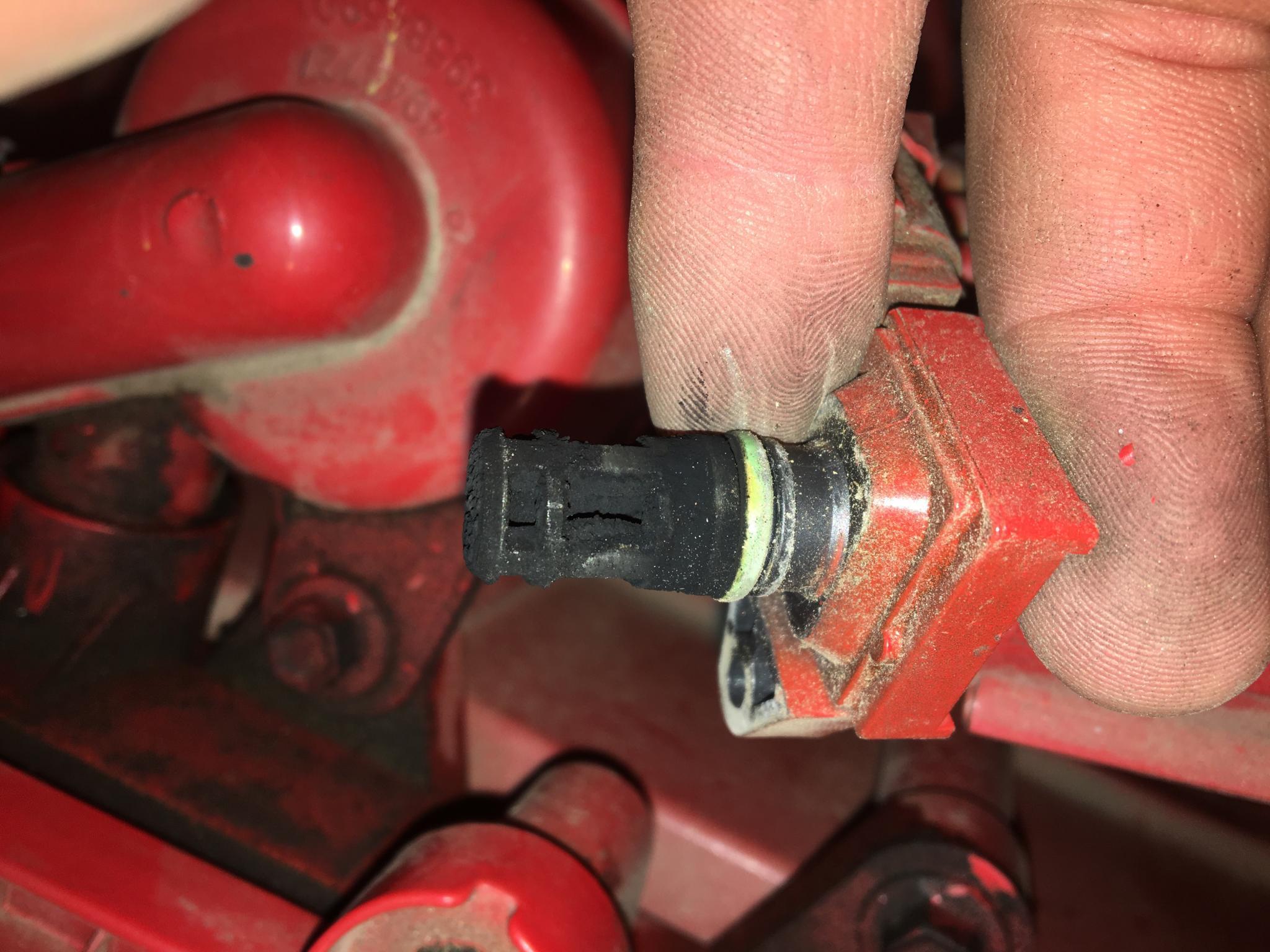

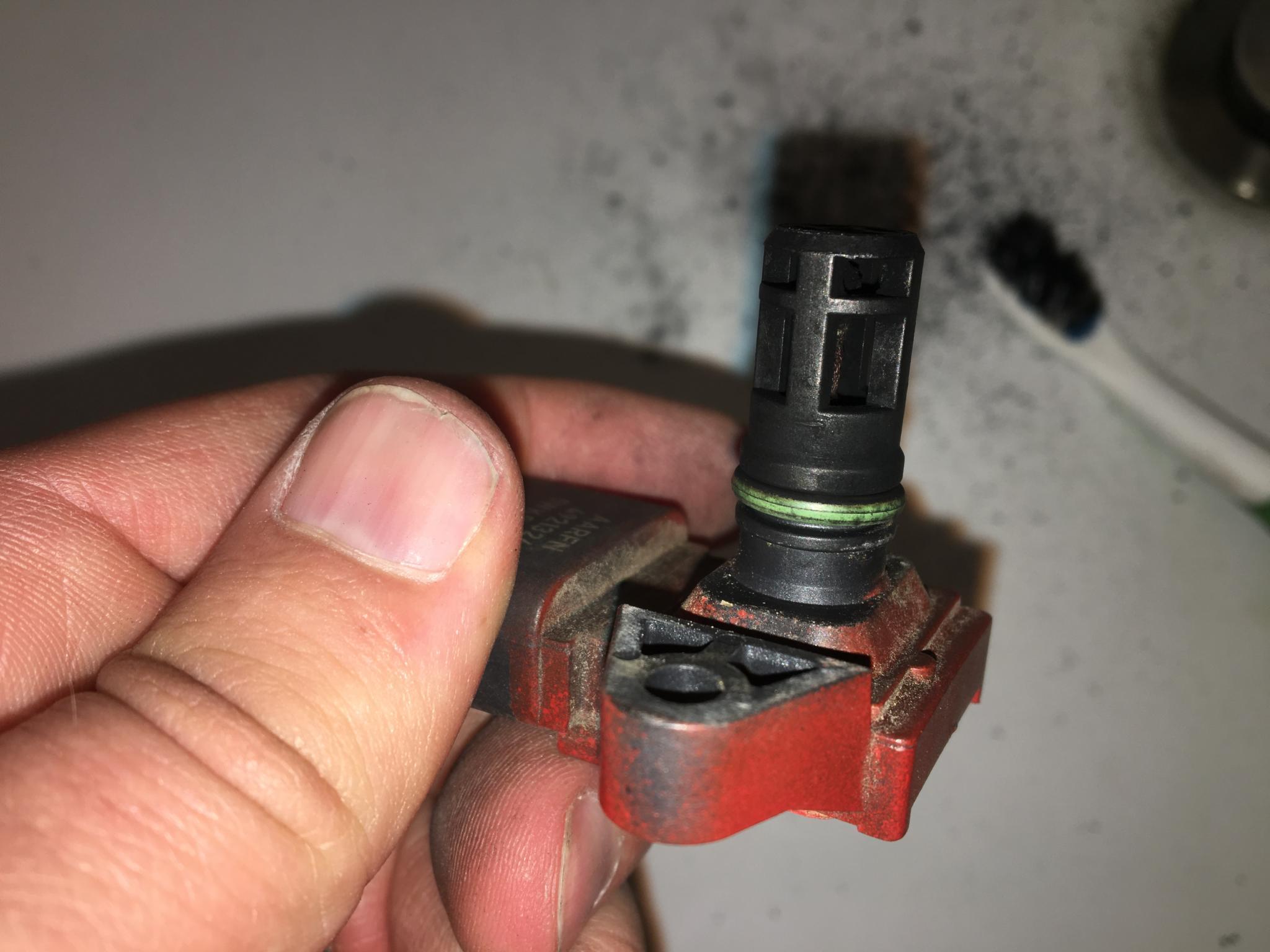

I took out my IMAP sensor to clean today...
03-25-2017, (Subject: Cummins ISC issues )
RE: Cummins ISC issues
Used a dry toothbrush.
It was not plugged, but did have some build up.
I also will be replacing the crankcase breather, as it is all dark/oily and heavy.
Any other things I should be watching for?
